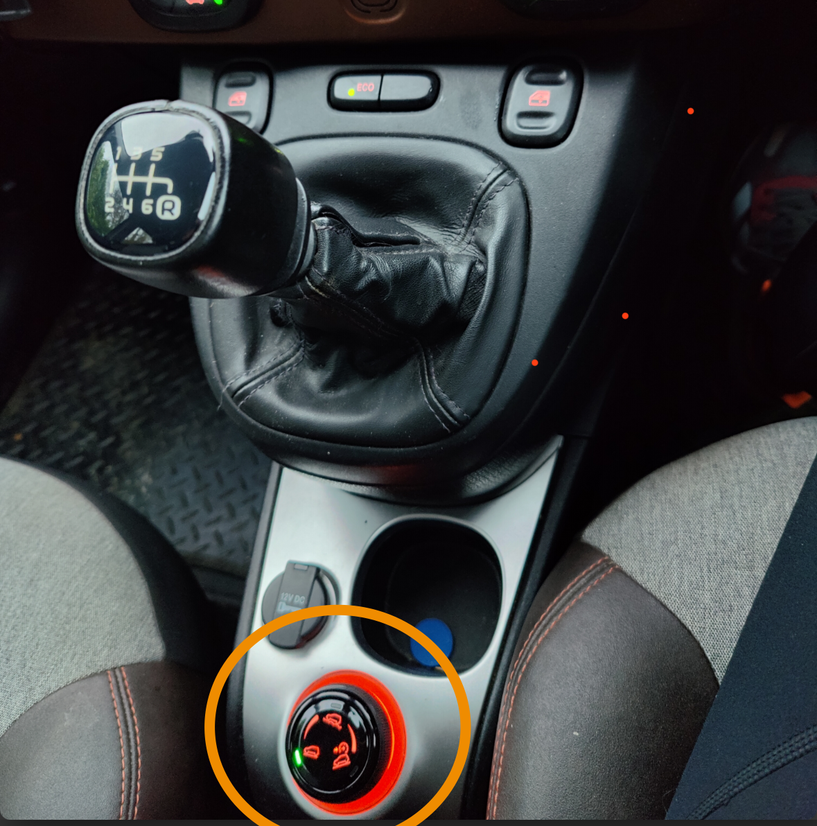

- I don't actually think that I have and ELD switch. Am I right in saying that it's an optional extra which is normally found next to the "Eco button?" I've attached a photo of my switches for reference.
Ah ha - your photo shows that you have a Panda Cross with 4x4… in which case you don’t have an ELD button (which is only found on the ‘regular’ 4x4 Panda), but instead have the rotary control by the gear lever (circled in photo), which provides the same options, plus the added hill descent control.
As set in the photo it is in ‘auto’ mode and so will engage 4 wheel drive by itself if it needs to. . The next setting round (off road) does exactly the same as the ‘ELD’ button on the non-Cross version (ie, forces 4x4 and allows the ‘diff lock’ function to work if it needs to). This setting should not be selected on tarmac. The final position turns on the Hill Descent Control to help with very steep downward slippery slopes (not available on the non-Cross versions).
So, if usually in the position in the photo, you shouldn’t experience ’wind up’… unless the solenoid that engages 4x4 is faulty in some way.
