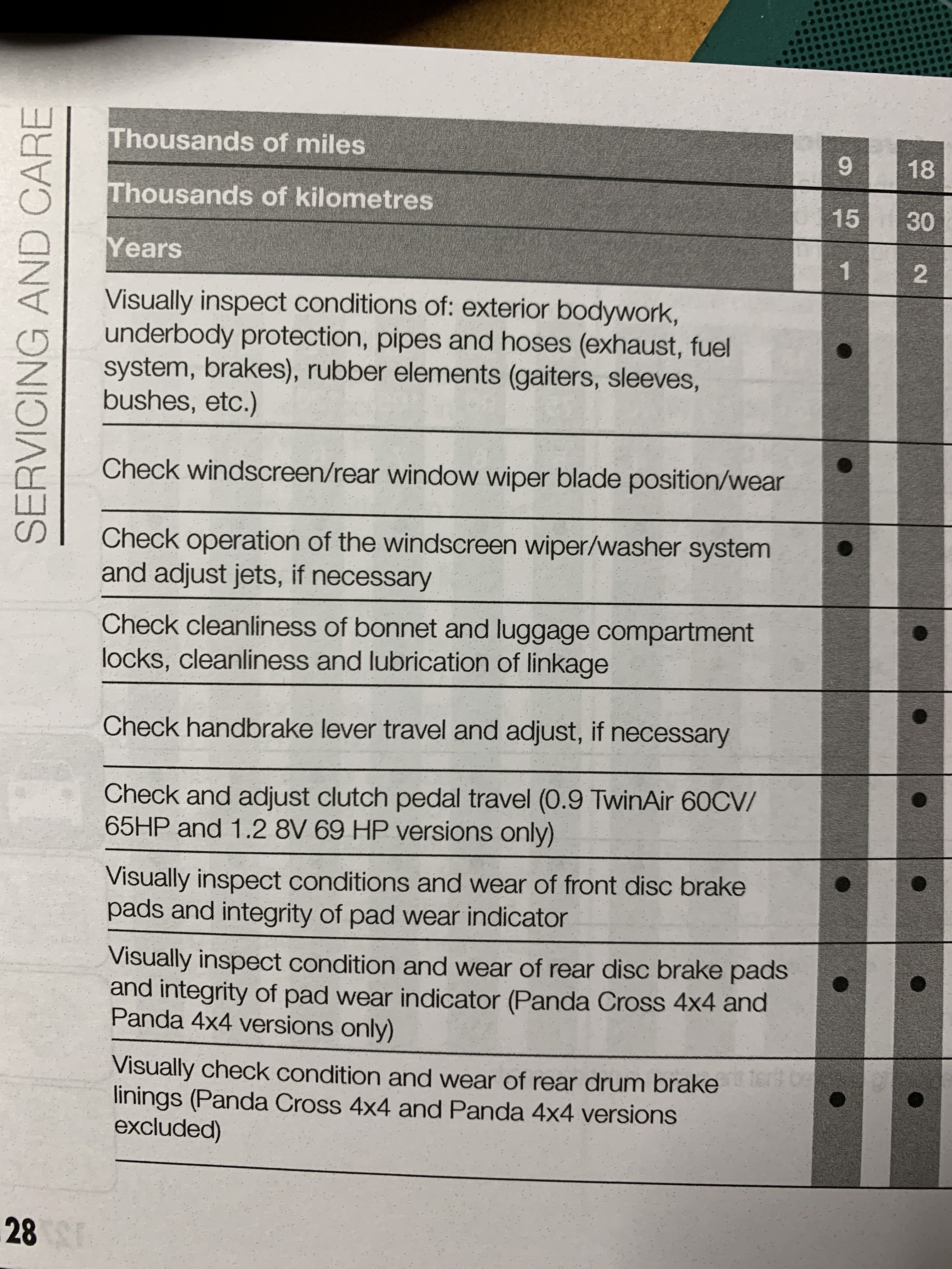

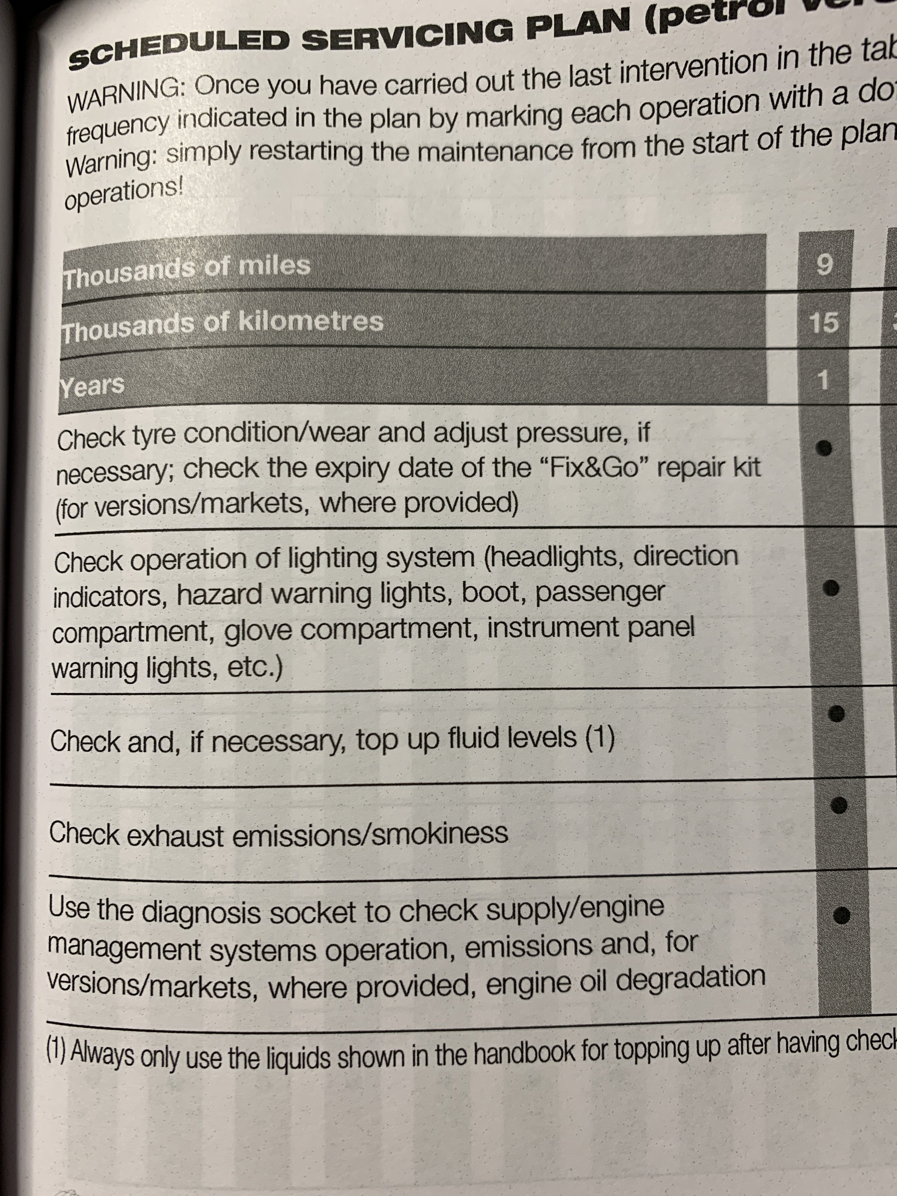

Don’t expect much from the first ‘service’. The 9,000 mile ‘check and inspect’ involves no parts, or anything being unscrewed or even peered into. It is, if you read the description in the handbook, a simple ‘check the lights work’, see that the wipers move, and a visual check of the tyres. Really that is about it, and they charge £80 or more for the privilege. If you’re very lucky, given the low mileage covered, they might change the oil and filter too (at an extra £120 or so). It’s very unlikely they’ll drive it other than across the car park. Only the operations marked with a dot in the first column in the images below are done at that first ‘service’. I call it the Paddington Service - nothing more than a hard stare!
