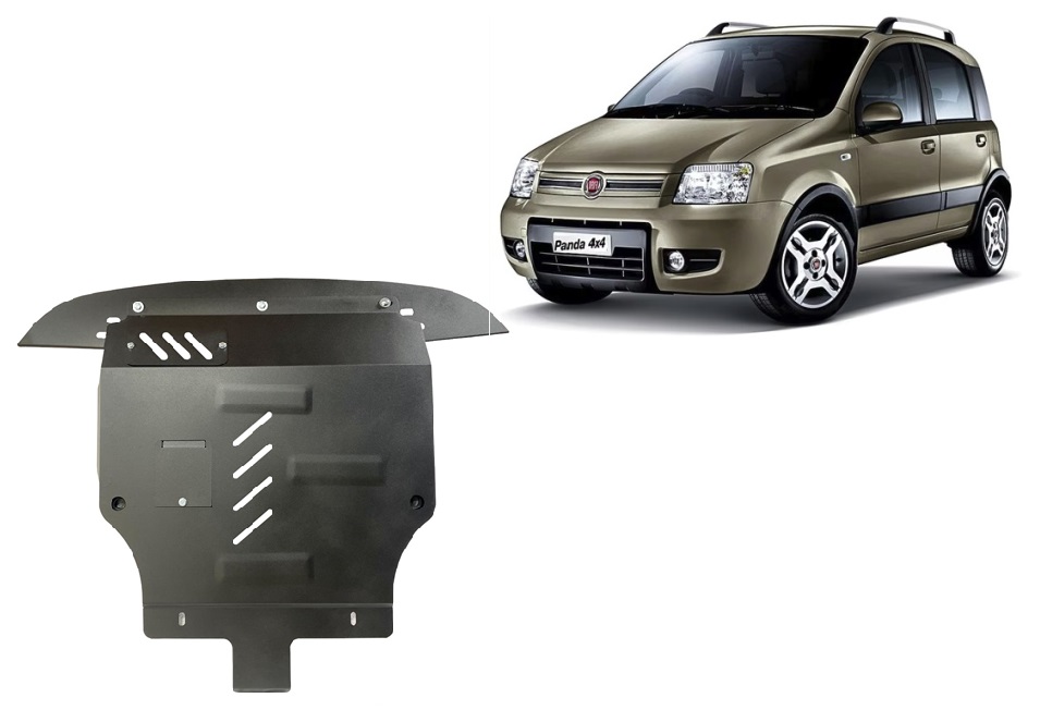

WOW ;) I can have one for just below 150 GBP, however it needs sandblasting and at least galvanization. I'm afraid due to weight and size the shipping cost would kill the offer :(
Now that is something I have not thought of. Im going tomhave mine sandblasted and galvanized before it rots beyond repair. THe bolts are now lathered in anti seize compouns but getting the sump guard treated never even occurred to me
