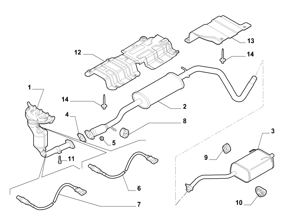

Morning, does anyone have access to a fiat parts catalogue, if so would it be possible to post a diagram of the panda 100hp full exhaust system please. Thanks
Adam.

Here is generic, if you give me your vin I can do an actual ?

Thanks again, it's the centre section i require. According to the MOT advisory it has a leak at the flexi pipe which i assume is the part straight after the join with the manifold/cat.
Hi, yes, it is the whole centre section - part 2 in the diagram.

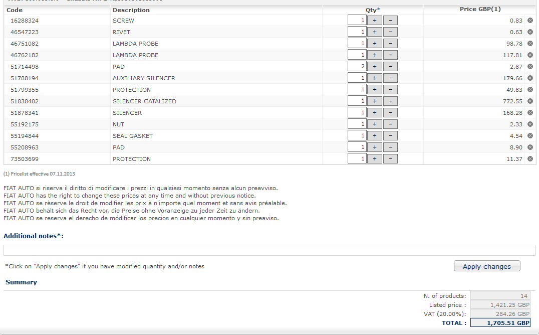

51788194 AUXILIARY SILENCER
CENTRAL EXHAUST SILENCER Availability: Product that can be ordered D Weight (grams): 8350
Listed price(1): 179.66 GBP
Price including taxes: 215.59 GBP
It must be rather substantial to be 8.3Kg !! - should hopefully last as long as the other..

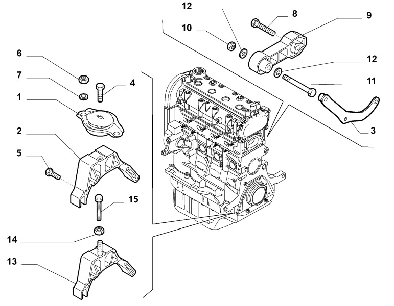

Change the bottom stabiliser bar on the gearbox to chassis at the same time - this can AND DOES get weak and causes a lot of engine movement.
Not an mot failure or warning usually as they look fine - they just go soft.. they are ony about 22 quid new (the 100HP is cheaper than the 1.2 ! - half price - my 1.2 has one lol) this will assist the longevity of the new section.
its part 9 on this image - actually 30 squids in UK,! yikes, only 25 Euro in Portugal... anyways, thats the beastie..
Hope that is of use.
Details for tie bar
51739522 ROD
ENGINE/TRANSMISSION INSERTS AND SUPPORTS
Weight (grams): 522
Listed price: 25.12 GBP
Price including taxes: 30.14 GBP
