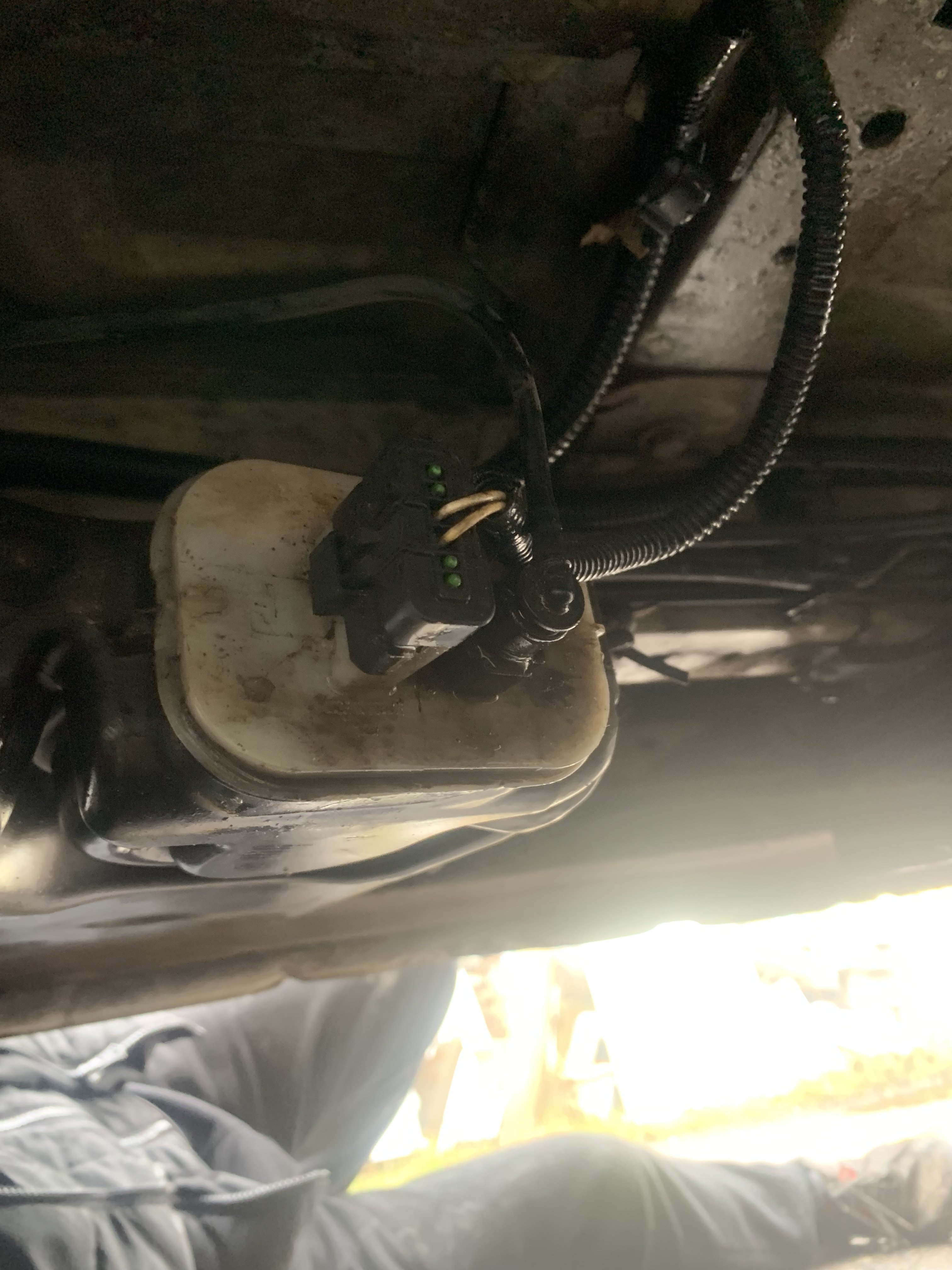

Its reading 92 ohms or there abouts off
If the pump doesn't have an open circuit, it likely still works. You could check if the wires actually apply voltage to the pump, if there are animal bites present, the wire might also be broken and breaks in the copper might not even be visible from outside, if the isolation is damaged at some place, copper will corrode and lose its conductivity, you can listen if the pump actually works (I don't know if it makes that much noise, I bet the fuel pump will be much louder).
You didn't drive through deep water of some flooded ford, did you? Seems to be a popular sport in the UK :whistle:
