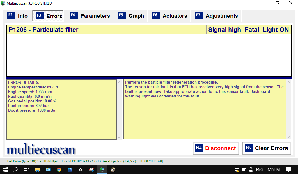

This is also posted on the Doblo forum.
It's a long, long story!
The very shortened version is:
A few years ago error code P1206.
A lot of reading up, research, checking forums and asking friends about how to fix this.
Error code comes up, I do something (mostly by replacement), a forced regen and then clear the error code. Back on the road for a few months maybe a year then P1206 returns and I have to find some other thing to do which might fix it, and so on.
This is what I've done:
Made a few graphs using MES
Changed the oil and reset the oil counter.
Replaced:
DPF pressure sensor
EGR valve
DPF
MAP sensor
The latest was replacement of the thermostat and engine temperature sensor.
BUT THIS TIME
The forced regen failed and it won't do it.
So, over to you knowledgeable folk.
What is going on?
What on earth have I got to do to fix
  1. The P1206 problem
  2. Getting the forced regen done so that I can get back on the road and see if this was the cause of the error code.
Any help much appreciated.

DPF is about 1000 miles old, but now needs regeneration. Once the P1206 error comes up it won't do a normal regen and requires a forced one, then the P1206 error can be cleared. I've got the dreaded P1206 but it won't do the forced regen (yet).
This morning I connected up MES and ran through the "Parameters" to see if I could spot something. The only thing that jumped out at me was the "Clutch Pedal" was showing "Pressed". Put my foot on/off the pedal and it changed to "Released". This makes me think that for MES to get the forced regen done the pedal must be "Released" otherwise it looks like you are about to put the car into gear and zoom off whilst it's doing its regen! Possible sticky clutch pedal sensor? Are there other conditions that need to met?
Cheers
Ron
I am not an MES user so maybe others can comment better, however is there any relevance, in readings for boost pressure being higher than desired boost pressure? I see it mentions only 30% particulate blocking and normal clogging, but could a partially blocked DPF affect turbo readings? What was the mileage when you changed the original DPF previously assuming driving conditions similar? Is there another thing that can cause the discrepancy or is that amount of pressure difference normal?

Hi and many thanks,
I'd looked at the boost pressure discrepancy and wondered if the fairly small difference was significant. Any ideas?
The dpf is 30% blocked and the differential pressure reading is low, this blocking figure tallies with mileage since dpf was replaced/regenerated.
The DPF is about 1000 miles old and to get it to do a regen after the foot brake business (see above) I had to tell ecu that a new DPF was fitted (again). Regened ok then.
Differential pressure sensor replaced a few thousand miles ago (genuine part).
DPF was new from BM Catalysts. It fits ok and has an Homologation certificate, which I think means it's been certified to do the same function as the original part.
ECU told about the new DPF (MES), BM Catalysts require that a forced regen is completed when the new DPF is fitted (this was done).
This is all baffling.
Any more suggestions very much appreciated.
Ron
