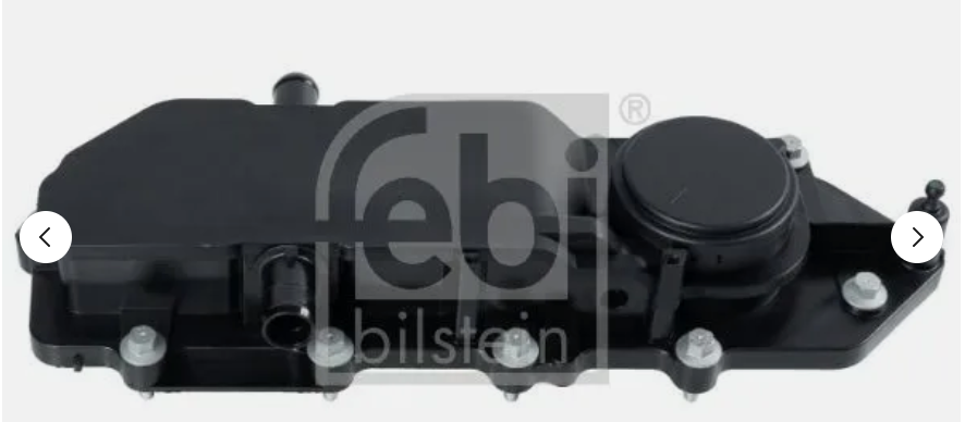

I therefore bit the bullet and replaced the Crankcase Breather Valve, a screen grab is below *this did NOT fix the issue* oil cap test was same after this also, so hope there is not a wider issue.
But in case this does help anybody, replacement requires the removal of the top cover which is held in place by 3 clips in each corner and can be pulled of with some encouragement. The hose connected to it can be removed. If never removed before, then the factory installed hose clips simply require to prise the bent metal on the clip up to allow it to be removed, then the 10 bolts. Ensure the new part has a gasket in it before fitting to avoid issues. I used a jubilee clip to secure the hose again (also ensure the small v on the hose allignes with the breather valve case.
I highlighed above that this did not resolve in case anbody makes this error.

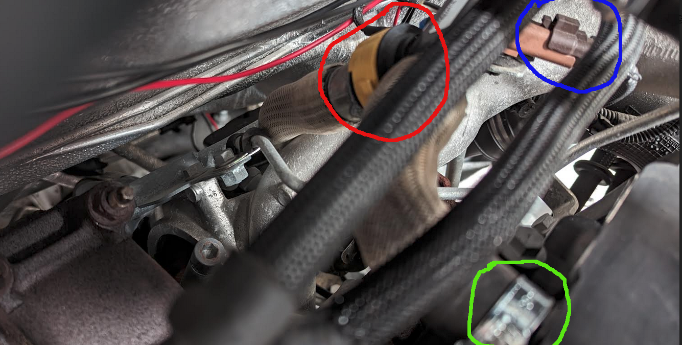

Replace Crankcase Heater (also known as blowback heater).
Next, after considering more closely that the error is Crankcase Valve *HEATER*, i though, yeah, maybe its the heater.
I had been advised that this can be tested using an OHM meter or testing Amperage, to be honest, the information that I found was genral and to find something specific for this model was a challenge.
I had placed the meter on the pins after disconnecting the cable (or thought i had but later found i fudged it) and got no reading either for OHMs or Amps. It is akward to get to and cleary I was not on the pins properly as I tired once removed and got a reading for OHMS that was same as a replacment part.
The heater is below cicrled in RED. Circled in BLUE is the connection. GREEN is the hose clip.
If I disconnect the heater (circled blue) i get the same OBD2 error every time even if clearing it.
So obtained replament part.
Steps:
Remove hose (circled GREEN).
I had fumbled around for a LONG time trying to work out how to get to the bottom hose to disconnect as the replacment comes with this attached, and most photos online show both attached to the heater. If you need to remove the bottom end of the hose, it looks like a nightmare to get to it, especially if it is a factory clip that would need to be prised off.
However, there are 2 tabs on the yellow ring, if pushed apart slightly then the bottom hose pops out.

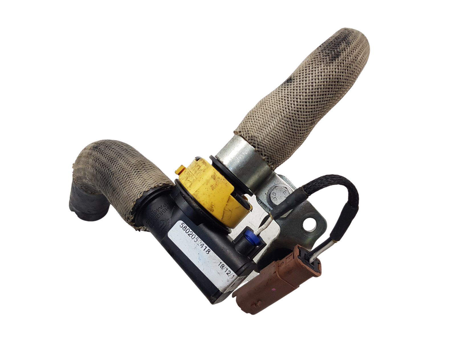

Also part number(s) for heater and PCV that can googled in case of help to anyone (if it does prove to be the root cause in your cicumstances)
PCV (positive crankcase valve) - FEBI BILSTEIN 174487.
Oil return sensor/Blowback heater/Crankcase heater - 5802052418

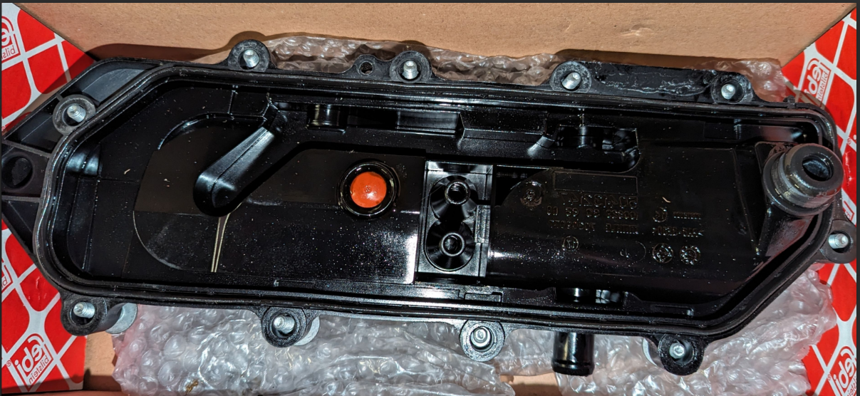

Have you any more info or diagrams for the breather, and how to test if its operating properly please. Ducato 2010 2.2
I am happy to be corrected, but believe that there are PCVs with slight variations between some of the models. I am not familiar with the 2010 2.2 but the PCV would still have the same function with an intake and out take.
In relation to the one that I removed if this looks similar to your own
Oil Breather - Top
Oil Breather - Bottom

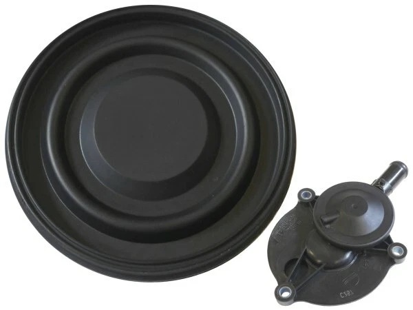

It does appear that you can replace just the crankcase breather membrane in isolation for less cost that the whole assembly should this be proved to be at fault. This is located underneath the circular part on top, but this also contains a spring, so some caution if removing to avoid this disappearing into the depths of the engine bay.
