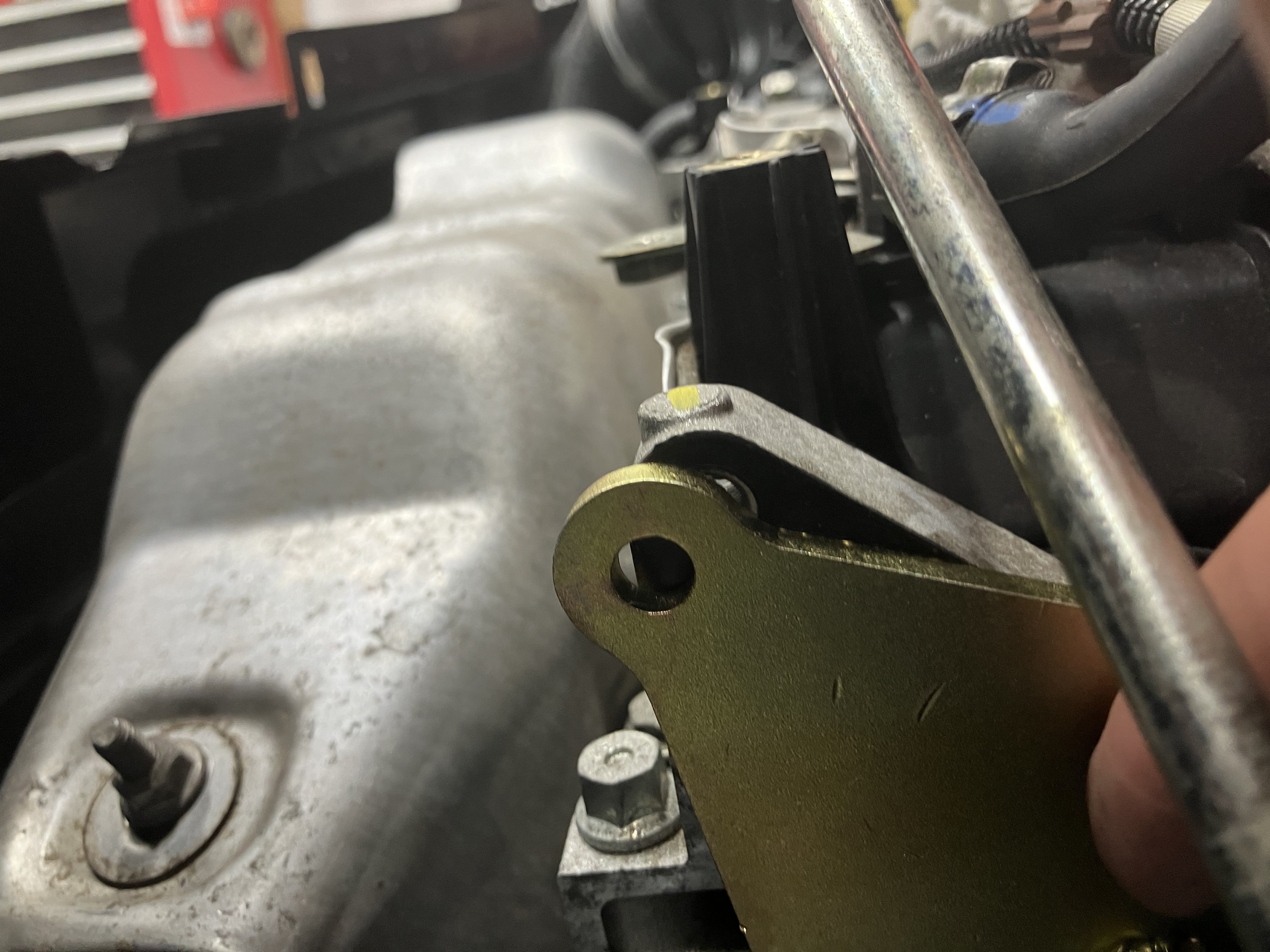

The 0016 is a timing correlation issue! Mine was a timing issue in the end!… due to the removal of the crank pulley which has no locating key moved and knocked out the timing! (I now know that when I put in the flywheel locking key it wasn’t actually locking the flywheel!) I tried several times to get it back to where it should be, spoke to Fiat they said it was still a timing issue, in the end I had Fiat set it up!
To be honest I thought it can’t be.. however prior to me taking it in I thought I would check it again, so I locked the crank at TDC by locking the flywheel using the tool - correctly this time, I also locked the crank pulley using the locating pin but when I tried to lock the camshaft with its locking tool it was slightly off!
Even now I can’t see how knocked it out of time!
I send you a photo what I mean if this helps buddy!
