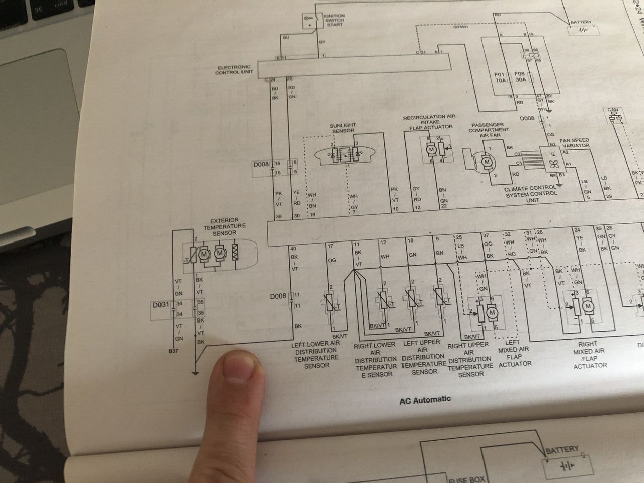

Haynes wiring diagram 12*24
I am guessing that D031 is the plug between passenger front door and frame. But where is D008 which seems to be a plug between D0031 and the control unit? It's hard to follow the bundle of wires cause they are split up and gathered along the way between door and centre console?

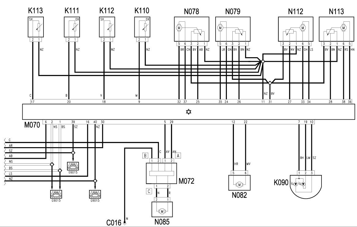

Hej, replied on the other thread so here are the Drawings from eLearn again, looks there is not D008 …
MvH, Bernie

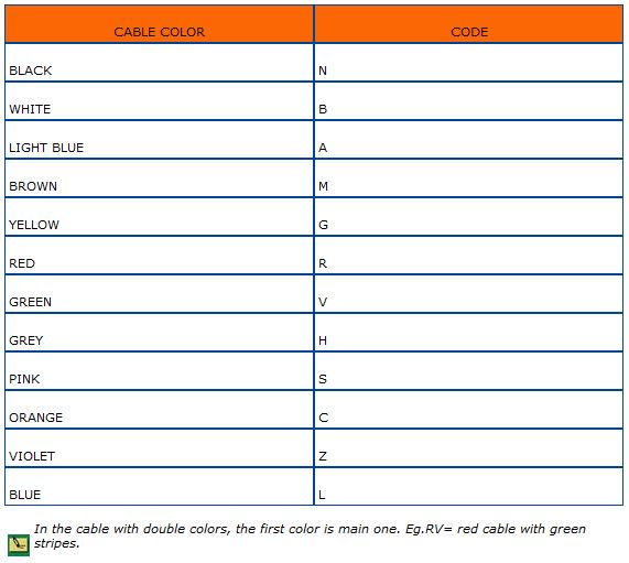

Hi Bernievarian!
Uploaded the page from Haynes I was writing about.
Pointing on D008 on the page with Auto Climate A/C?
On same page right now I just saw D008 just above the Fan Speed Variator - something tells me I just fiddled with that cable earlier today (another thread about my problem with fan speed suddently dropping down).
And again I just woke up and saw D008 just a thumbs length above the D008 I am pointing at.
Earlier today I found a big blue/black plug just behind the trim-sidepanel at passengers lower leg towards the middle. Must inspect the colorcode on the wires to see if this is the plug?
If yes I should have lots of space to hide my little cheat switch without having to route cables from far away :)
Is there usually an indication on the plugs to what their name should be?
https://www.dropbox.com/s/7uibucnapmaul5e/Billede%2011-12-2018%2011.59.26.jpg?dl=0

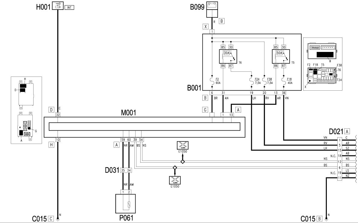

Hej,
the D008 connector in Hayne's manual correspond to D021 on the eLearn schematic …
MvH, Bernie
Hmm found out that the Haynes colorcode on the one of the two wires to the outside temperature sensor was wrong!!!
Cables are Black/Violet and Blue/Green or something. Luckily checked cable color at the plug in the mirror instead of cutting cables in the cabin first...
BERNIEVARIAN: I guess I'll forget about locating that plug - whatever it's called. I will just cut the 2 wires near the entry to the cabin at D031 and fit my button+resistor around this area.
