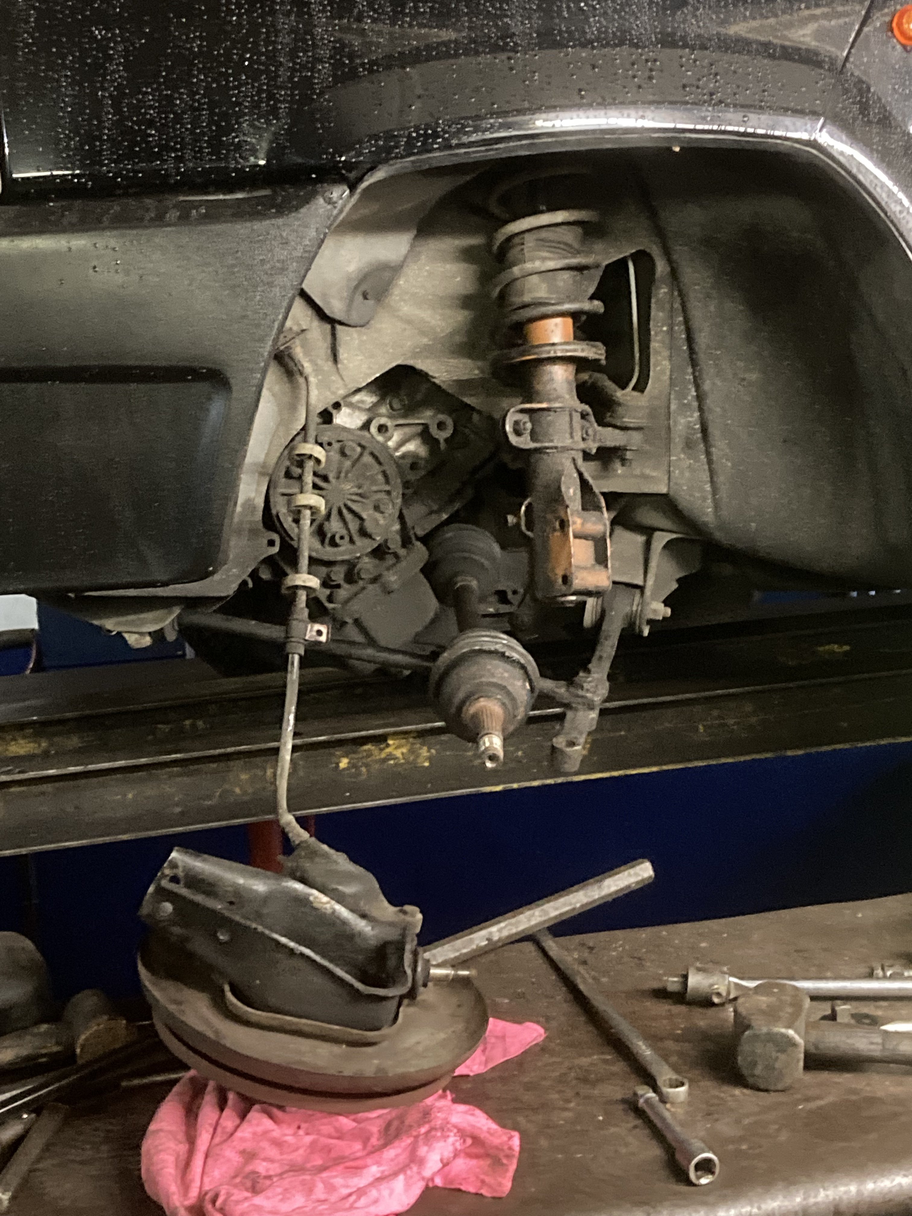

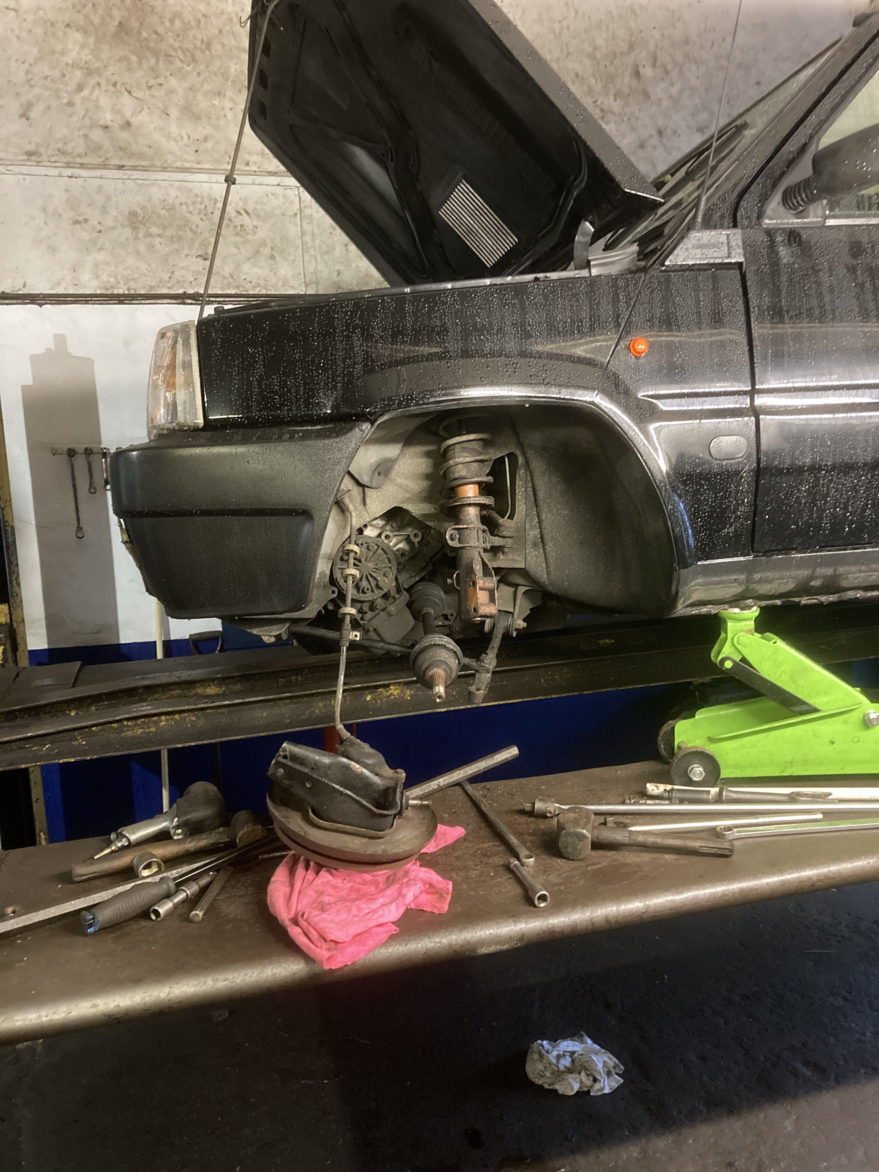

Well, it’s been a while, with one thing and another but the new front shocks are finally on Manda. To say the old ones were knackered is an understatement.
Still struggling to locate rear shocks suitable for a Selecta and have ordered a pair which look identical to mine, though the website specifies not suitable for an auto. The ones which were meant to fit didn’t.
Plan B - if these don’t fit will be some Ridex rears.
New, posh internally adjustable drivers door mirror and non-cracked dash also fitted. 😀🐼
