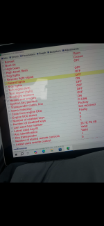

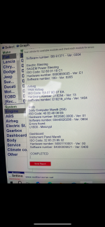

Any advice on this fault code pleaseeeee….
I have looked into previous threads to no avail with my issues
Van drives and sounds fine which I can’t understand this code
No warning on dash
Just comes in mes software on body it’s u1600
The van has no immobiliser I have 2 keys that are showing programmed
I have also seen in parameters it says ecu code from engine Ecu not received and a faulty one … may this be a short on the wire ?
Any help highly appreciated before I get a auto spark out to try shed some light on the situation
Oh I have also seen the code change to D600 but that wiped and then came has u1600
If anyone has any ideas to what I can do I’m on the last run now after weeks of looking and changing sensors on the gear box

Maybe because the factory immobiliser has been deleted and removed?
When I bought the van nothing was on it only a cut off button no idea what that did
But I wanted a ghost fitting but the guy that came said it couldn’t be fitted to my ducato
So he fitted some device behind my dash and gave me 2 tiny plastic fobs I have one on my keys
I wave it on the dash which then activates power the dash will light up this is all I know that got done
So could this be the issue the first immobiliser got removed and deleted maybe ?
Minicrypt relates to an imobilser part and as you have stated the imobilser has been removed (programmed out) there is nothing you can do about it.
It may be possible if you have or know someone with the right equipment. From the MHH forum:
You have to virginize eeprom, and then make Immo Off + DTC U1600, then checksum has to be corrected in Flash file.
After you wrote virgin eep + immo off flash, car will starts no problem and without DTC, also remember that the transponders in keys have to be recognized from car's BCM, otherwise you will have code light in dash.

It says keys are enabled 2 of them
Immo codes by factory
Key identification is valid
Stored remotes 1
Latest used remotes 0
Engine ecu faulty
Code from Ecu not received
Stored remotes 1
Engine ecu faulty
That's almost certainly all because the immobiliser has been removed. As long as the vans starts and runs it's not a problem, but it appears that the faults could have been flashed out according to the MHH post, which would stop U1600 appearing if it bothers you.
