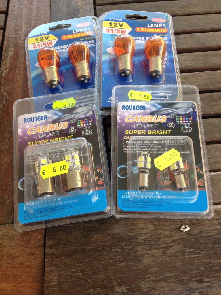

Got some spare bulbs for £4 each ImageUploadedByFIAT Forum1432303165.051080.jpg

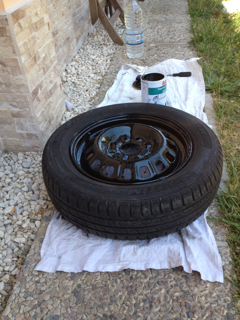

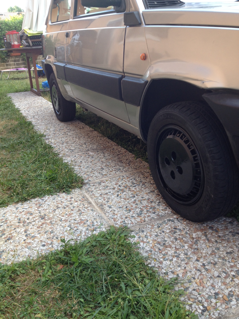

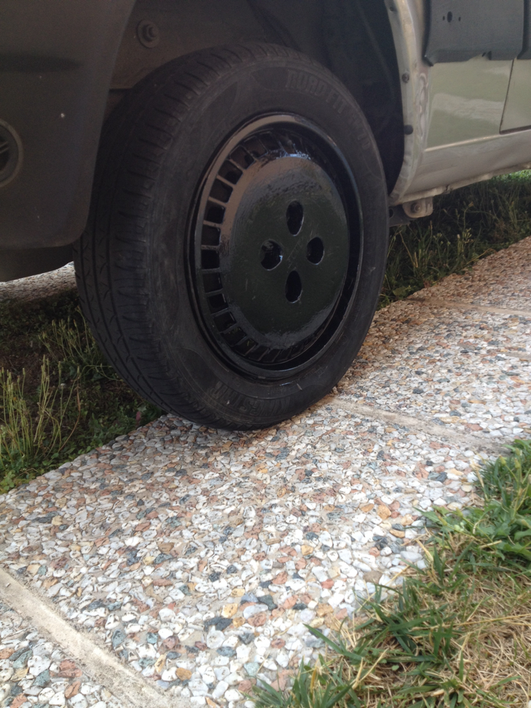

Anti-rust paint for the wheelsImageUploadedByFIAT Forum1434629581.258934.jpgImageUploadedByFIAT Forum1434629620.596211.jpgImageUploadedByFIAT Forum1434629650.578151.jpg
Sent from my iPhone using FIAT Forum
I was looking for some gun metal grey plastic dip for the wheel hub but can't find it on eBay.it?

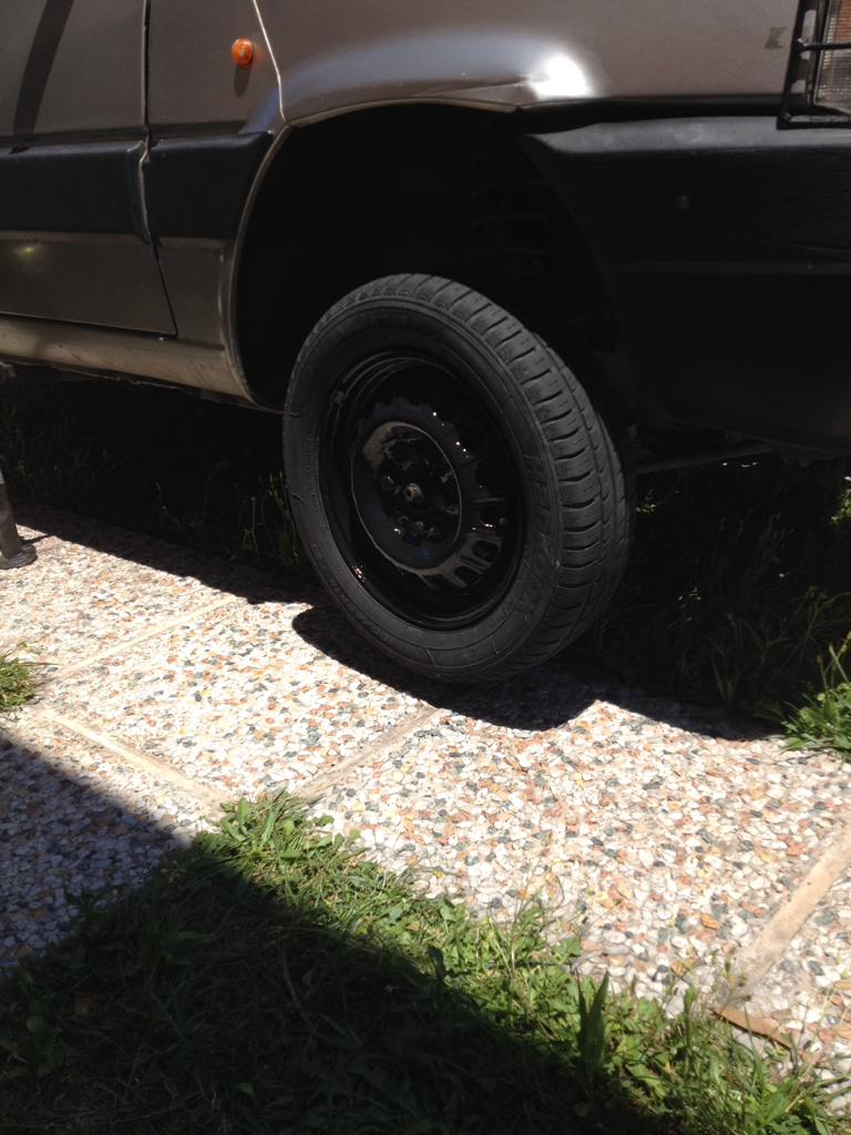

Black wheels.... Fast n' Furious ?ImageUploadedByFIAT Forum1434644343.779949.jpgImageUploadedByFIAT Forum1434644386.794644.jpg

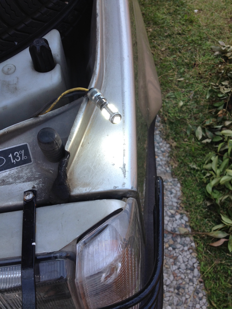

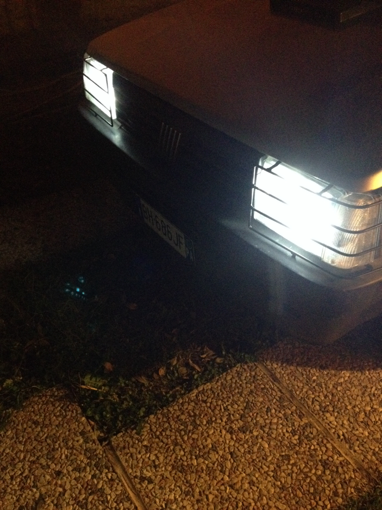

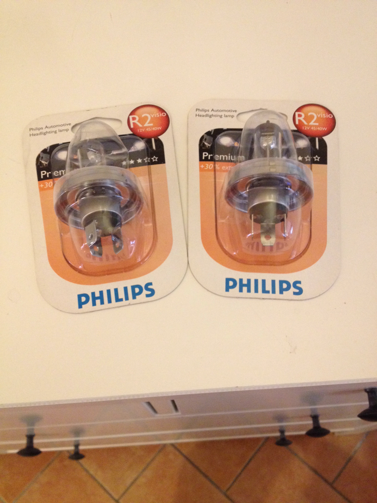

LED bulbs for the front and brake lights
I like them and as far as I know legal... And I just read dragon guide???ImageUploadedByFIAT Forum1435167133.865632.jpg

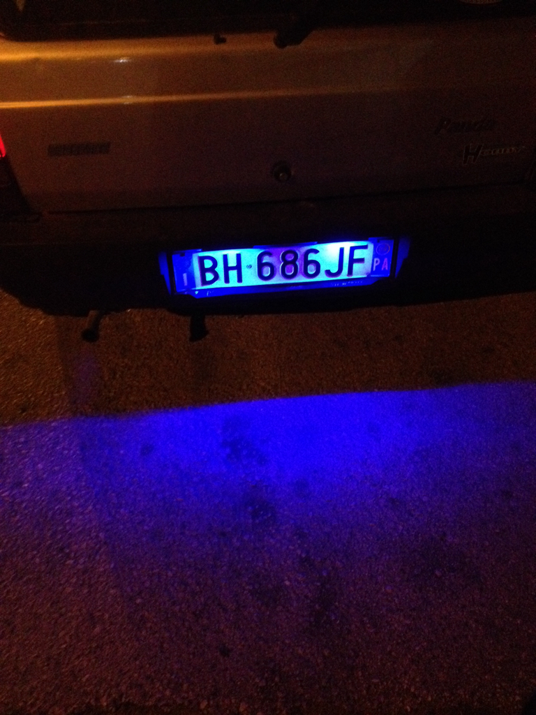

ImageUploadedByFIAT Forum1435178089.675003.jpgImageUploadedByFIAT Forum1435178122.699561.jpg
