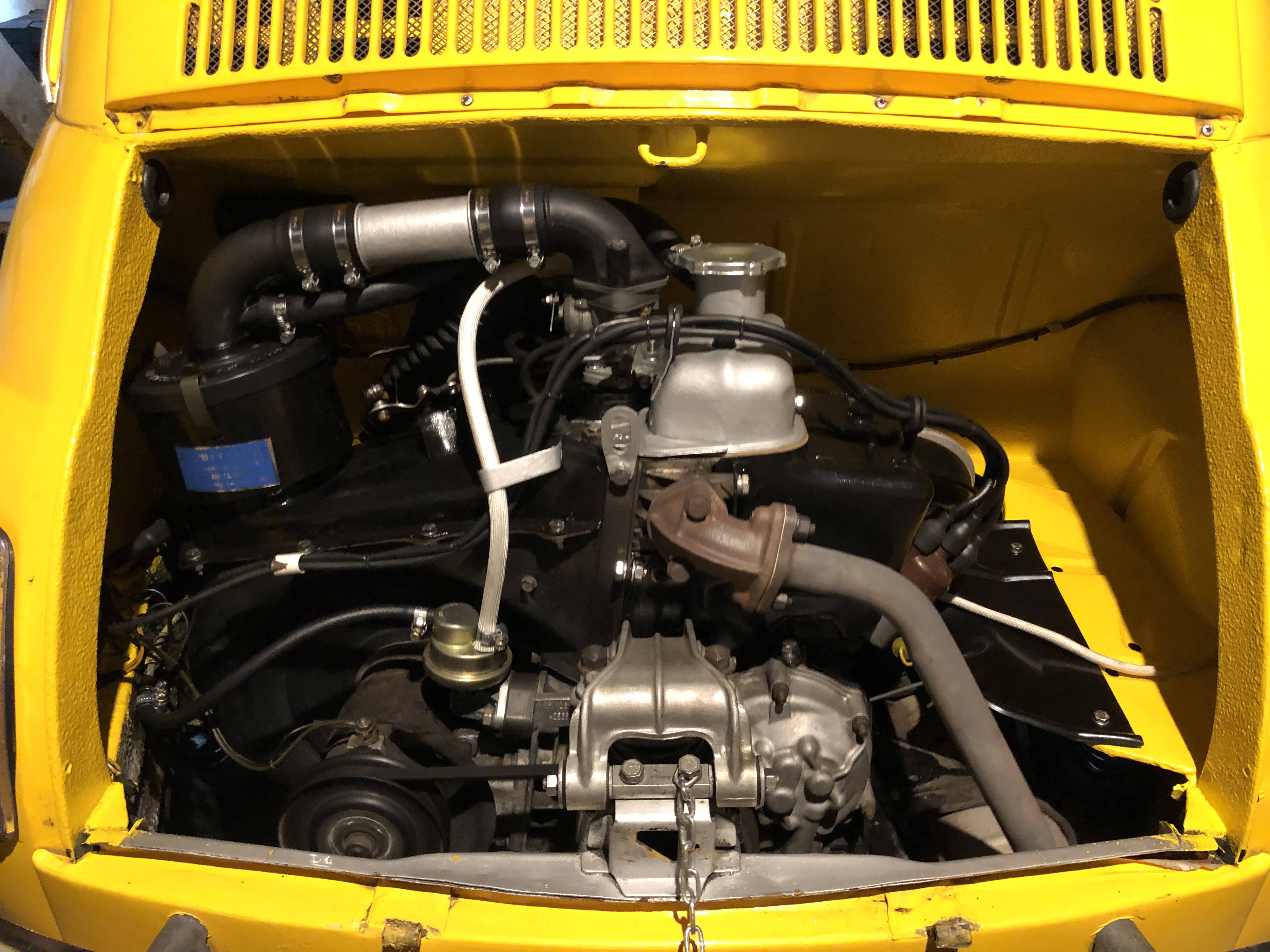

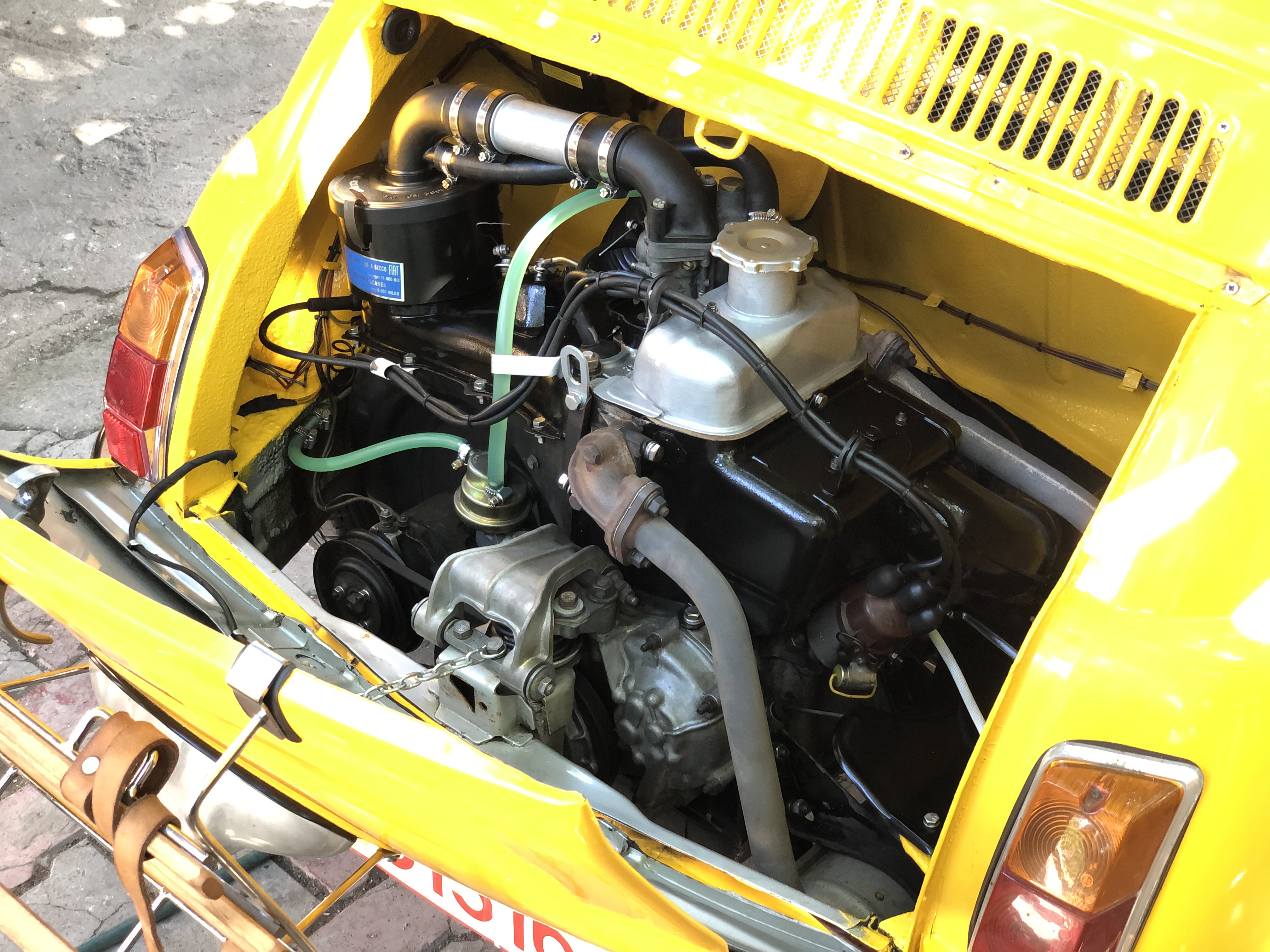

Hello,
This is my 500F from 66’.
I have it since a couple of months. It lived in Spain since the 80’s so only a couple spots of rust. I started working on the engine since it was a bit rough. Still dont know if it’s a 500R engine or a Fiat 126. The engine code is 126A000 and has a sincromesh box

The 500R had the Mk1 '126'engine (594cc) and gearbox. The main difference is the carb---the 500R had a smaller carb then the '126' to slow it down. Fiat found that, due to its lower weight, the 500R was quicker than the '126' with the same engine in it. Being that they were trying to 'sell' the new car (the '126') and the 500R was built to use up 500 bodies (never came into the UK in RHD form) . , they had to make the 500R less attractive, so slowed it down. The "126A.000" engine number is the SAME as the '126', so when you buy engine parts, look at '126' and NOT 500.

Thanks for the replay.
Yes, i have been ordering parts for the “126” and seen that a lot of parts are the same, but not everything.
I have the 28 IMB Weber thats the reason I guess the engine is from a 126.
I attached a couple of images.
One thing that I can’t realy undersand is why do I have side play on one of the rocker arms. I’l try to post a video somehow. The rest Of usual problems I have fixed.
https://youtube.com/shorts/bxxox4GgmdE?feature=share
This is the side play that the rocker arm has.

I'm assuming you know that the apparently loose rocker arm is missing the adjuster for the tappet....that's why it's wobbly. A small amount of play is normal.

Yes, I am aware that the adjuster is missing. I took it out. I understand that play seems normal, but if you took a look at the video the play is quite large. I will messure it next time, but it’s around 2mm. The rest of them dont have this play, and I checked them the same way. I plan to messure all the rocker arms to see if they are the same.

With that out of the way, ;), I would say that you're right. It looks like it's actually more than just side to side....maybe a bit of rocking in it.
I would start a thread in the main part of the forum and let everyone come up with suggestions there. In my experience, it's very important for the smooth running and maximum quietness of the engine to get the fit of the rockers just right, so you're right to be concerned about it.

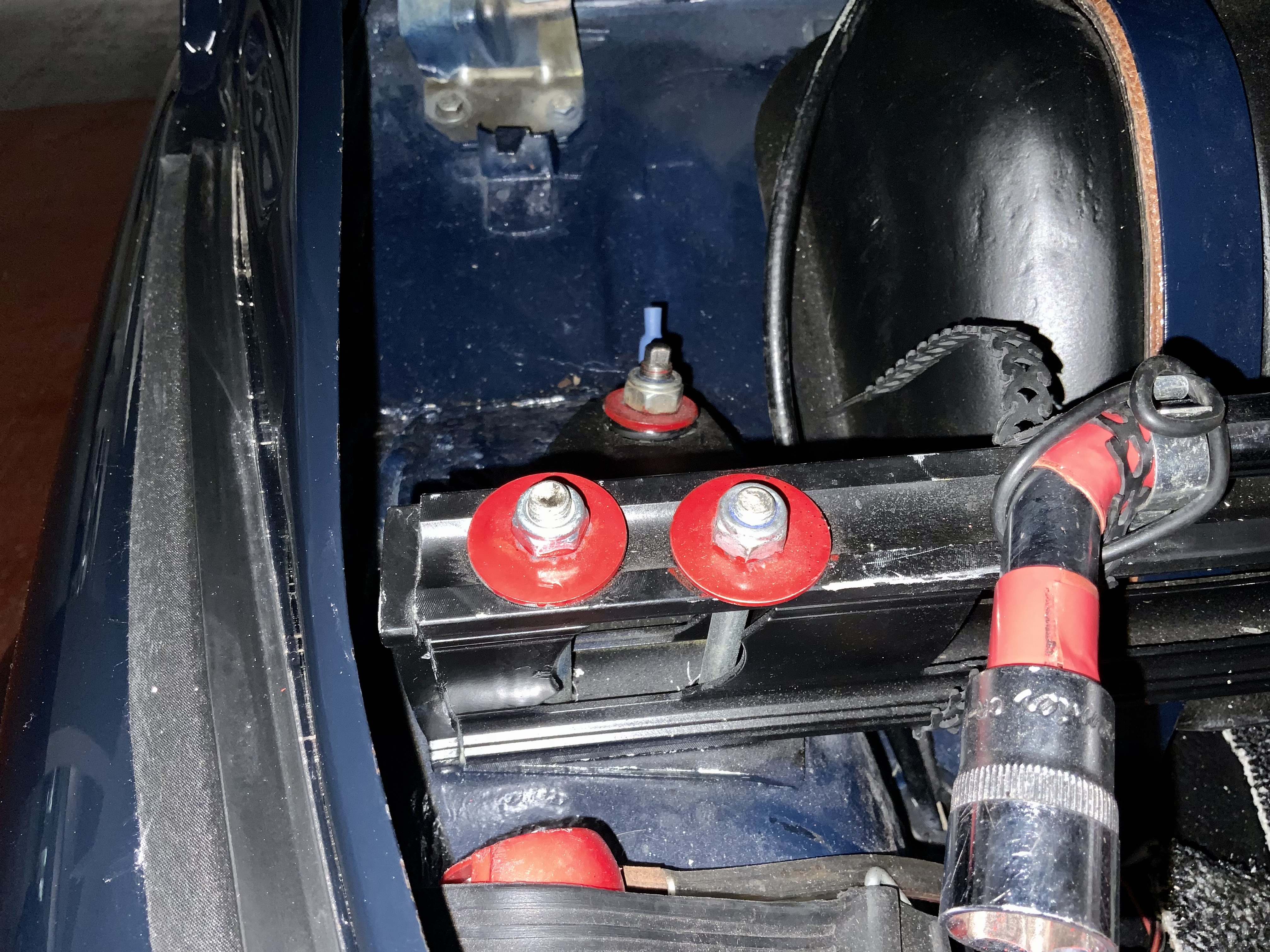

Thanks for the pictures of your car---all the best at MBG; Anton knows what he is doing. Is that a cross brace I see in your front compartment? do you have 'coil-over' front suspension? If you do, is there any possibility of you sending me a couple of pictures of how it is attached please? I am fitting 'wish-bone'(aka coil-over'_ suspension to my car this winter and looking at various ways of fitting a cross-brace. I know that they are obtainable commercially, but want to see if there is a better way to do it. ([email protected])
Hi Tom yes I fitted the cross brace just after buying the car, I made up 4 rectangular 4x6” thick steel sheets roughly 2mm thick then drilled them with the same size hole as the shock absorber placed one plate above the the shock absorber then the other on top of the wheel arch sandwiching the wheel arch between, I had to shape them to fit the arch shape, then two bolts bolted through the wheel arch 2” towards the front of the car, this allowed me to fit a straight bar (clearing the fuel tank by 10 mm) to the other side at the same time. The bar believe it or not was an extruded 2 1/2” x 1” aluminium old very strong spirit level, (you can just see the cut out where the bubble sits) it is much sturdier than the round one advertised on the net & looks tidier which I would think has some flex in it (that could be good though. It makes the suspension much harder obviously, as you are connecting both coil overs together. I will try & send some photos this morning before the car is transported off to MBG.
Hope that makes some sense. Barry
Thank you for the pictures of your cross-brace Barry, and the explanation of how you made it (and what you made it out of!); very helpful and much appreciated.

Hi BB, I would advise you to strip the rocker assembly completely and check for wear on the main shaft - the movement you have is abnormal to my eye!!!

Hello. This is my plan as well. After I sort out my rust issues this is the next on the list. Since my post I got a second parts engine and that one as well has the exact play in the same area. Just my luck:)). Thanks fot the advice
