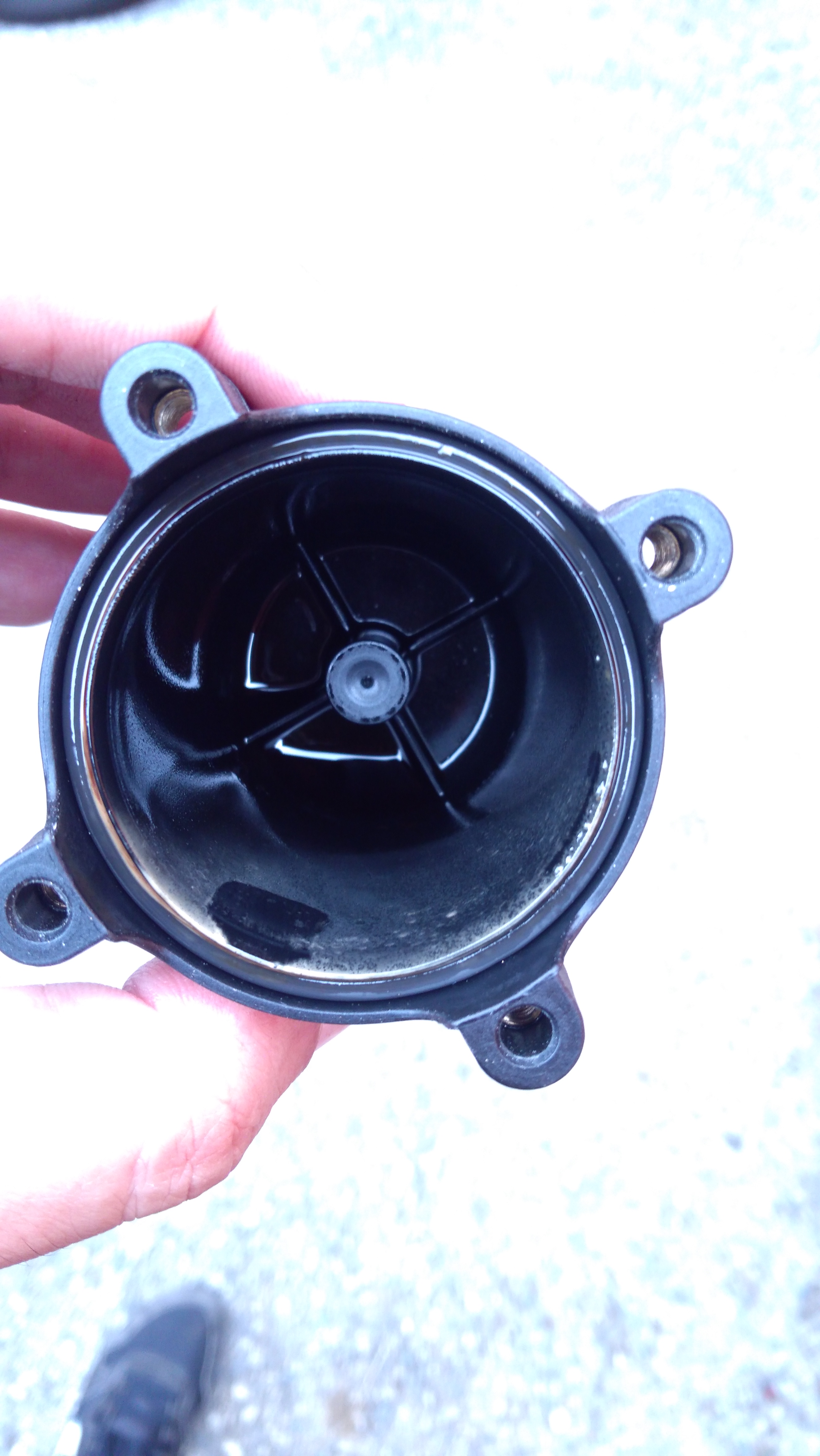

Hi everyone,just a quick ?.
I wanted to do away with the oil separator and covert it into an oil catch tank.just wondered if anyone had done this conversion.
The design of the oil separator on the abarth 500/abarth punto tjet and the bravo tjet is the worsed,which is why I want to do this mod.
Any help,guides would be a big help.
Many thanks
hi, i just 'tune' separator by filling output to manifold with silicone (RTV?) and use hose for other one which runs down under engine bay. Its basically conversion to atmospheric vent system, it works fine - no oil leaks from engine.

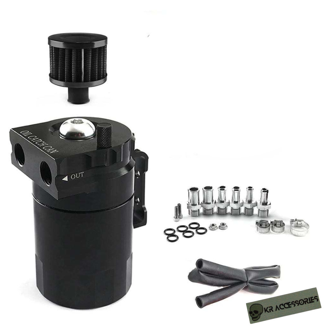

Hi guys, looking for help installing a catch can on my fiat bravo 1.4 tjet. The oil separator membrane is messed up, and its difficult getting a replacement in SA, as the bravo/alfa brand isnt strong. Due to this ive decided to get a catch can. below is the catch can I'm getting but I'm not sure which hoses go where, and which hoses I must block.
This is the can i bought
