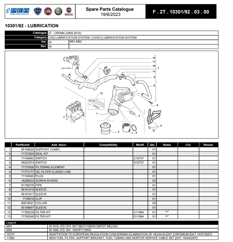

On most 1.9L Multijets the oil filter & cooler stack is on the back of the block, low down and just above the horizontal drive shaft.
As you can see from the drawing above the switch, Item 3, is on the lower part below the cooler stack. This is why you can not see it from above.
To gain access you need to take the engine bay lower tray off.
Thanks for the reply, the 1.9 and 2.0 litres are very similar but slightly different. The sensor is not where that diagram suggests, I think uts on top of the oil cooler.
Still struggling with access, looks like I'll have to take the sub frame off just to see clearly, then try to get my hand in enough to fiddle and find the sensor.
