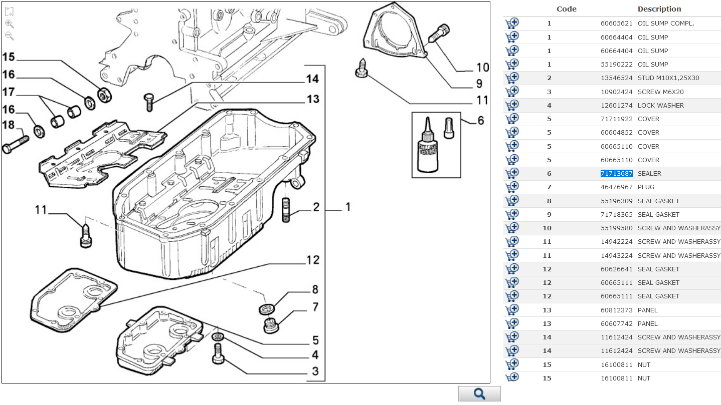

Evening all, hope you are well. Would someone be able to help me out with a simple (hopefully) problem. I have a leaking oil sump and happy to remove clean up and replace, however I am unable to find a gasket for it? It is correct that there is no gasket and only the use of sealant is needed? Thanks
Hello there. Not a job I've looked at but going by ePer it's sealant rather than gasket
The part number for part 6 lead me to Shop4Parts who list it as sump sealant:
Sorry I can't be definitive but I hope that helps
