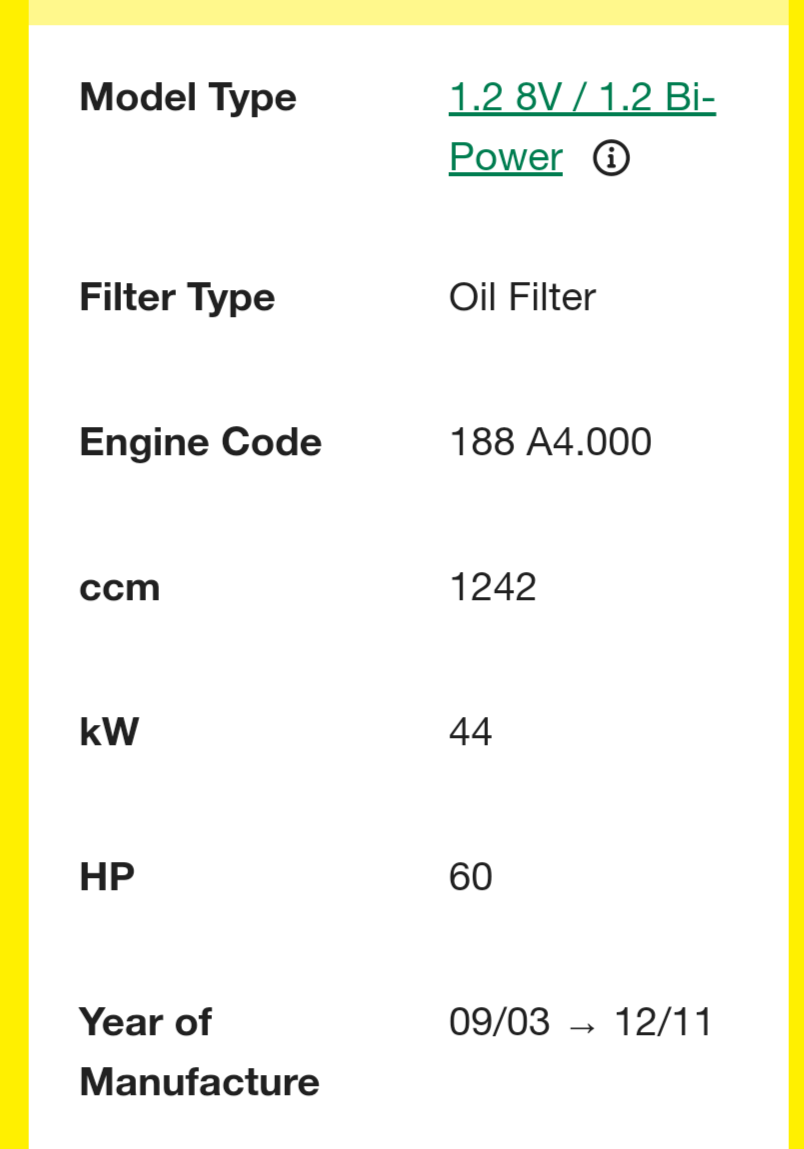

Are you sure it's the right part number with an anti drain back valve fitted, quite a lot of filters physically fit
Looks like the oil is draining from the filter
Yes, all filters fitted had drainback valves and matched the OEM part number. I've tested multiple brands, only Mann Filters (W610/3) limit the phenomenon. It seems manufacturers are nowadays using nitrile rubber in drainback valves which gets harder with oxidation and temperature circles. Silicone is superior but I couldn't find any filters using it. But I think this is secondary.

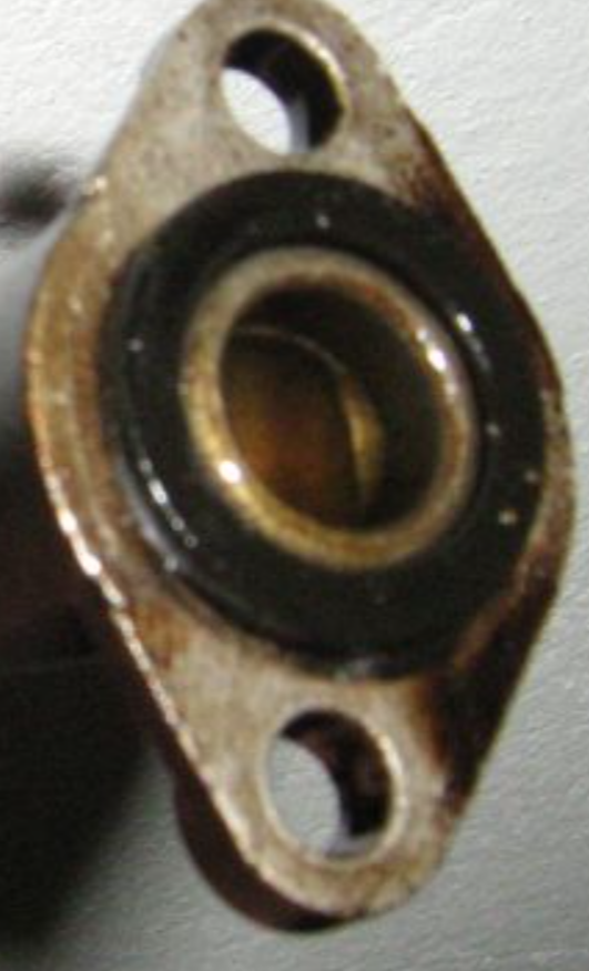

There's virtually no clearance on the pickup pipe, people have had problems just by jacking under the sump without some wood to spread the load
We can't tell if the pickup pipe is damaged as well untill the sump is off
So I'll replace both. From what I see at mine is plastic, not metal like in the picture. Are there any special considerations? I can't find any torque specs for those two bolts...
"If" is the same as the 500
Oil Pump Pick Up Tube to Oil Pump - M6 Bolt 10 newton meters
The photo is from the same engine but in the Punto, where sucking in air was far more common
The plastic is could be an upgrade, more forgiving
But that's just a guess on my part
