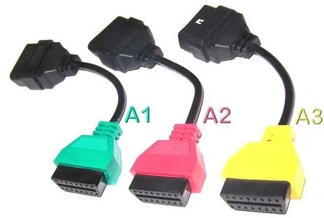

Fiats diesel engines fitted with DPFs normally need two separate reset procedures carried out when the oil is changed. One is the normal "service light" reset that is performed in the body computer (some models have a switch twiddle process for this but Multiecuscan is better). The second is an "oil degradation counter" reset that is performed on the engine ECU. Only Fiat specific diagnostic equipment or software can do this. I recommend Multiecuscan. Note you may need an adaptor lead and the very cheap <€15 ELM327 interfaces have a design issue that can prevent them connecting to the Engine ECU. This reset is often missed by garages and can result in damage to the DPF or the car going into limp mode.

You need a laptop computer running Windows (any version from XP to 10), a ELM 327 interface "modified for Multicuscan" a "yellow" A3 adaptor lead and a registered copy of Multiecuscan www.multiecuscan.net (don't pay the registration fee until you have mangead to get it all working and can read CAN information.).

I've got the ELM327 v1.4 and removed one of the fuses myself on the cheap. The yellow adapter I got as well imported from China. Came out six quid for the elm and another four for the adapter leads.

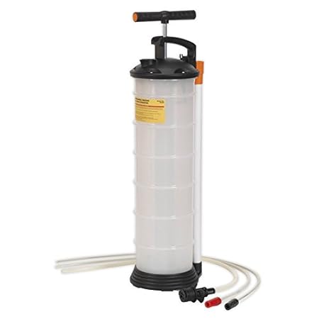

When I did my oil change, I didn't even jack the car, I used an oil extractor pump (bought cheaply on eBay) through the dipstick, which is what many garages are doing nowadays.

Are you using a manual or electric oil extractor? Can you get it all out using this method?
Yep, it got all of it out. I checked the cylinder and it was definitely 3.2L, it did take roughly 35 minutes as I used the small diameter hose, but definitely use the medium hose with the oil extractor to speed it up. I could see how an electric one may suck it faster but I wasn't in a rush and it's definitely cheaper ;)
I used a manual one, put it next to the car and inserted the hose into the dipstick until I could feel it's all the way in, make sure that the tube is straightened.
It looks like this, mine was a generic model from eBay, they should all do the same job to be fair:
Pump a couple of times and this creates some form of vacuum allowing the negative air pressure to be sucked into the cylinder itself.
When there isn't much oil movement and the tube sounds to make the sucking sound, it should be done. On my model, each barrel line is a liter. And 3 and a half was definitely in there.
A stock picture visualizes this:
I tried to jack up the car and do it the old way but couldn't find a sump plug in my parts and I guess I could use the pump to do the oil changes for wife's car and mine in the future.

You'll also need the Yellow adapter, check out ebay,amazon or aliexpress for one.

You'll also need the yellow adapter if you wish to connect to the service ecu to reset that. Mine one hasn't been very reliable so I won't suggest one but you know there's sites like eBay and Aliexpress.
