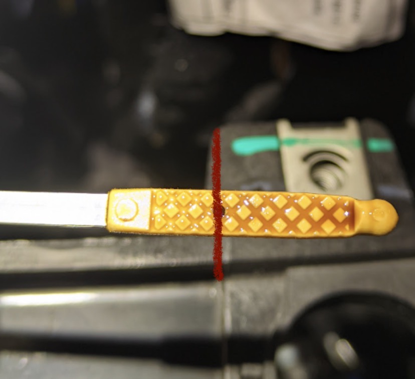

Dearest forum members,
I topped up my engine oil, and went on a roughly 2000km trip. I tried checking the oil level periodically during the trip, since according to the manual the car can consume up to 400ml of oil per 1000km (before reaching 6000km and stabilizing). The level always seemed fine to me (close to or at max) during the trip, and now after I got back home I checked the oil level again and it still looks like it's on max to me.
Please take a look at the pictures below and let me know what you think the level is:

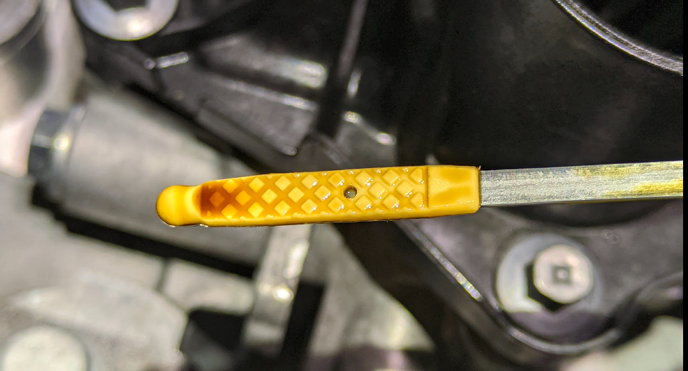

But did you take the dip stick out, wipe it, put it back in, take it out again and then measure it.
The paper in the second picture would suggest the level of the oil is higher even than the gauge on the dip stick because the oil gets thrown around all over the place when driving so you need to clean the dip stick before you take the measurement.

I don’t think it’s over the limit either, it’s just it looks like a faint amount of oil on the top part of the plastic bit.
My assessment from the first picture is that the level is somewhere around the dot in the upper part of the plastic.
The oil is definitely thicker below that line and thinner above, and the stupid pattern on the plastic means that oil migrates up the pattern by capillary action.
Probably would be much easier to read if the oil was a bit older
Thanks for the assessment. I still fear tho that if the oil is really at the max line and that the grooves are not fine enough for the oil to "capillary action up" through them.
I managed to find this picture from before my trip where the oil level seems not to even have made it up to the dimple:
But yeah it's hard to know. The texture makes everything worse I feel like... Harder to see, harder to reason about capillary action and stuff...
Is the other side of the dip stick flat? That silly pattern won't help in getting an accurate reading (Mine's a diesel and it has a metal end section that is much easier to read)
Unfortunately not. Both sides are textured.

I tried the trick of not inserting the dipstick the whole way in, and this was useful before when my oil was definitely below max and I could actually insert the stick partially and get it out dry. But now that I want to accurately determine whether it is sitting at max level, the trick doesn't really help much.
