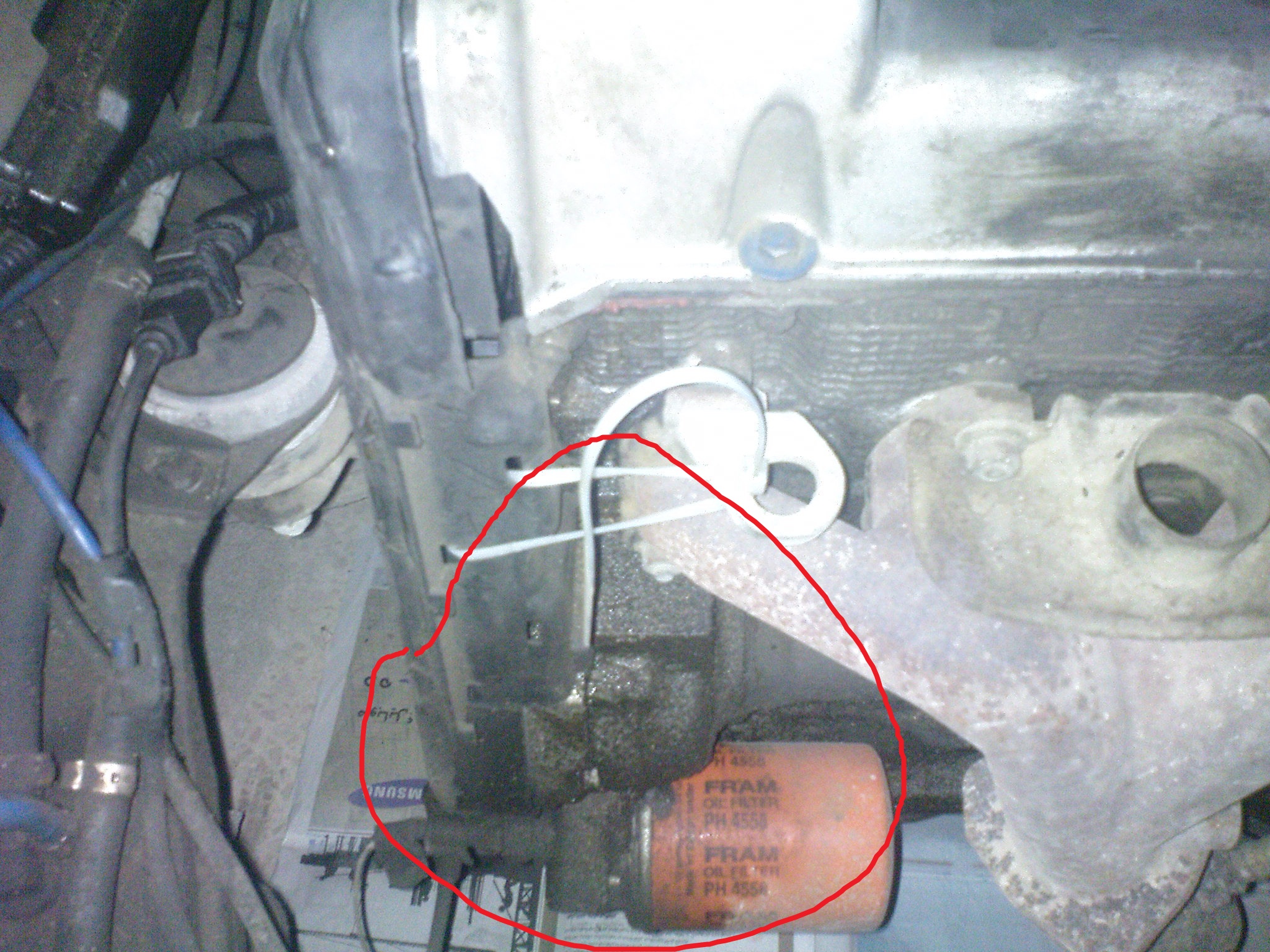

i posted some pics of the oil leak as i want to know where it might comes from :idea:
could anybody help me ?
i checked the oil level and it decreased a bit since the last time i checked it

Looks like possible combination of rocker cover and messy top up. Clean it up and keep an eye on things.
well i have cleaned it up since a while ago , i parked it for 6 days and left it there i noticed like 5 drops on the floor coming from the oil sank downward i kept moving with the oil until it stopped at the level of the front exhaust pipes
if it is rocker cover should the coolant level decrease also ??
sorry about my low mechanical info !!
I'm confused? Have you cleaned it all up and the. Run it for a day or two, to see if it comes back?
To me it looks like you missed topping the oil up. You should check your crank case breather pipe as well just incase it's oil being blown out via the dip stick
Thats the rocker cover, and you will find you can only really seal the leak with a gasket sealant. Mine looked like that when i bought it, i fiddled with some sealant and the rocker cover, bit of degreaser, and its all shiny.
Probably find its leaking from behind the coilpacks too (which you will not be able to get a seal for - fiat themselves told me to contact a company in italy (no joke)).
Personally, i used some PTFE tape and the original seal (to pack it out abit) job done (y)

well i'm sure it's not the dipstick but sorry for my ignorance is that the breather pipe in the pic ?? because i found some oil drops inside
im so confused but 90% of the opinions (rocker cover) i'm sending it to a local garage to check it and tell you the results
and im going to replace all the gaskets indeed to be cautious

I have found Loctite 518 anaeroboc gasket sealant is great for stopping soft gaskets slipping It can even patch up compressed seals like the coil pack seal - though its much better replaced. ;)
Being anaerobic, it's liquid until air is excluded within a joint so wont clog oilways like silicone RTV sealtant.

If you overfill, the oil will blow out through the breather, if it can, which will mess up the oil filter and possibly even lead to detonation (oil mist lowers the octane rating of petrol). If it can't get out through the breather it will get blown out through the gaskets and oil seals, which destroys them pretty quickly.
yeah you are 100% right and i'm now start to thinking "that's what just happened to me here" (breather blown out and oil went through gaskets and seals)
