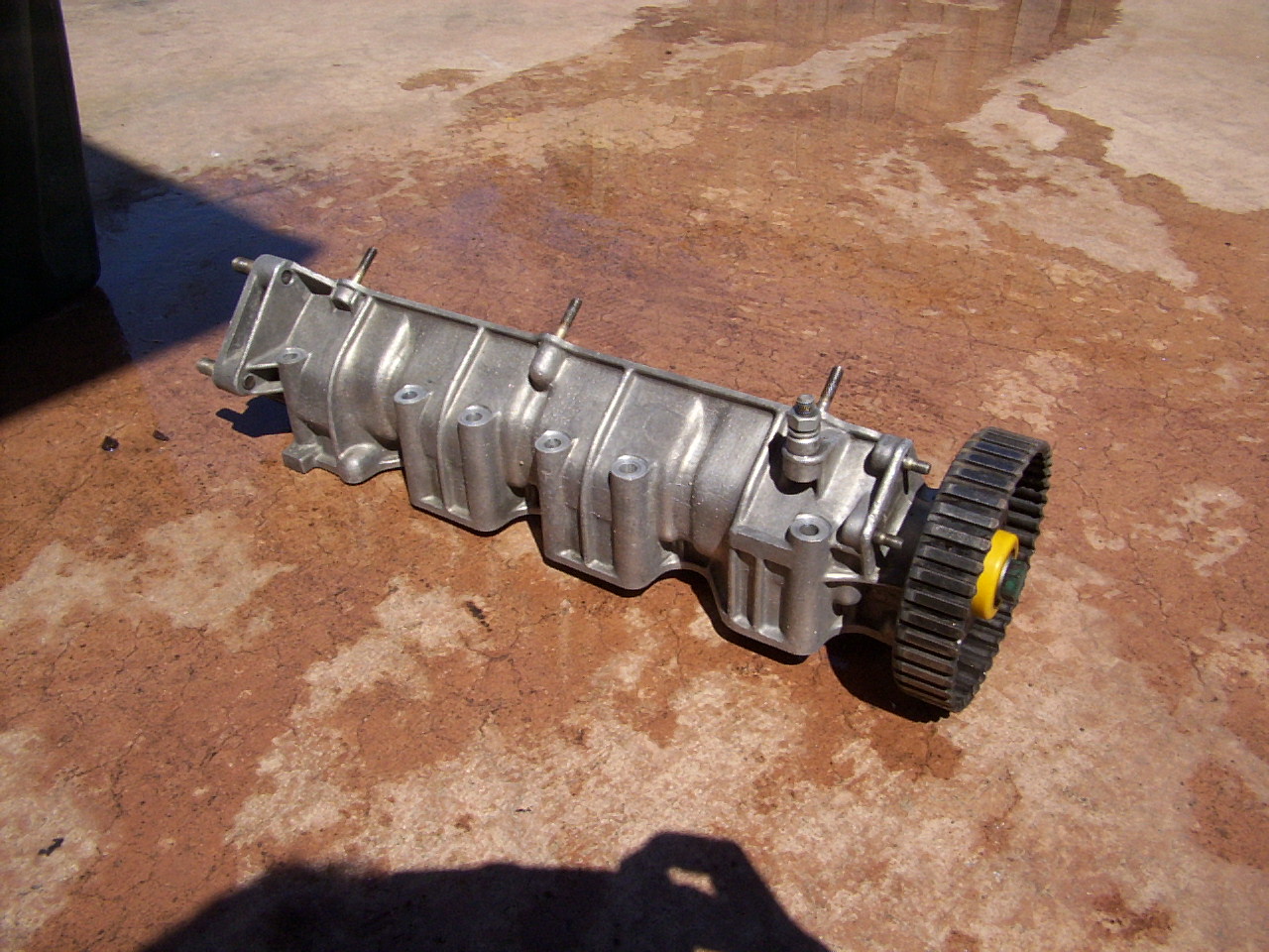

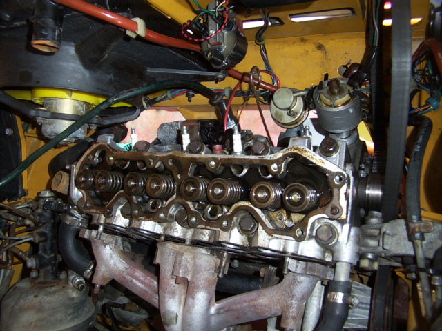

It would be a lot better if I had some pictures of non-FIRE engine parts to post on this thread. So I dug out a couple of pictures from olden days - this is an Uno 1301cc cylinder head fitted to a 1498cc motor. In the first picture you can see the thin paper gasket I was talking about (the camshaft housing has been removed). In the second picture you see the separate camshaft housing. If the top of your engine doesn't look like this, advice in post #2 won't apply (y) (I know yours does, Robin!)
