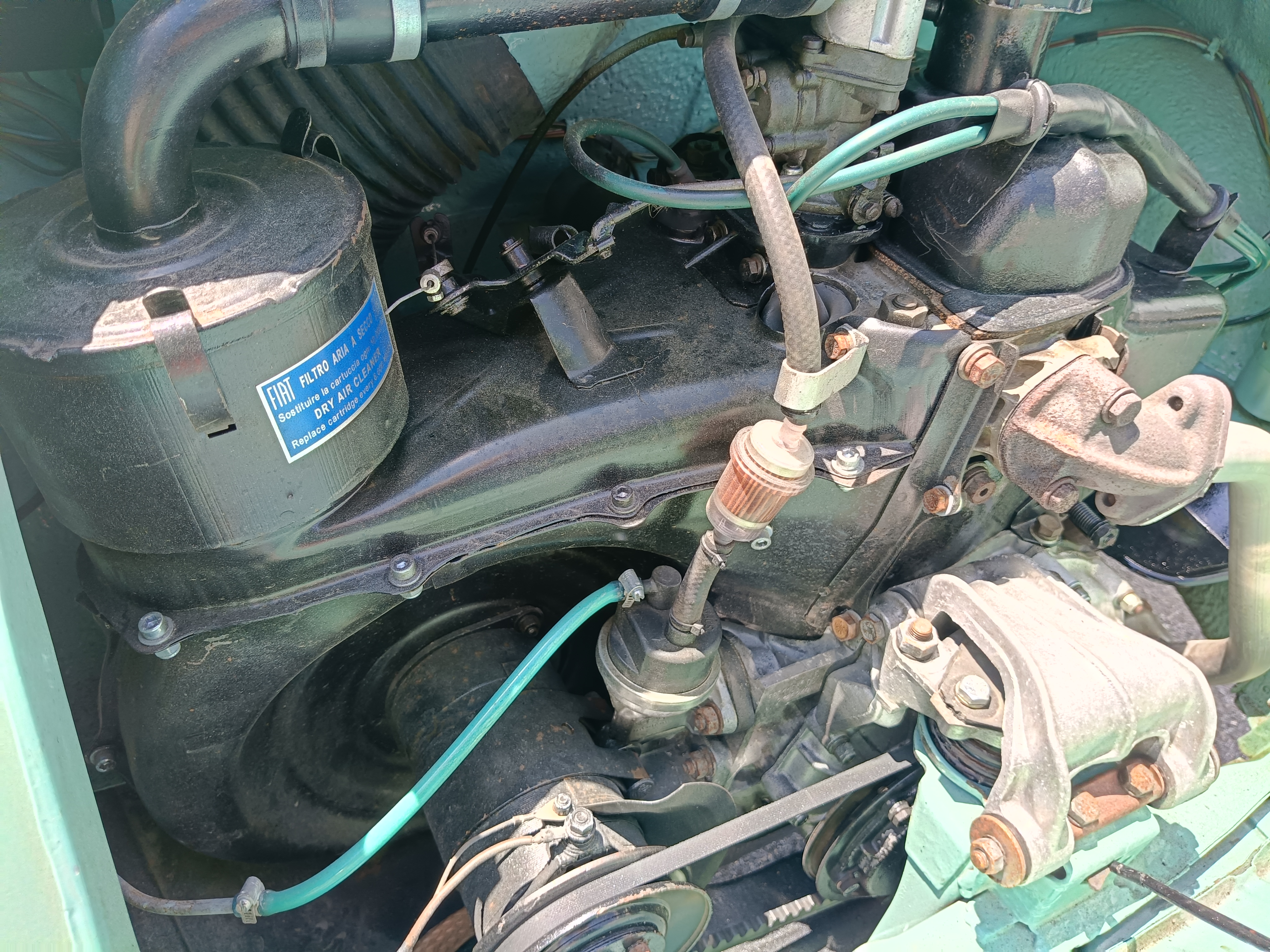

2) We have been driving quite a lot recently and sometimes on pretty bouncy and gravelled road and we are noticing that we have an oil leak from this part of the motor which I don't know the name (sorry I am not very technical). The leak seems to be coming from the top hose.

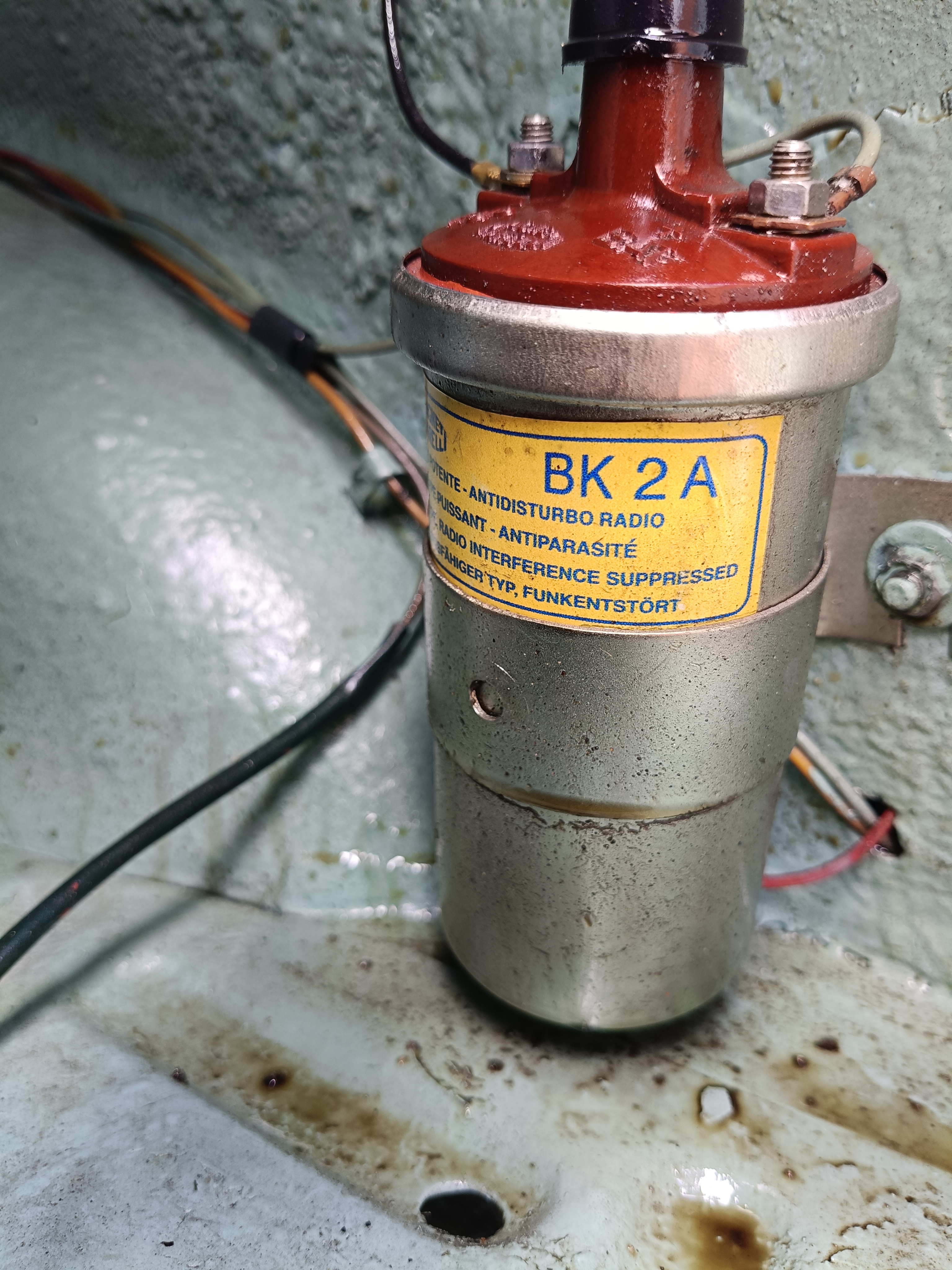

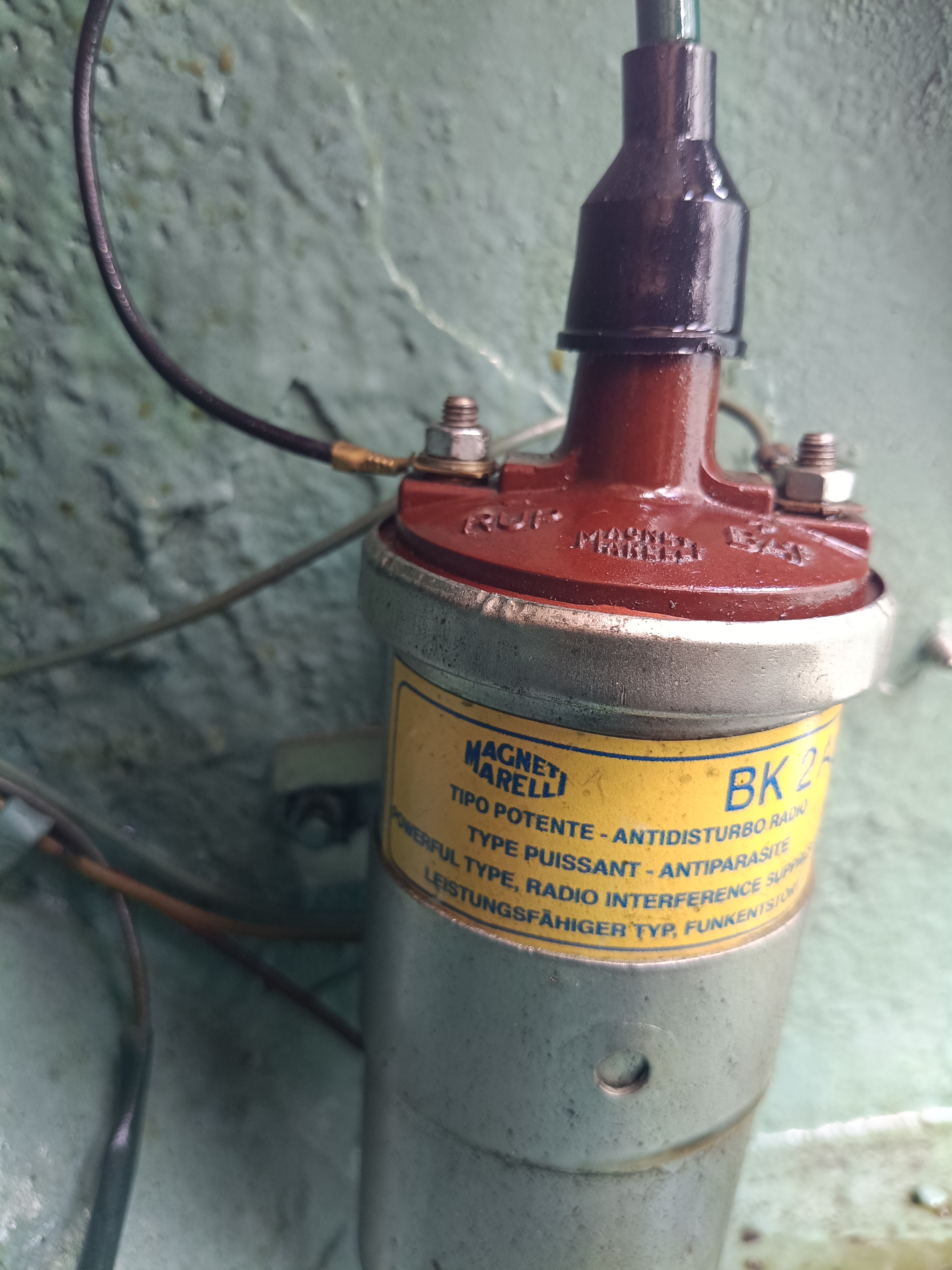

As said the part in the photo is the ignition coil, they are oil filled for insulation
The 'top hose' as you describe is the high voltage output cable. 😁 (it will pull out from the top if gently pulled)
Better replace the coil anyway as it's leaking, it'll eventually let you down. Easy enough to do.

The oil within the ignition coil is used to electrically insulate it internally because it's high voltage to provide spark for the spark plugs
Yes it can affect engine running and starting so best to replace it if it's leaking.,
Just order a new ignition coil and fit it yourself it's very easy
It has absolutely nothing to do with engine oil or the oil light on dash

As the others have said about the coil, I agree.
Your coil is oil filled for cooling but the fact that it has pumped out that much oil means that it has dramatically overheated forcing the oil out. The overheated coil also explains why you have hot starting problems when the coil is too hot.

Is there a chance oil is being blown out from the thermostat flap?, I say this as when you zoom in there seems to be some oil splatter on the top of the mail coil wire, if the coil was leaking it would surely be below the highest point. Also, there seems to be some oil splatterings on side panel that holds the coil.
Put some strips of white gaffa tape or masking tape on the coil and around the wall that supports the coil, bring the car for a good run and then have a look at the tape to see if there are more splatterings, simply running the engine I don't think with show you anything because at this point the oil will have misted.

OP, have a look as best you can at the engine from just above the dipstick, use of a mirror to see up and under maybe needed to look for evidence of an oil leak on the right hand side of the engine.

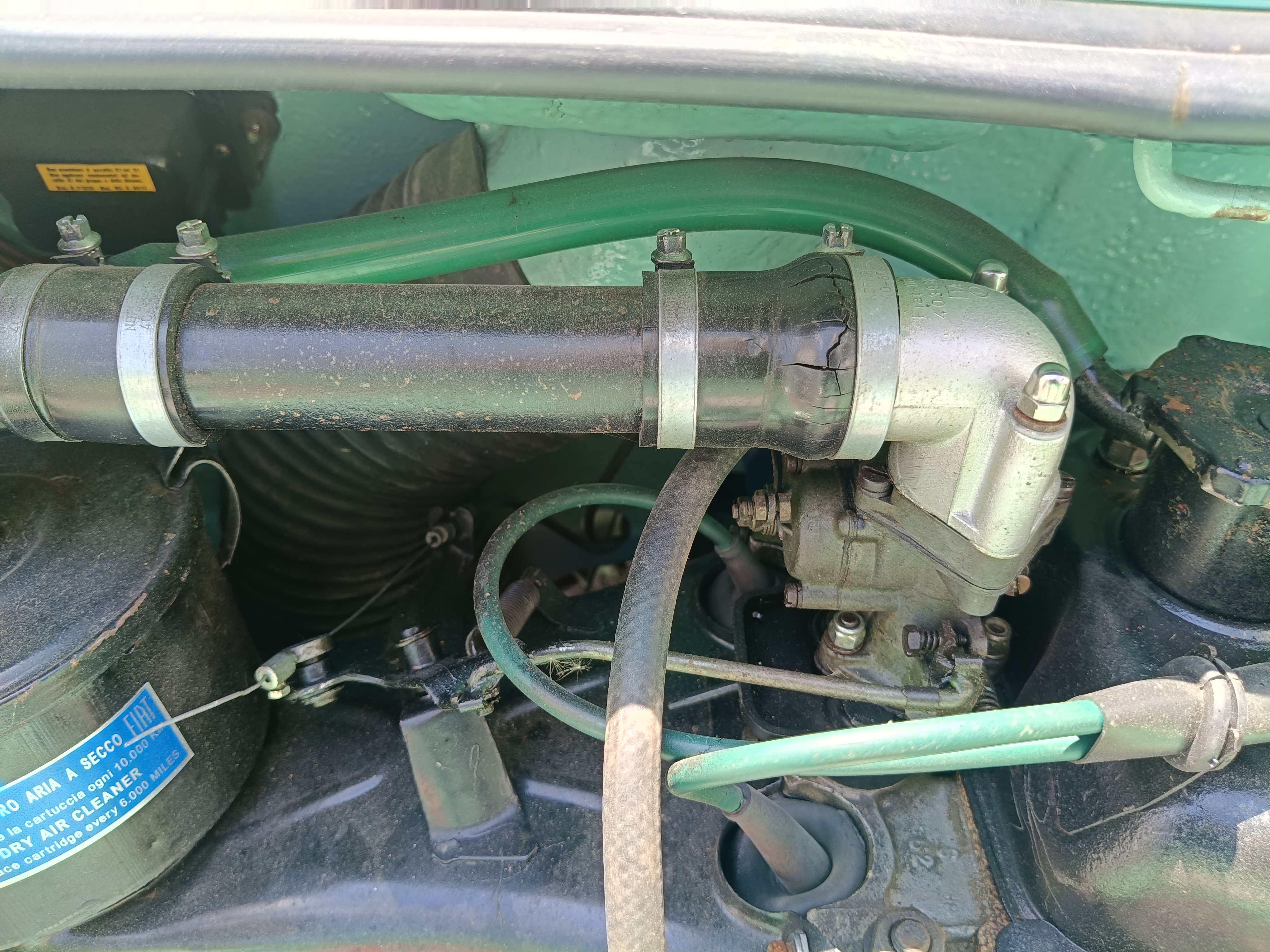

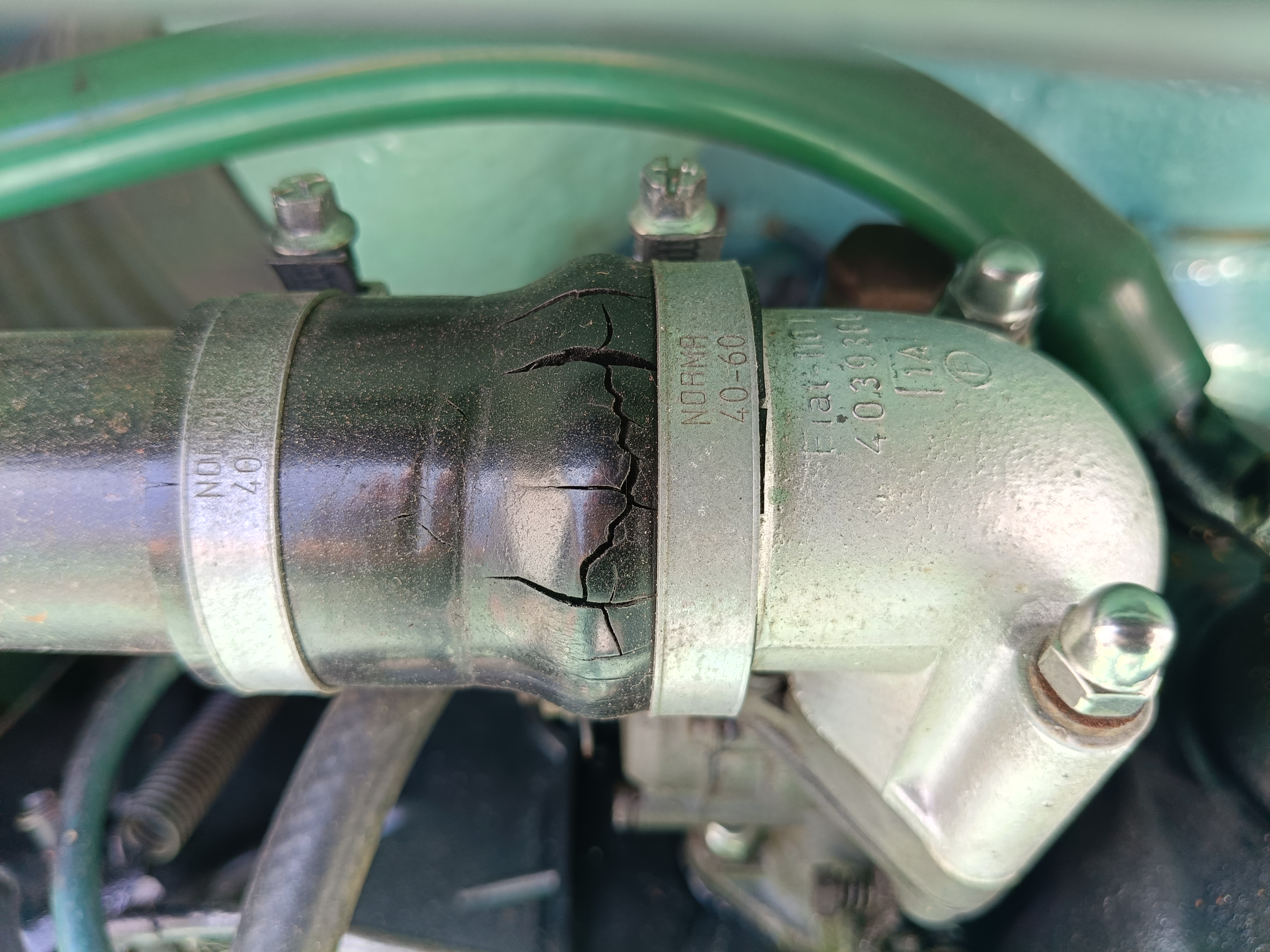

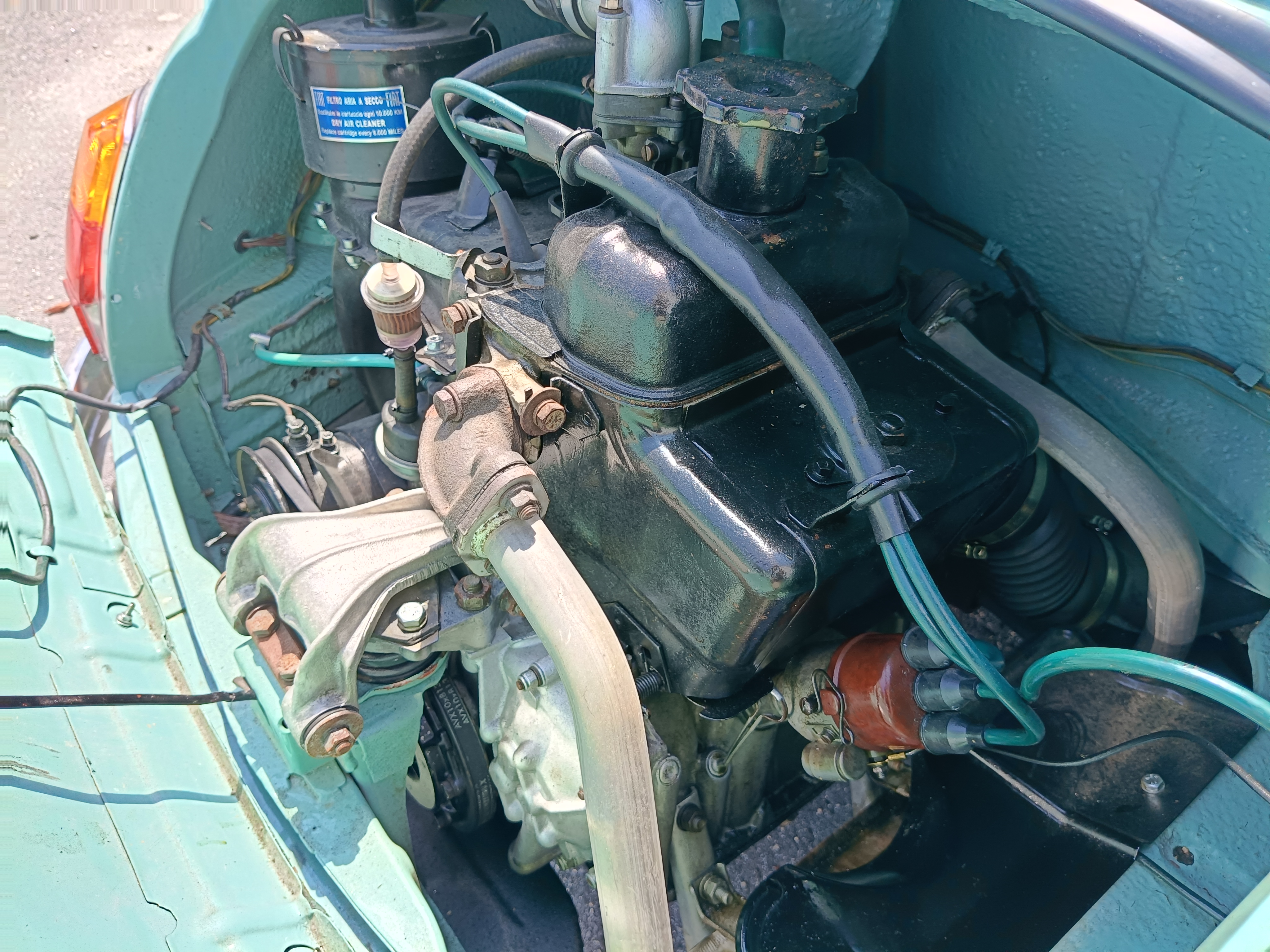

These are some photos of our engine. There's a cracked part, is that connected?

I can see the rocker breather pipe (green pipe behind the cracked one) , but I can't see crankcase pipage

I reckon that you have more chance of finding a mechanic who is prepared to (and can) work on older'classic' cars in Portugal than you are in the UK! I worked in a "Classic Car" garage for about 4 years recently, and the young apprentice was taught NOTHING with regard to Carburettors and 'points'ignition at College----he was lucky in that by the fact he worked in a garage that practically ONLY worked with carbs and points, he learned the trade from both sides (he passed his City and Guilds with "Distinctions"). We have the same problem when "Classics" are taken for a (in-required) MOT---the young testers do not have any idea about "Classics" and the fact that they were not deigned (or built) to pass today's exacting test. Some friends of mine (twins) have 5 'Classic' Riley cars in their garage---4 of them fully rebuilt and restored by them. One young tester refused to carry out the MOT because "the car has no brakes"---he just could not his brain round the fact that the car (a Kestrel) had "Rod and Cable" brakes, which in fact have been working very satisfactorily for close to 90 years!
Back to the oil-leak on your 500---a common place for them to leak oil, especially as the car gets older, are the push-rod tubes which run down the side of the engine that the distributor (and possible also the coil) sits at. IF this is where the leak is, it is not dangerous to drive the car, but you DO need to get the leak seen to. It is fairly major job as in order to remove the push-rod tubes and replace the seals that are on both ends of the tubes, the cylinder-head needs to be removed---definitely a job for a garage unless you are fairly "mechanical" and have garage where you can do the work in.
