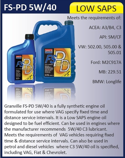

Number of manufactures have given it their ‘seal of approval’.
Can be got cheap in bulk.
Feedback on a guy who bought it on Amazon said the cap seal leaked on delivery.
Good to have additional choice since I’ve always struggled to buy 5w40 C3 oil locally.
