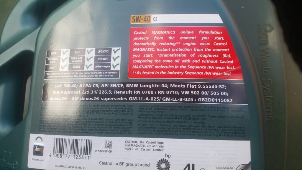

Hey Dan. I weirdly was researching this hard couple days ago. If u look in my posts I've done one asking about oil. But I have your car and ur looking for 5W40 C3. On the back of the oil bottle it should say fiat 955535 s2. But to answer you exactly castrol magnatec 5w 40 c3 is what you want.
No probs dan. I was just in garage and took a picture of the back of the bottle for u. If u look it says fiat 9553 etc etc. That's what u want to see on any brand of oil you choose to be compatible with out car. [emoji1]Thanks only just saw your reply cheers mate

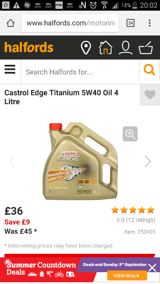

37 euros with free postage so can't complainthanks for the help

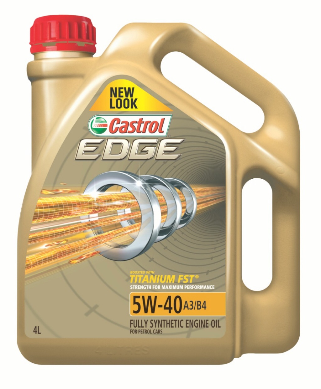

That's not a C3 oil, but A3/B4, totaly different specs.Cheers mate i ended up ordering this one View attachment 183804

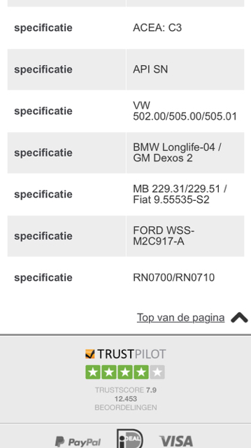

Yeah you need the c3 version.Yes it has the correct fiat number on the back, this is from the website 100% View attachment 183813
