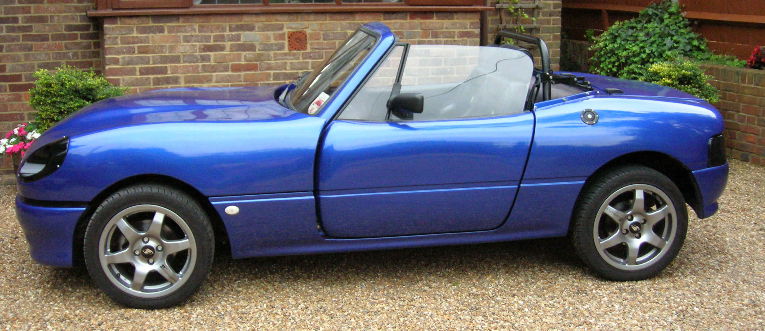

There was an earlier version of the car based on the FIRE engine (or maybe even the Panda) - attached is a pic of the car - deffo a head turner.
Peter
Peter
That looks like a mix of an Mx-5 and a Fiat Barchetta lolz :p
I like it (the styling), quite svelte considering the need to accomodate a FWD power-pack. :) I wonder how the weight compares to a standard Uno Turbo? The Turbo is the heaviest of the Uno models: 895kg for Mk1, something over 900 (945?) for Mk2.
As for the hoses, sounds like the best idea is to PM (private-message) Louie, then (y)
~Alex
I've never weighed the car but I think that the manufacturers spec quotes the weight at about 120-130kg (20 stone in old money) lighter than the basic uno Turbo - its a nice looking car that can shift when asked (did have a waste gate controller in there but it scared the willies out of me!)
It is very light :) you'd be amazed how much things weigh when you take them out - back seats, doors, tailgate, roof etc - quite easy to take 20 stone off the raw car.
