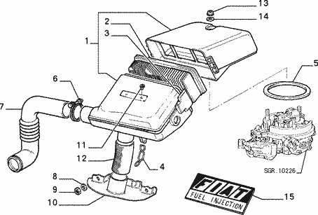

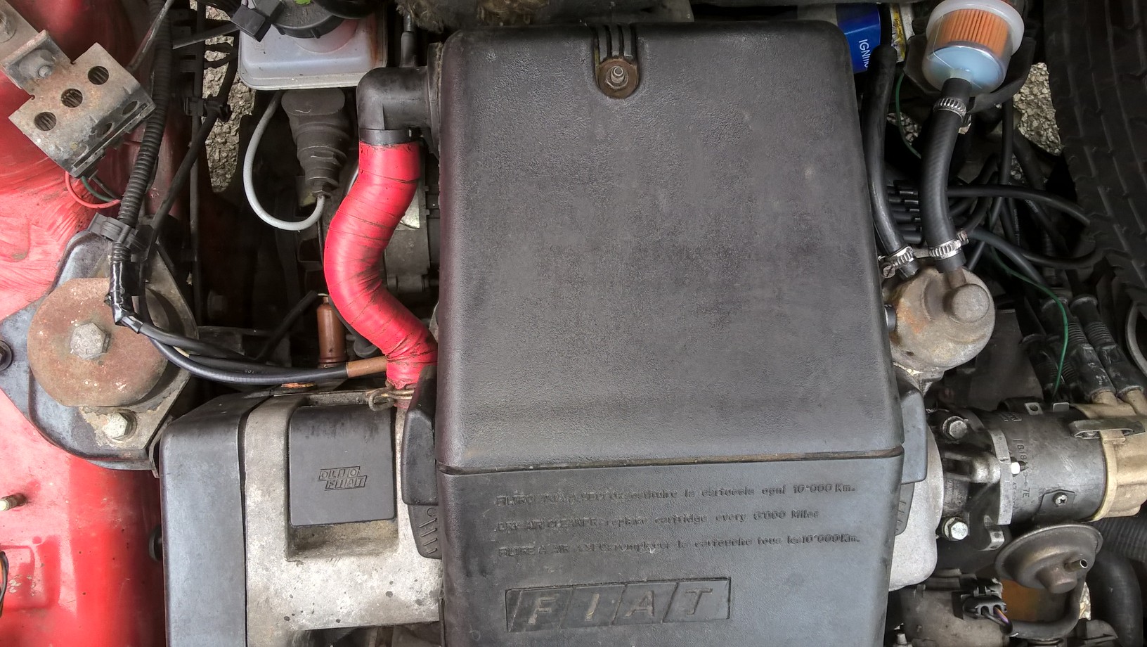

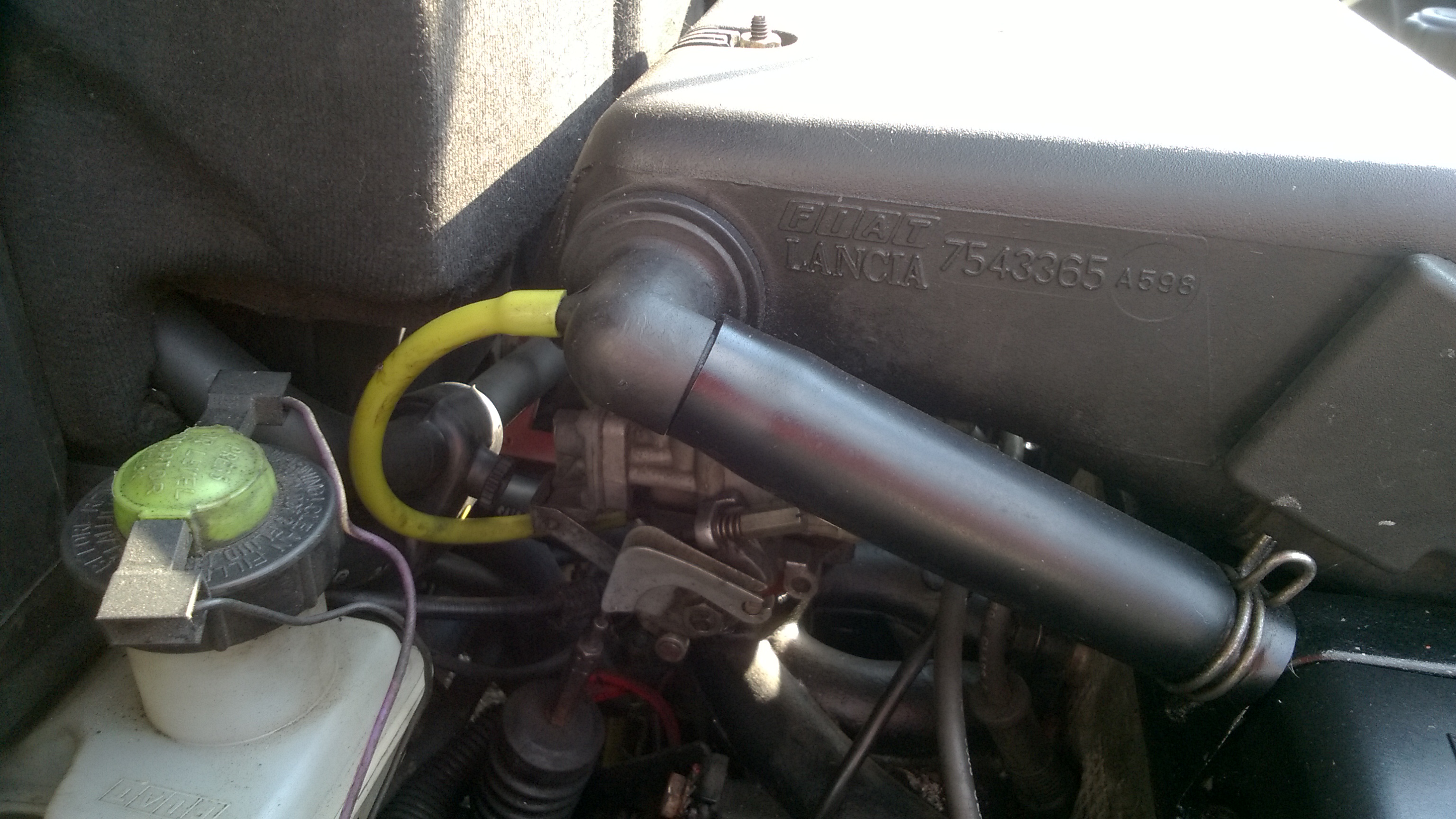

Typical. This is my airbox type, and of course, it's facing the wrong way(!) to see the pipe/box interface. Let's see if my pic of my airbox gets uploaded...the pipe in question attaches to the elbow you see at the end of the red-taped main breather pipe.

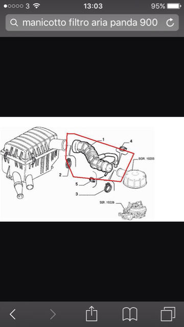

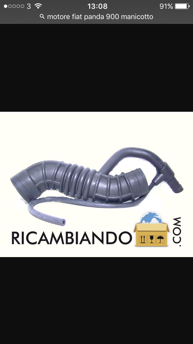

Thanks Lukmek, but mine looks nothing like that at all! I'm going to try take some pics and see if my keyboard skills are up to uploading stuff.
Ok
Let me know with a pic
I could source the part for you on eBay.it if it's cheaper
