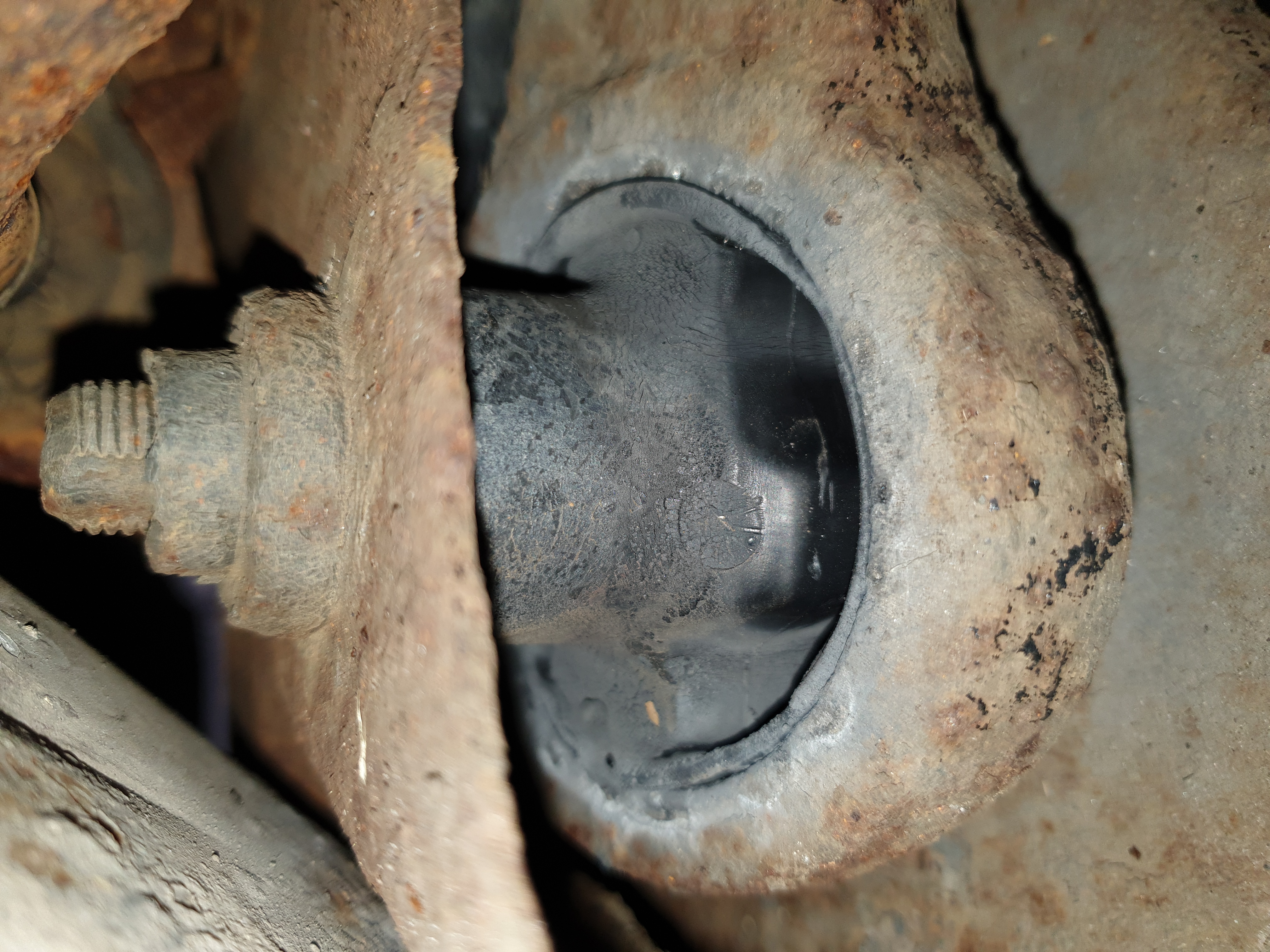

Noises coming from the front of recent, so jacked up and had a look. Think the knocking noises are coming from the ball joints (drivers side shown in first photo, but other side pretty much the same). Would appreciate confirmation from a more expert eye that the joint is knackered (which I think means that the wishbone needs changed?). Also found that the drivers side gator on the steering rack is badly twisted and holed - again assuming not good and needing sorted (second pic)? Other thing wanted to check is that the passenger side spring is properly seated (third photo) - seems secure enough but the end of it doesn't seem to be braced against anything? Also appreciate any comments on the condition of the big wishbone bushes (pic 4).

Well, from the photo's alone, the suspension needs a refresh that's for sure. If it was me I'd replace the lot. If you are doing the job yourself rust is going to be your biggest problem, plenty of penetrating oil & a source of heat as well.
The last picture looks almost the same as mine I would replace it until its making noises.
The rubber gaitor at the knuckle looks split so that pin could be the source of the knock, in which case a new wishbone would be a good call. Are your sure it's the wishbone though? Are the tyres worn on the inner shoulder? I've had knocks (even bought the new wishbones in anticipation) and it turned out to be the driveshaft.

Big wishbone bushes looks "okay" but they could just as easily be knackered. The key is how much movement there is in there. Since you're probably changing the wishbones anyway, then any excess movement won't be a problem any more.

I've not long put some nice new Continentals on all round, the previous set which had been on for a while weren't totally on the markers, but weren't obviously worn on the inside at the fronts. So, on balance think that maybe the wishbones will cure the knocking probs and tighten things up?
Btw is it normal for the bolts for the bolts to have a bit of "wiggle" room in the bushes, seems logical given that they are m10 and the bush diameter is 12mm/12.5mm, but just wondered, given that I had thought that you would want as little movement as possible (and that the last time I did the wishbone on another Stilo one of the bolts was solid in the bush and involved the gratuitous use of an angle grinder to get it away....).
Cheers.
The bolts aren't supposed to have wiggle. If the bush is ~12.5mm then the bolt needs to be an M12, not an M10. I wrote "M10" since I spent the weekend faffing about with a groaning track rod end (needed a new nut and some tightening)... but the wishbone bolts could well be M12. They're fine pitch, which is the main thing, if you want to order some new ones before dismantling the old ones.

Does this look like too much wiggle..... (these are the bolts that came with the wishbone its Febi Bistein make, supplied by Mister Auto). Tried to post a wee video but couldn't get it to load up.....

Those look okay. I remember my old Alfa 145 arms had the same apparent slack but I never had any problems with them, other than wrestling with the old bolts.
