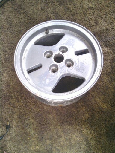

Been picking up Beta Montecarlo wheels from ebay as they are pretty cool and unfathomably cheap. The wheels are 4x98 bolt pattern 13" in diameter, 5.5" wide and have an offset of 25mm. The plan is to use the 155/70 that are already on the car. I did a search first and got only one direct mention here and its not clear if the guy ever fitted them
https://www.fiatforum.com/panda-classic/269961-would-these-wheels-fit-classic-panda.html

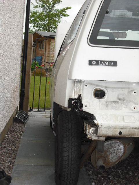

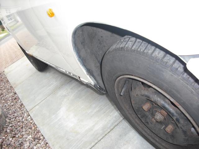

My only concern is the offset as the wheels will protrude more from the car than the standard wheels with their offset of 41. Do peeps reckon an offset of 25 is survivable with 155/70s on a 5.5j rim? At the back Y10s don't have a wheelarch lip in the same way a Panda does at the back so have included a foto that shows the relationship of wheel and wheelarch
Ta (y)
PS does anybody have one of these wheels. I only have 3 :eek:

Hmmm, somebody might just have bought a set of 4 today at Thoresby park on the cheap;) Don't know about these but the offset is about the same as the Cinq rims which are a common fit on Pandas.
I have Cromodora CD58s on the CLX (X1/9) and these have a 27 offset (5" wheels). With 155s on them they are just about legal on the front without extended arches though it's touch and go. The 25 offset may be enough to make it a bit iffy, though if you have 155s on them they will be quite stretched so you might get away with it. I believe that 155s are recommended minimum width for a 5" wheel so you will be stretching them a bit - though not in the comedy way! They might look a bit odd but if you put a wider tyre on them they will stick out a lot.
The backs shouldn't be a problem I don't think. I'm a bit worried that the low offset is going to wear the bearings out quickly but I'm prepared to wait and see on that score.

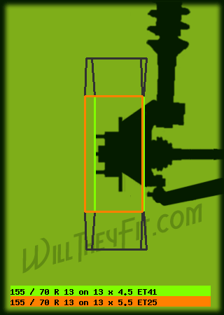

I checked a few online tyre calculators that seem to suggest thats its 155/70s on 5.5 j are ok. I got the image below using this site
http://www.willtheyfit.com/index.ph...2=13&wheelwidth2=5.5&offset2=25&Submit=Submit
It seems to suggest that while the reduced offset pushes the wheel further out of the wheelarch the wheels position relative to the suspension barely changes as the wider rim offsets the offset so to speak :eek: Would that then still effect camber and tyre wear :confused:

Good question. I don't know the answer; it's all a bit technical:eek:. It could be that the wider wheel creates less problems but looking at that diagram they are going to protrude a fair bit.

The low offset shouldn't make a difference to the camber unless you've got play in components that shouldn't. It might wear the bearings in theory, offset is all about how the load is applied to the bearing, correct offset will centralise the wheel on the bearing so there are no lateral loads unless cornering, the lower offset will move the centre of the load out of line with the bearing so it will be subject to a constant lateral load. In the real world though where corners are common and tolerances wide, 1cm out of line shouldn't be that noticeable.

As was said, a wider wheel can offset the offset and therefore give little or no increase in lateral load on the bearing, at least when going straight, cornering is a different matter but 5.5j wheels aren't going to be much of a worry.

These Monte Carlo wheels may just stick out of the arches with 155 tyres but it will be a small amount that may be sorted by rolling the arches a little.
