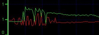

After telling me I had a rear lambda sensor fault, I did some reading and found this could also be caused by a faulty cat (manifold type from Fiat £420 :eek:). Anyway, I did a trace of the front and rear lambdas, see attachment (hopefully!).
The green trace is the second sensor. The first sensor in red looks good alternating around 0.5v (lower than that is lean, higher is rich) as it should. The green trace runs mostly rich and jumps around a lot more during driving (the first half of the trace).
I presume the second sensor should be a fairly straight line as the mixture should have been handled by the cat by then? I'm guessing that if the cat had failed and the second sensor was okay, both traces would mirror each other? Anyone know the answer to this? I also can't see how it could be richer than the first sensor says!
Anyway, I've ordered a new sensor as this one looks very erratic. Does anyone know a cheap source for cats if the sensor fix fails? Cheapest I've seen is £240 on E-bay!

dont think u have 2 lambdas, but i am not sure (havent seen any car with 2 lambdas).
What does engine do if stays stable? and does lambda still jump around ETC. Does disconnecting lambda make it better?
catalysator shuld cost about 30£ if u take universal i think... well at least here (in Estonia :D) we have universals(might be not as good, but i belive they do the work) about in that range.
do u have any leaks in the muffler that could ruin the lambda(data)?
looks like there are 2 sensors
