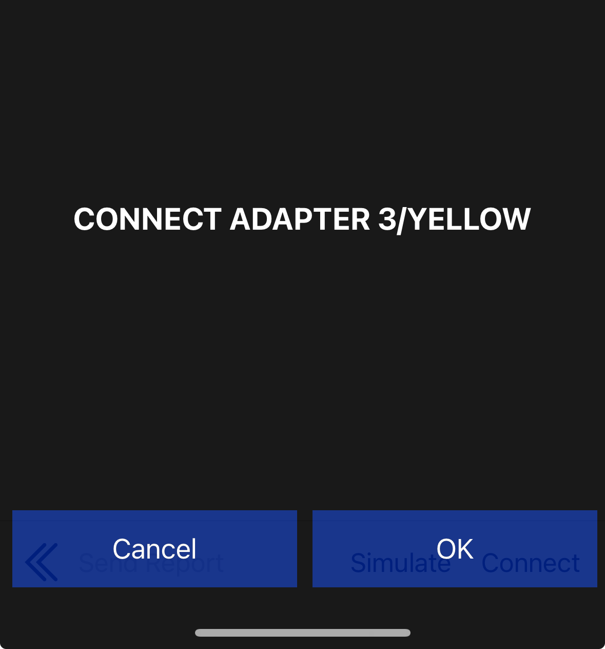

Simple. You plug the bluetooth unit straight into the car's ODB socket for nearly all code readings.
But, if (and only if) MES says 'use the yellow cable' then you plug the yellow cable into the car's ODB socket, and plug the bluetooth unit into the other end of the yellow cable. It really is that straightforward. I'll go and take a photo...

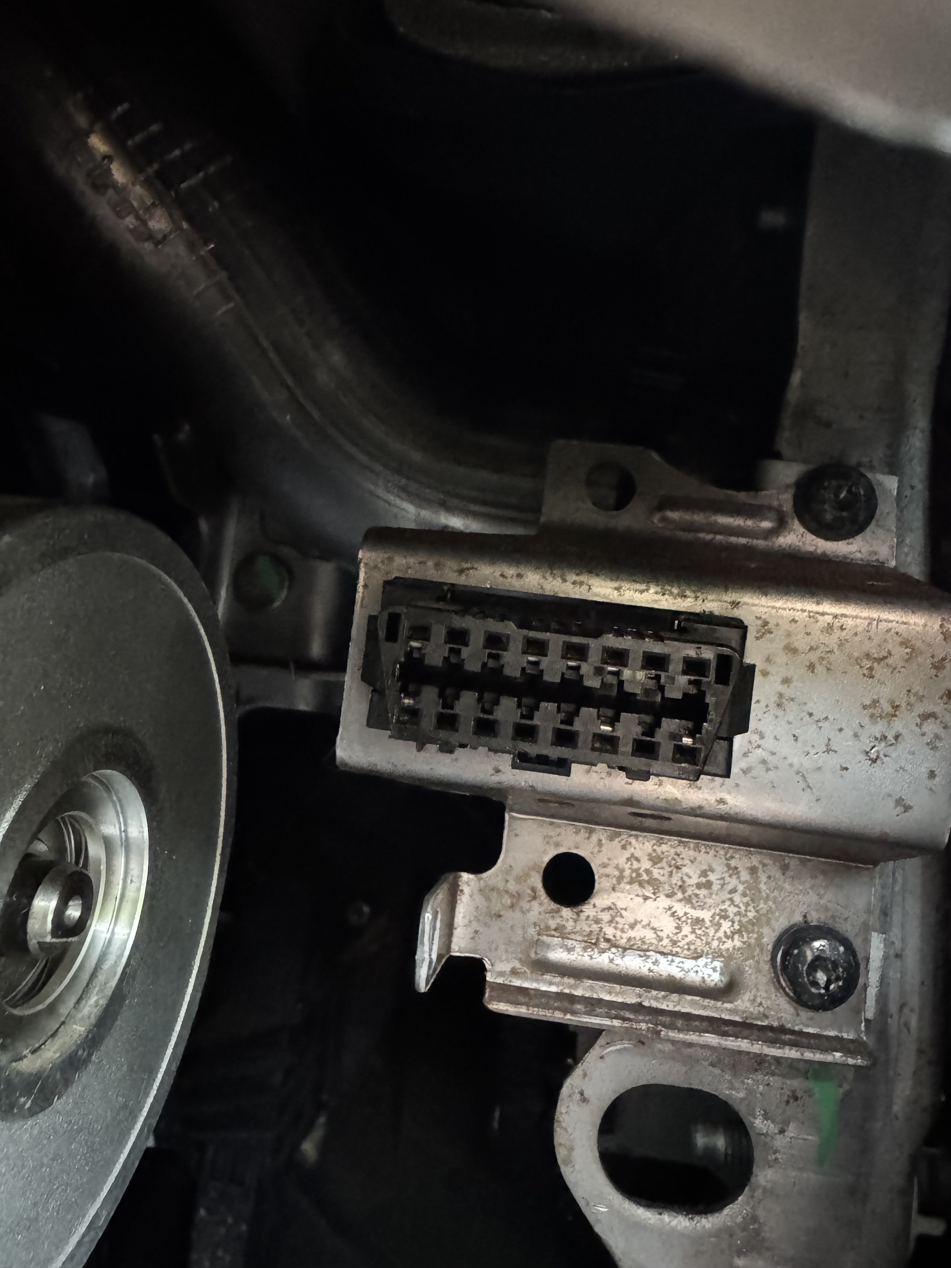

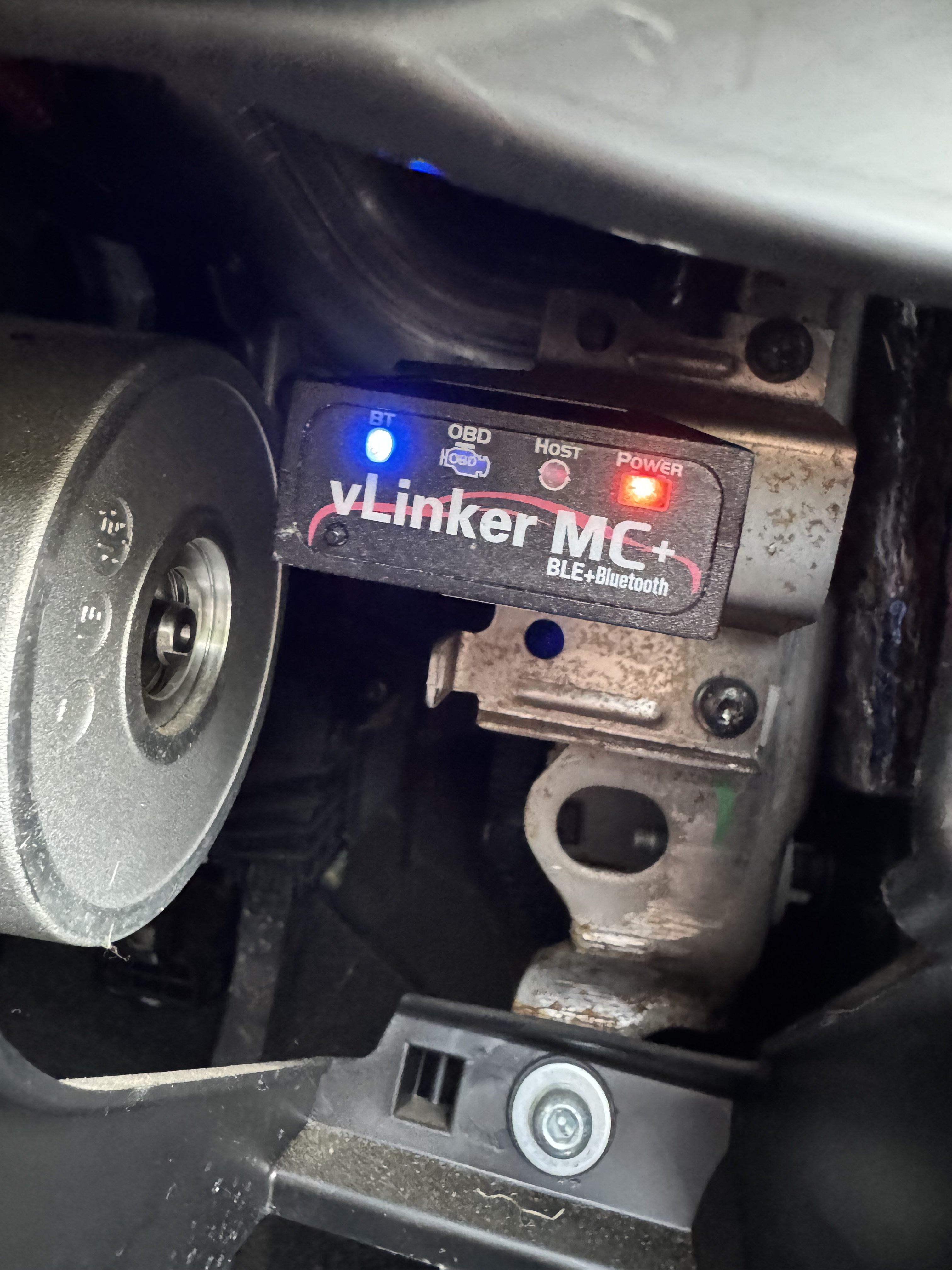

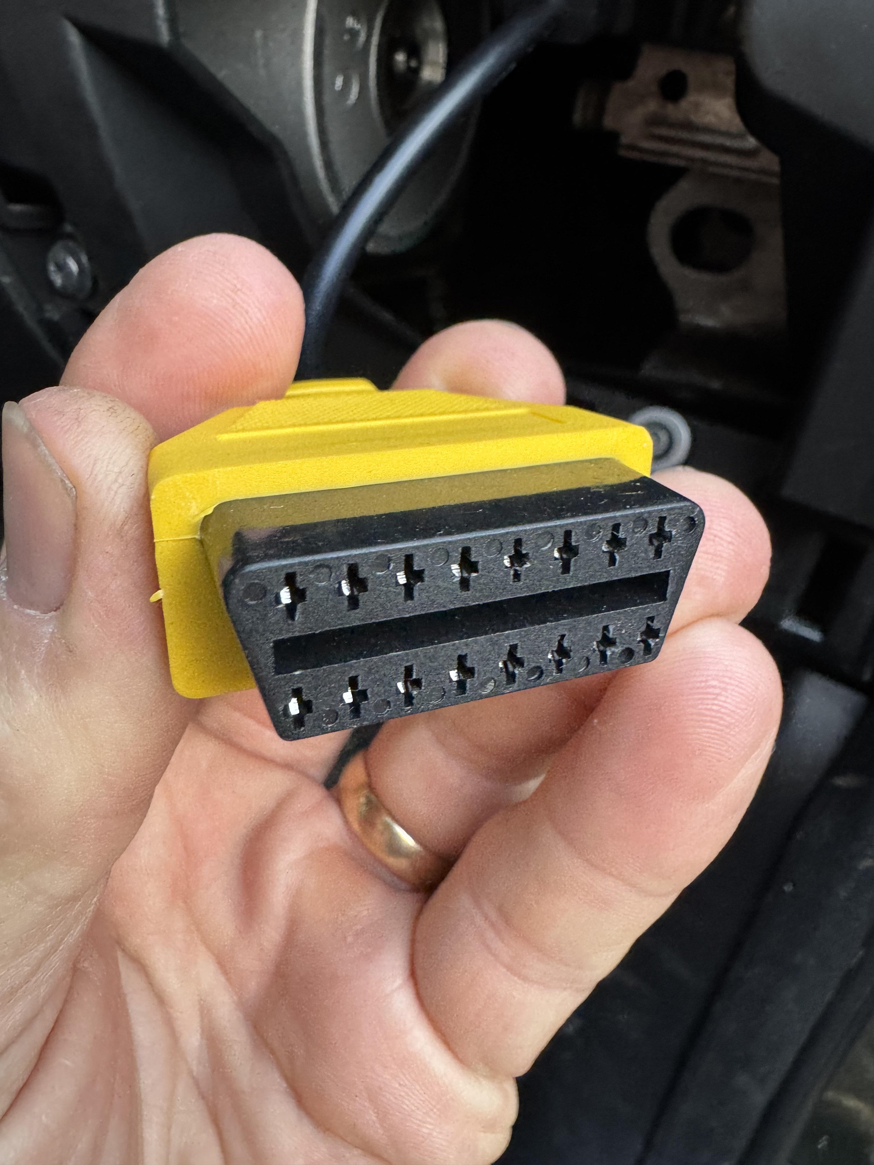

Four photos:
1 - the ODB socket in the car
2 - the Bluetooth reader in that socket
3 - one end of the yellow lead in the car’s socket, and the other end ready for the Bluetooth unit to be plugged into
4 - the Bluetooth unit plugged into the yellow plug
(Note the ‘yellow lead’ from Gendan is actually black: just the plug at one end is yellow)
