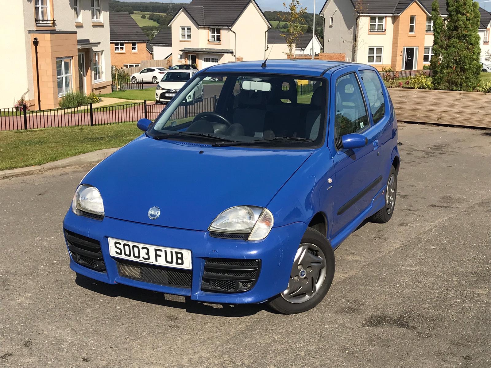

Just realised no pictures makes this a boring read. Car looked like above when bought
3f990b13-6097-4eca-a8c6-76b61c6b9288.jpgbdcab6bf-16ad-4b99-bae6-629fa555da04.jpg1e6e5d11-69c2-4696-ba6f-55791820b286.jpga20a105e-cfe2-45e4-becc-bbb60883b53e.jpgc5ce5cde-4806-4fee-b715-8d4c4cf23919.jpg8a3f28b0-a09e-4ac1-99bd-6902134ddb89.jpg
Just a few pics of it currently.

Nice little Sei! Not many around in that colour. Looks good.
