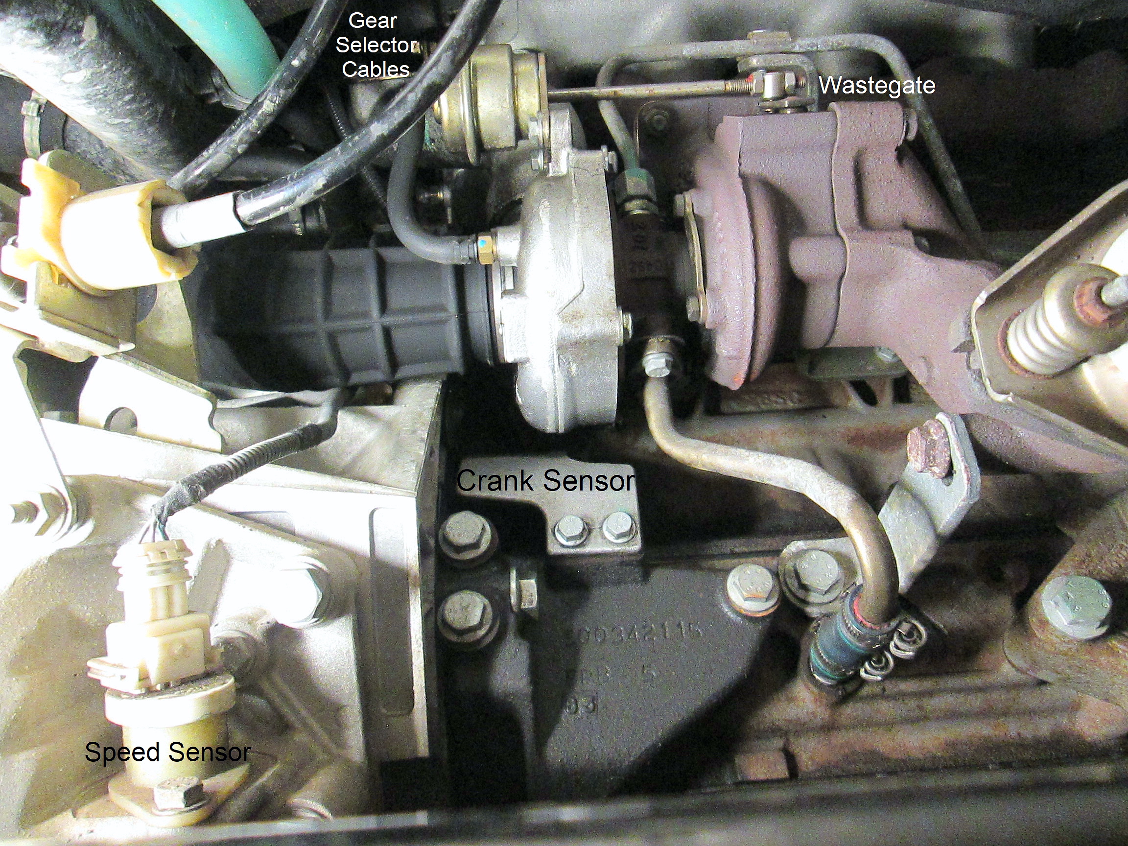

The red light when accelerating is probably an overboost alarm, caused by a sticking wastgate on the turbo. See attached photo. Access to the underside of vehicle is needed for access.

Great follow up reply thankyou.
I will look at this. I once tried to manually move the rod with pliers but it was not going anywhere so I sprayed silicone grease on its ends.
At that time I had red light with heavy acceleration. Eventually sorted itself out.
