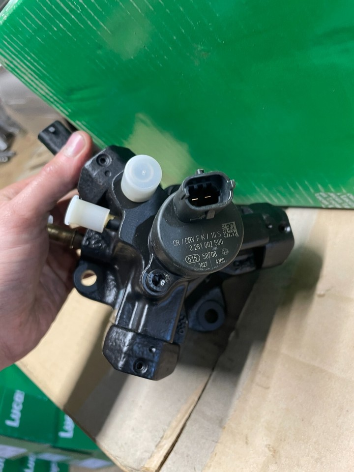

Photo below should be your pump and shows the regulator. Not sure if that pump comes off easily, the 1.3, 1.6 and 2.0 litre ones are mounted at the bell housing end of the engines in most cases and are a simply dog drive.

The one you are showing looks like the one i have but i cant see the shaft side of the pump

It may be worth trying to undo it and see if it will slide out as no timing points necessary on Common Rail pump. In the photo you can see there is no adjusting slots in the mounting points that secure it to housing. So if it slides out and for peace of mind nothing is moved on engine afterwards, you could mark it on removal. I suspect it will have a gear drive design from the older type pre Common Rail pumps as basically the same engine.

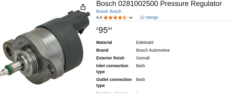

If your pump is the same as the one in my earlier photo, this regulator matches that number, not sure if that is your problem though as you have tried another.

Must be an early hp pump if it has pressure regulator like that one .
I think Bosch called that cp1 type pump.
The other electrical bit is a third piston deactivation solenoid for when engine under light load.
