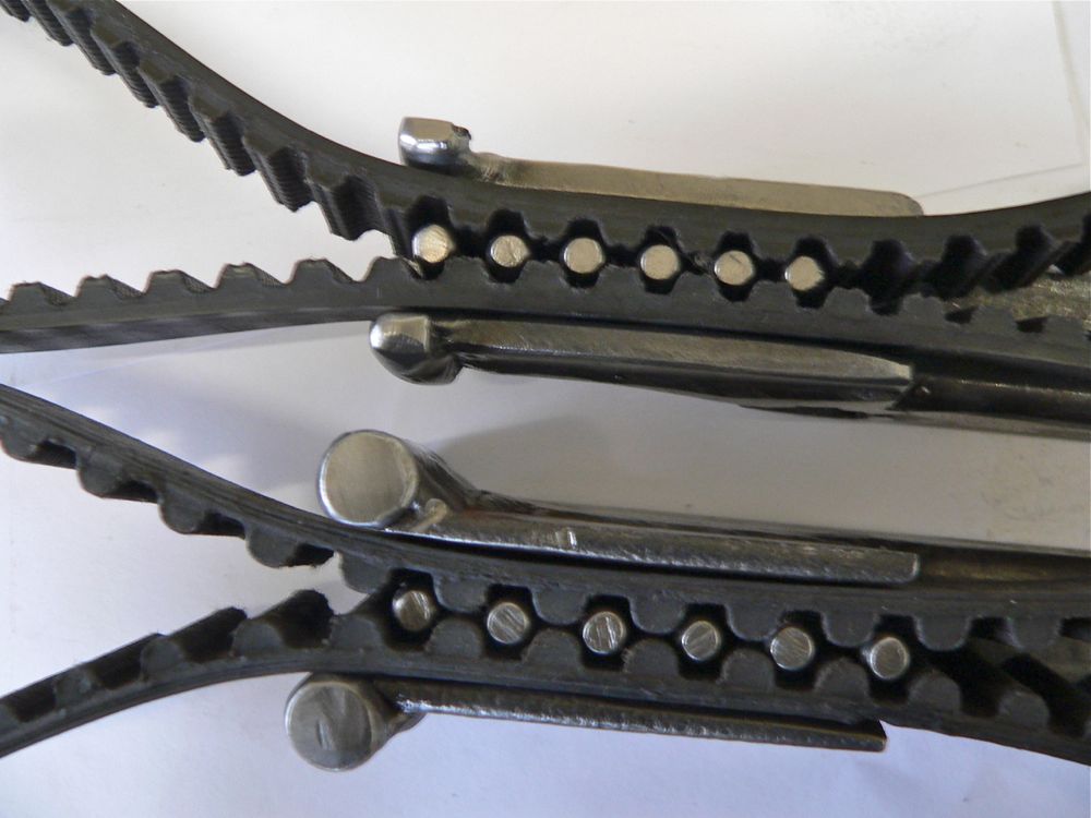

As a parting shot, I found a good use for old cambelts. They can be made into a very good strap wrench
attachment.php
attachment.php
