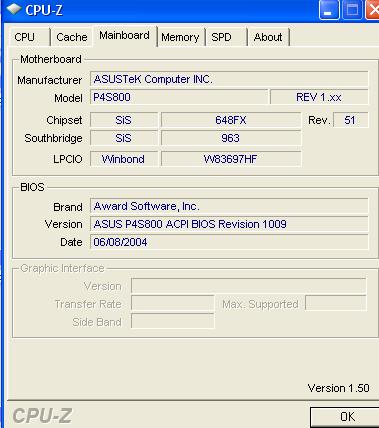

in device manager it tells me: "This device is not configured correctly. (Code 1)"
how do i ID what it is so i can get a driver?
no way of ID'ing the mobo thru windows?
