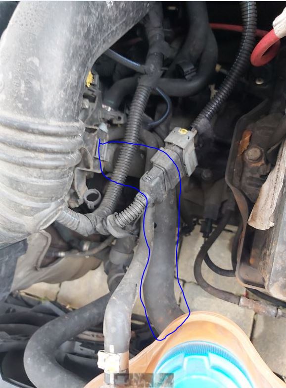

I have a problem with a clogged heater core. The bottom hose to the heater core is hot, and the upper hose is ice cold... But my question is how to fix this?
My first thought was to find the two hoses that go to the cabin from the engine bay area, but I couldn't do that. I have LPG installed on the car and the space is tight and too many hoses... can someone help identify the heater hoses? The car is a Grande Punto 1.2
If I remove the two hoses inside the dashboard, I guess all antifreeze will leak out. Also, I don't want to drain all the antifreeze, the temperature outside is very cold, don't feel comfortable doing that on parkin lot and I don't want to deal with airlocks
