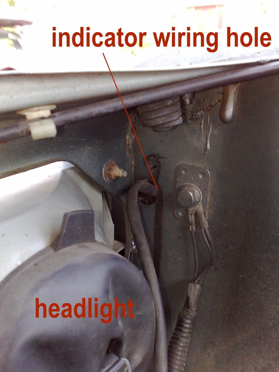

Something else I just noticed when I went to take the pics for you, the indicator wiring passes through a small hole in the inner wing, mine hasnt got gromets in either & it looks like its always been like that, check your wiring isnt damaged or shorting out there.
