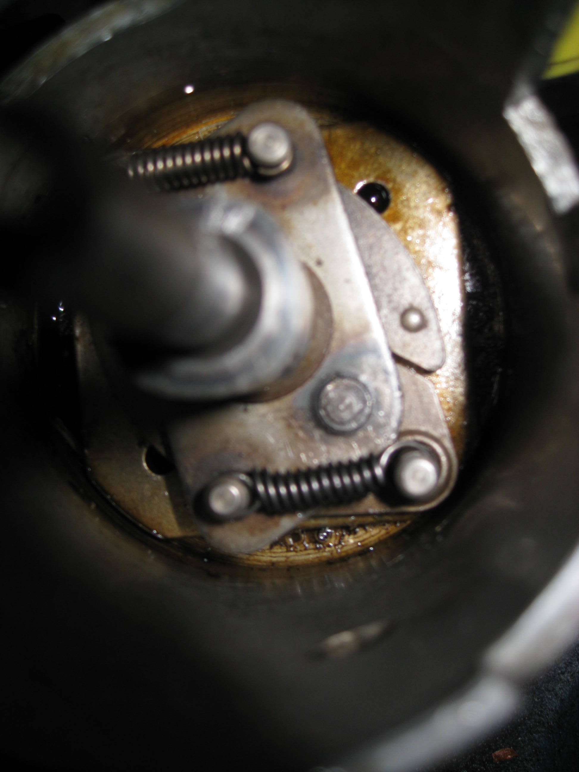

the bob springs ive just bodged back into where the originally were (i bent them by accident earlier on) im in the process of finding some new ones, but could it be them causing this problem?

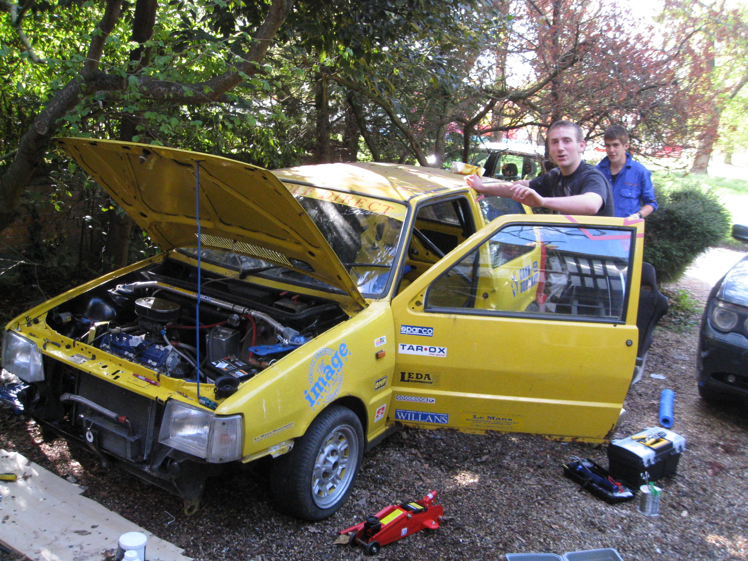

Nice pic (y) Who's that shady character in the background?
Also, those are classic Cromodora wheels that belong on my 124 Spider. They pre-date the Uno by at least ten years! You could probably raise good money by selling them on eBay :p

in the foreground is my mate louie - hes a petrol head on a similar scale to myself -He owns a pug 309 gti and jago jeep, soon to be swapped for a 1980s mosquito kit car!
background is Matt B - a general electrical wizard and chief instruction manual reader :D
haha! ive had a few questions about those butt ugly things :D
yeah i found out they're 124 based, they're magnesium too i think, they will be on ebay as soon as i can convince the old man to give me the MK1 strada 130TC wheels sitting in his shed! :p
