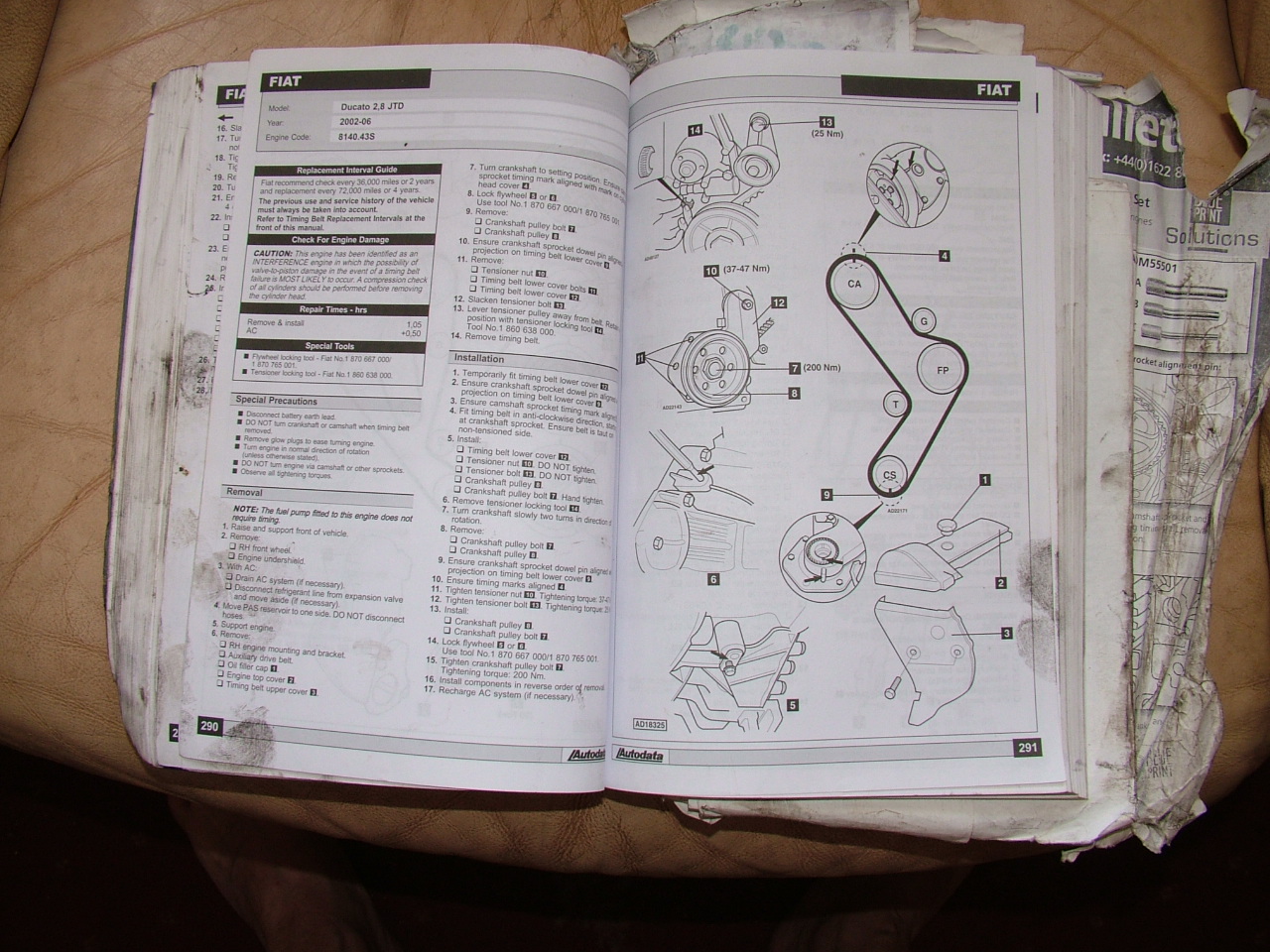

It is quite straight forward, but take special note of the stepped washers on the cover as if wrong can affect cam belt tensioner security with major engine failure!!!
