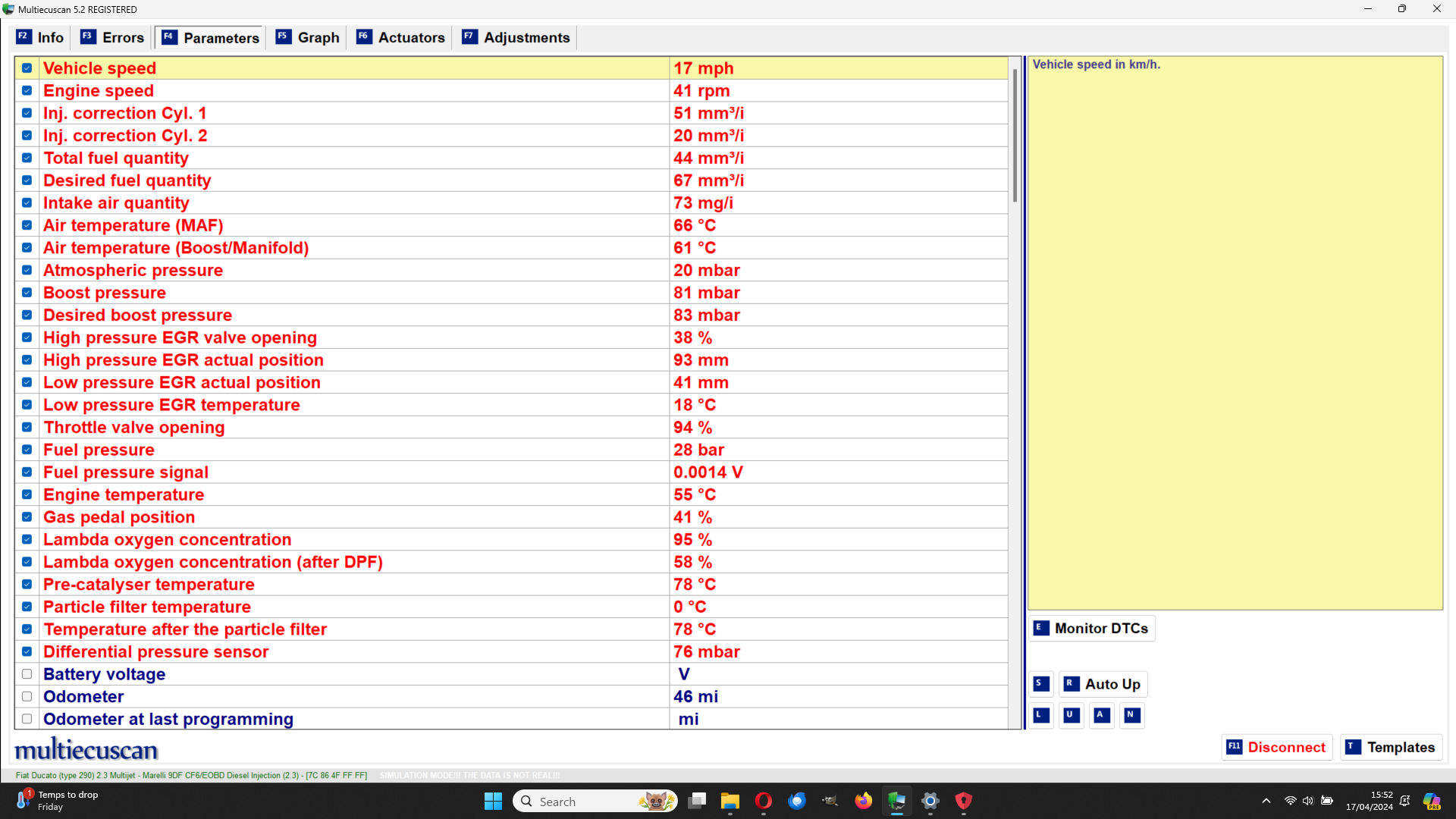

Hi guys, I've just joined the group as I'm having some issues with a Ducato twin EGR minibus that I've just purchased, P041 and limp mode. Although the garage is taking it back in to resolve I'm curious to see if it's a problem model.
The forum explains how the system works and from what I understand the big issue is understanding the fault codes can be very misleading. For example the garage replaced the EGR as per the fault code before sale, yet within 300 miles I have the same problem.
I've purchased MultiEcuScan but still in the learning phase.
I suspect I have a blocked intercooler, a detachment of the intercooler sleeve from the throttle body (outstanding Fiat recall) or maybe need the ECU updating as it has never been done (2017 manufacture).

Thanks for that, I'll give it a go. I paid £15K for the van plus another 2K on some adjustments. The seller has arranged for my local garage to do the repairs at their expense. As this will be a long term van I'm interested in preventing future issues. I'm already 2/3 through your mega thread, very interesting.

It wouldnt take a betting man to say you have a serious problem, given the correct data i can be certain. Well come back to that.
assuming you have the problem to solve it will require
new DPF
cleaned or new LPEGR cooler
cleaned or new air intake manifold
cleaned or new HPEGR this may not be required if it has just been replaced (this not normally required but a clean is not a bad idea)
cleaned intercooler
possibly 4 new injectors
We need to see results of the exhaust wipe
Template 7
Take results from cold and then a 20min run prefferably a 60mph blast after 10 mins warm up.
check for error codes before the run and take a screen shot of each error the results of a P0401 are extreamly usefull (see guide). only clear error after screenshots. (

Thanks. Were do I find template 7? It will be interesting to see the results. Sorry I've just realised I can do it manually from the image you posted, I thought it was something I had to download.
@Fredastaire
@theoneandonly
Sorry I'm just getting to grips with the software, a steep learning curve as I haven't done this type of thing for a few years.
I'm getting some soot when wiping the exhaust but nothing sticky, suspect the DPF is cracked.
LPEGR Temperature is not rising much, rising to a maximum of 50 C.
LPEGR Valve seems to be working okay between 0 - 5.0
Injector variance seems to be within tolerance.
I've just attached a couple of images for now.
