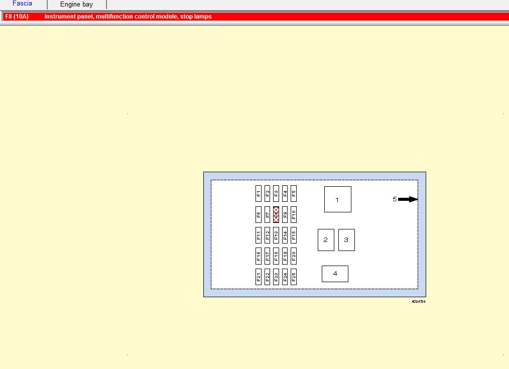

hey, just got new fiat punto (its old but new to me)
1.2 petrol 53 plate.
The speedo and fuel gauge dosnt work, no lights and no movement.
Clock and millage work and all other stuff seems to work.
Got told it could be the fuses but no idea which ones I would change to try, any one got any ideas
Thanks
hi ive had alook and this is all ican find,
fuse is located inside car in fusebox above drivers knee,
see diagram here,
thanks, I will go get that sorted today, fingers x its that and nothing major
