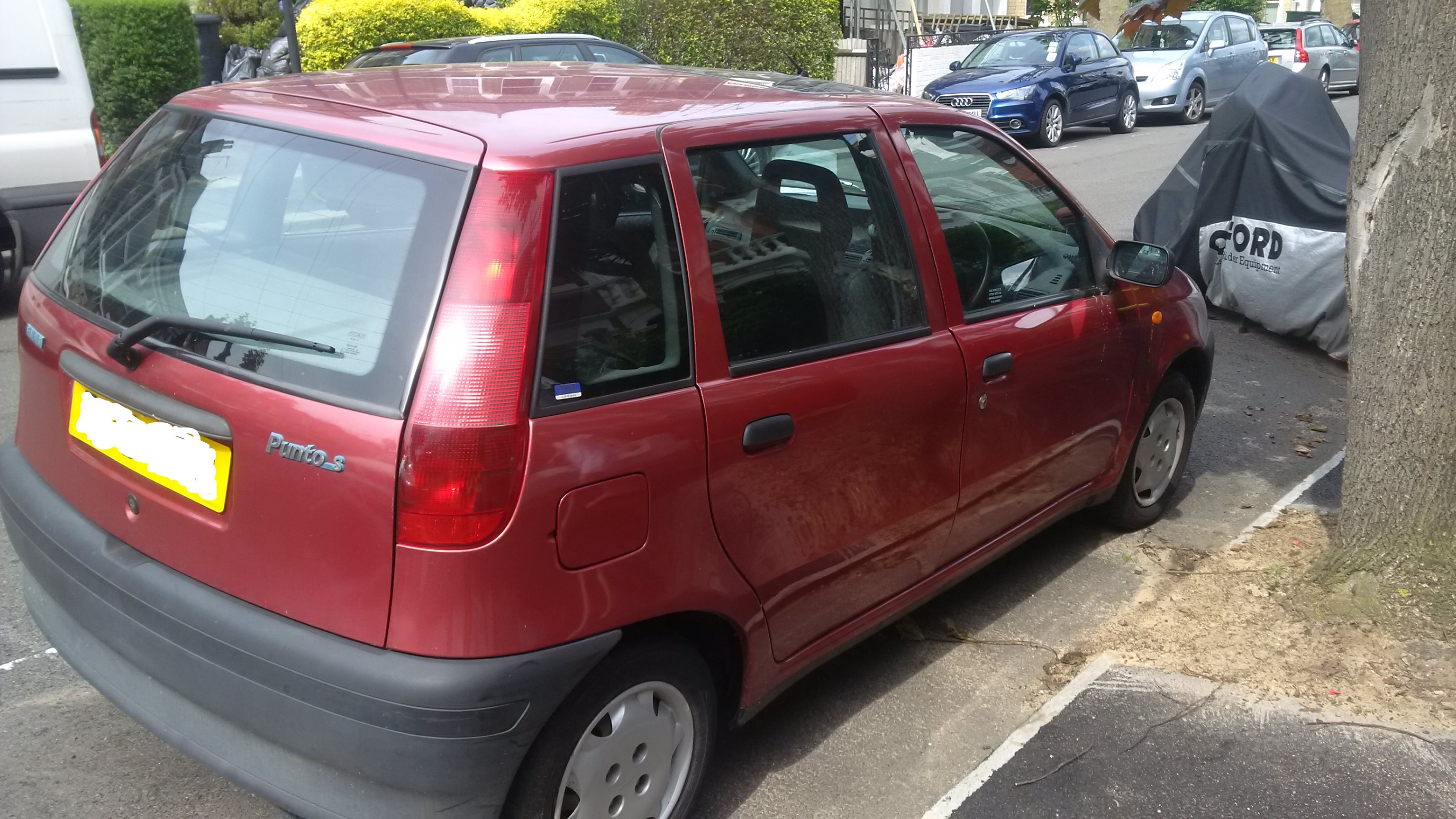

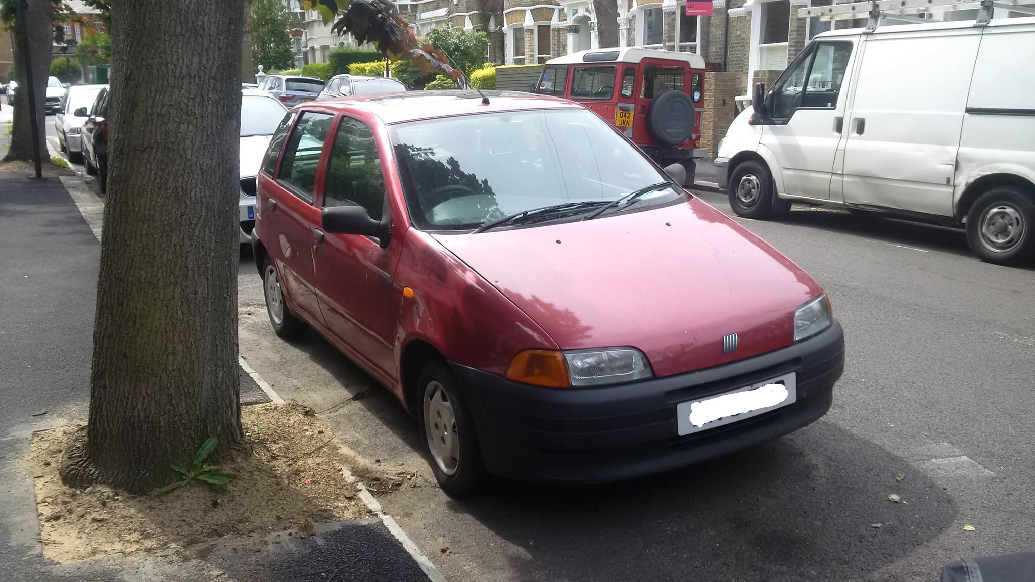

Thought I’d introduce myself (and my car).
A few weeks ago I picked up a Punto 60s 97’ as my first car :)
Now, get out the pitchforks if you want chaps, but when I first bought the car I didn’t really think anything about it. For me it was just a way to get me to my new job and back. Around 70 miles a day round trip (roughly just under 30k for the year). As it is only a year long contract – I was just looking for something cheap and cheerful to get me there.
However, you’ll be pleased to hear that after driving it around for a bit, I’ve really fallen for the little barstad and I’m having a brilliant time with it.
Picked it up from the local garage. Previous owner was a man named Mr Giuseppe who sadly developed Alzheimer’s and so could no longer drive the car. It’s ‘only’ done 55k, and apart from a few niggles it’s in great condition for its age.
I’ve had the timing belt and the water pump replaced to be on the safe side.
(After getting the old belt off the fibres were beginning to show – glad I got it done really).
I’ve also changed out the rear speakers as sadly one of the original ones had a small rip in it.
I’m planning on keeping the original stereo – I think its cool.
As some of you here will know the 60s is rather sparse in terms of creature comforts but I wouldn’t have it any other way. I love the ‘feel’ of the car – it’s the beauty of old things really.
Not sure if all the 60s ‘s have a sun roof but mine does (not electric of course!) which I think is very cool!

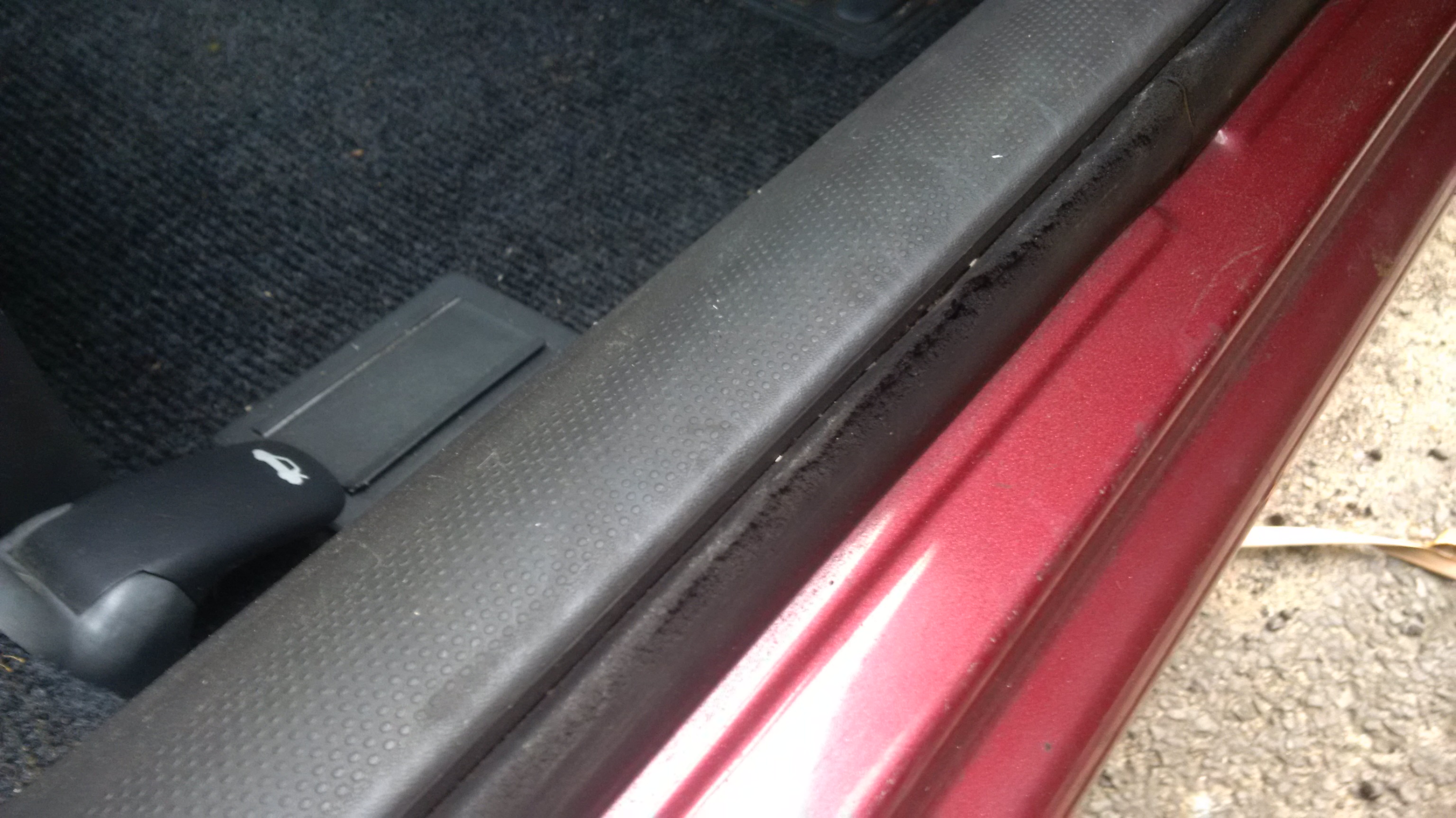

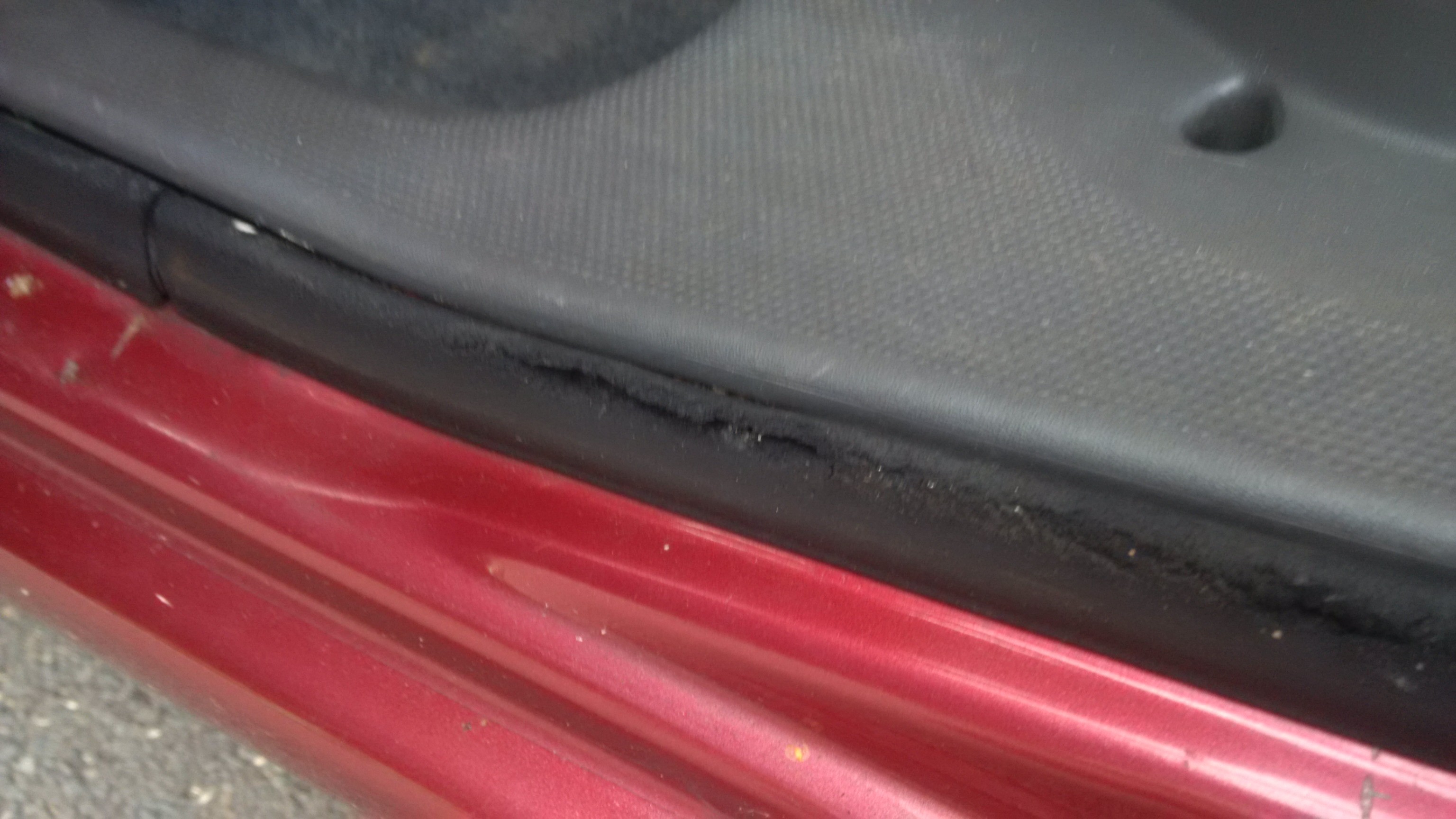

1. Get the rubber door seals replaced/fixed – Forgive the noob question but are these easy to get hold of? Is it worth changing them – there’s no water getting in at the moment.
2. Address the paint peeling problem. Any suggestions?

The peeling lacquer is a paint job unfortunately.
If i remember correctly the door rubbers just pull off and push on so easily changed- sourcing them may be a different story.

overall looks to be a decent mk1 you found there, shame about the lacquer peel but its seems part of the course for all the metallic painted mk1s now. you can try fix this yourself, it prob won't be perfect but would stop it getting worse - check out vids on youtube is always a good way but essentially you need to sand it back a little bit with high grade wet&dry and then apply fresh clearcoat - its super hard to make it look really good up close but its doable to get it looking better from a distance. Really though its do a whole panel or preferably the whole car. So expensive unless you have a mate who does car painting.

Door seals, as said, easy to swap but perhaps hard to source, depends how much it annoys you really - probably source some less degraded ones 2nd hand without too much hassle.
