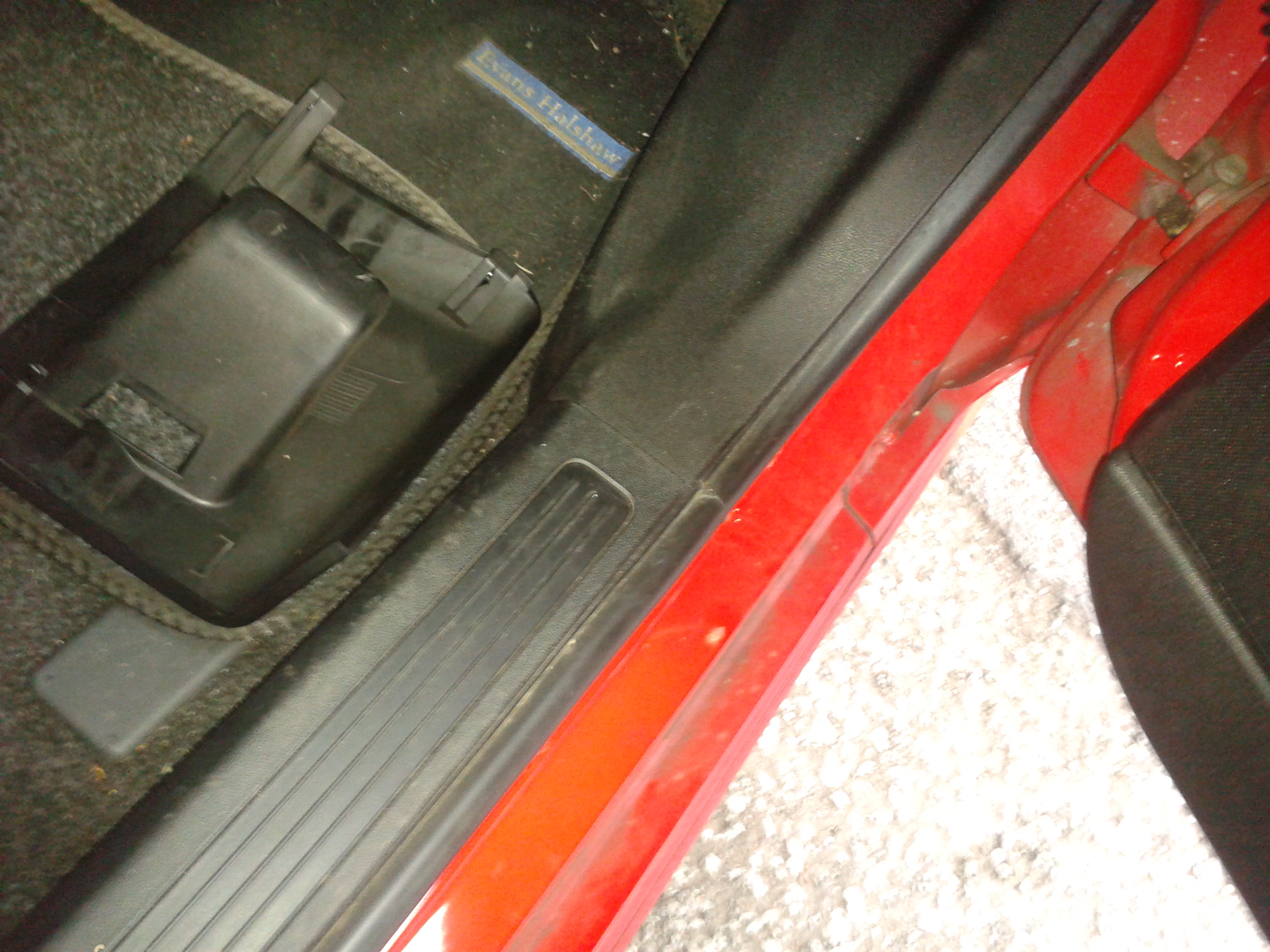

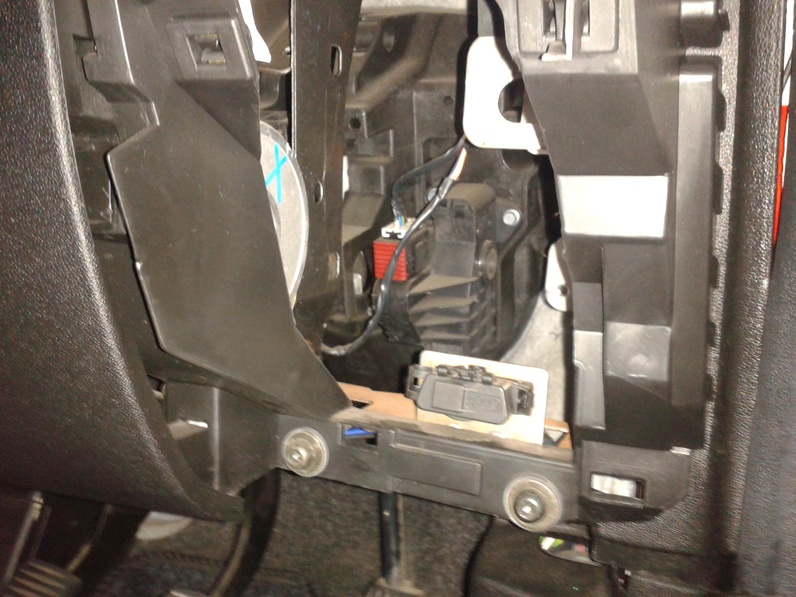

Right, sorry for posting yet again but can someone advise.
Iv looked but not sure:
So i can get inside and feel the gromit from the inside, but how can I possibly work around this?

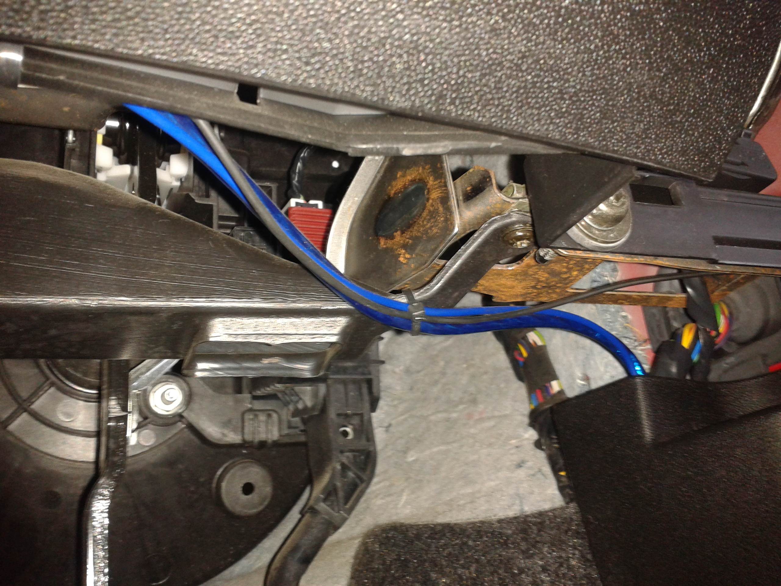

Current wiring goes under here
Current wiring again, im going to follow the same route but i just dont know how to go through the existing channels to the doors.
sorry not been on for a while right i eddited a pic for you
where the arrow is there should be a screw around there and one in the rear of it by the seatbelt rail then the highlighted panel just pulls off just do it slowly the that is drivers side the second part has two crews one under the fist pannle and one near the fuse box u will see it after u undo the first side
that may make it all clear for that step
ill do a couple of sections will make it easier to follow

and the second bit of trim u have to remove on the passenger side mine had one crew and one panel clip just to beware
