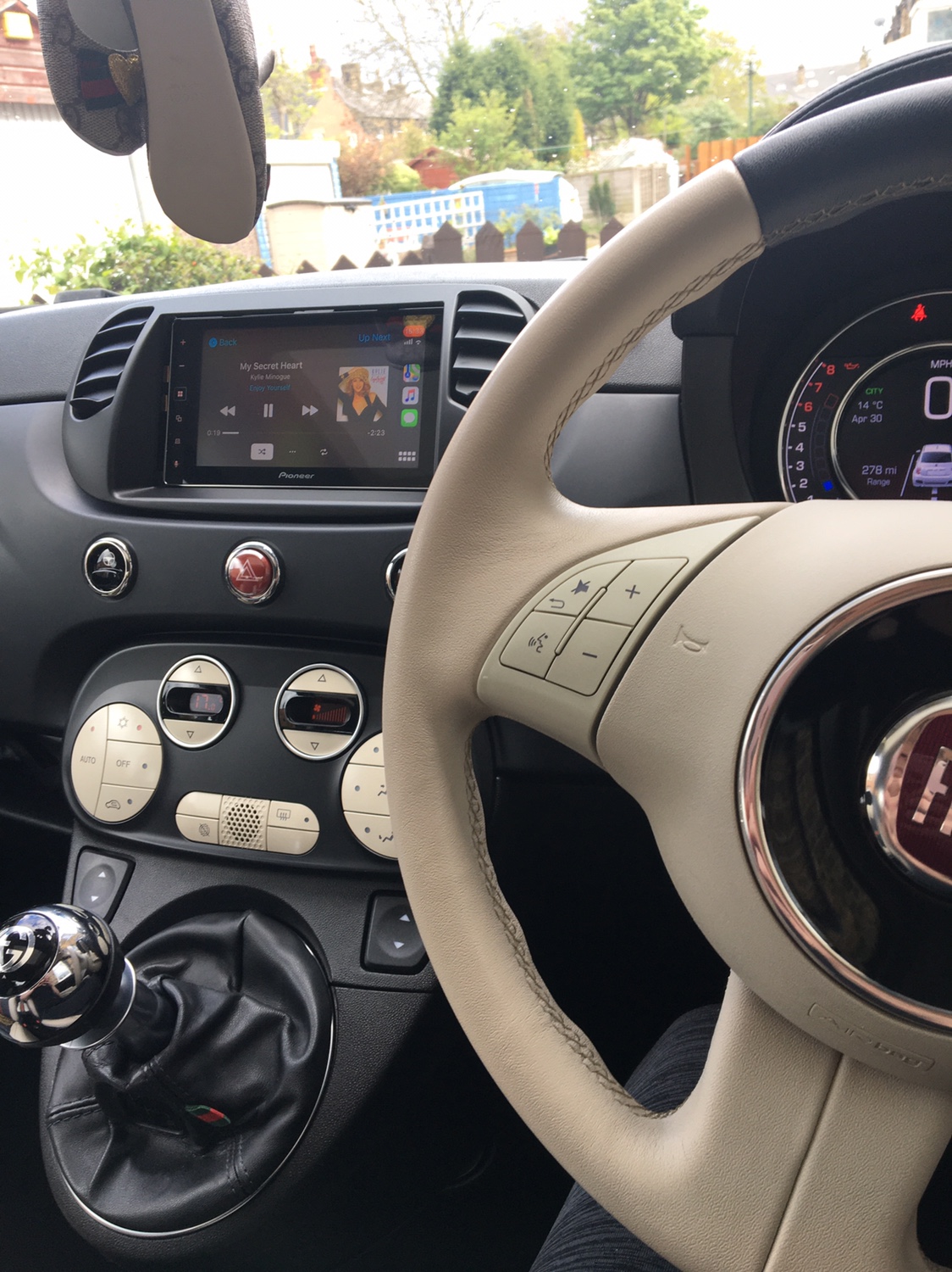

Hey I have delved into some of this myself though I decided to ditch my blue & me in favour of a pioneer double din touch screen with apple carplay
I loved the blue & me though obviously it’s a bit billy basic!
If your planning on swapping for a single din the blue & me will become obsolete this will then render your steering wheel controls useless too....
The good news is you can install a connects2 steering wheel interface.. this will enable you to retain your steering wheel controls but will only let you:

It’s a bit of work but if your confident & good at DIY like myself then your good to go! I’ve added a pic of mine so you can see what I’ve done! IMG_4182.JPG

Yeah the voice control will disappear along with seeing anything on your cluster! As obvious it’s only compatible with the original blue n me system.... which is a shame as I must admit I miss that!
But hay ho it’s much better now! My system has Siri voice control so I just shout at her if I need to make a call!
If you get a Bluetooth system it will have a mic button on the radio so you could just press that and talk....
Bear in mind if you do swap over you will need to feed a new mic into the original via the A pillar & roof lining it’s a faff but quite easy
