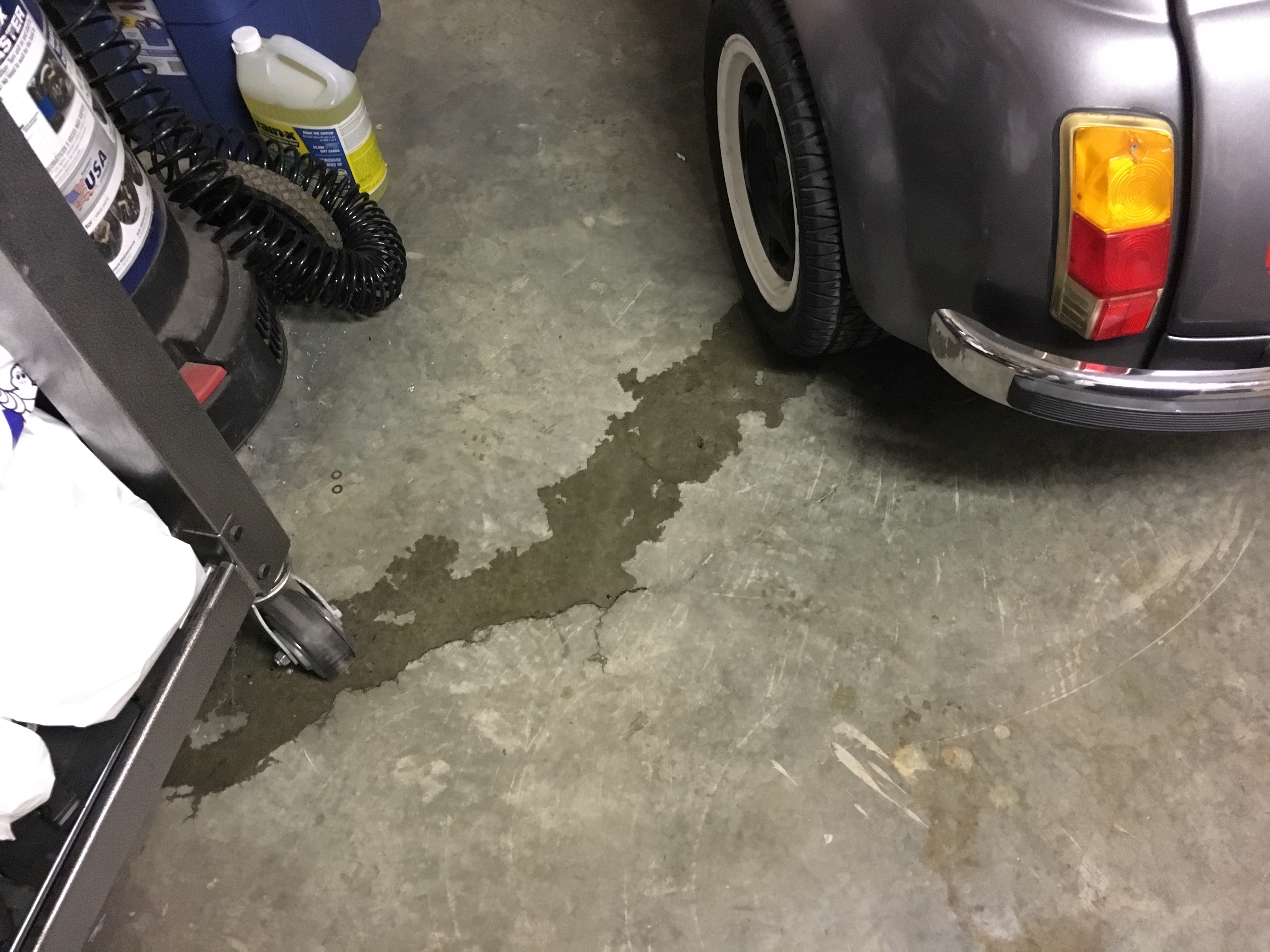

The brake cyl was also weeping...and one piston was seized...and I must of agitated it enough moving the piston reassembling everything and bleeding brakes to break whatever was left of the working piston seal because this morning I see this and the reservoir is totally empty...

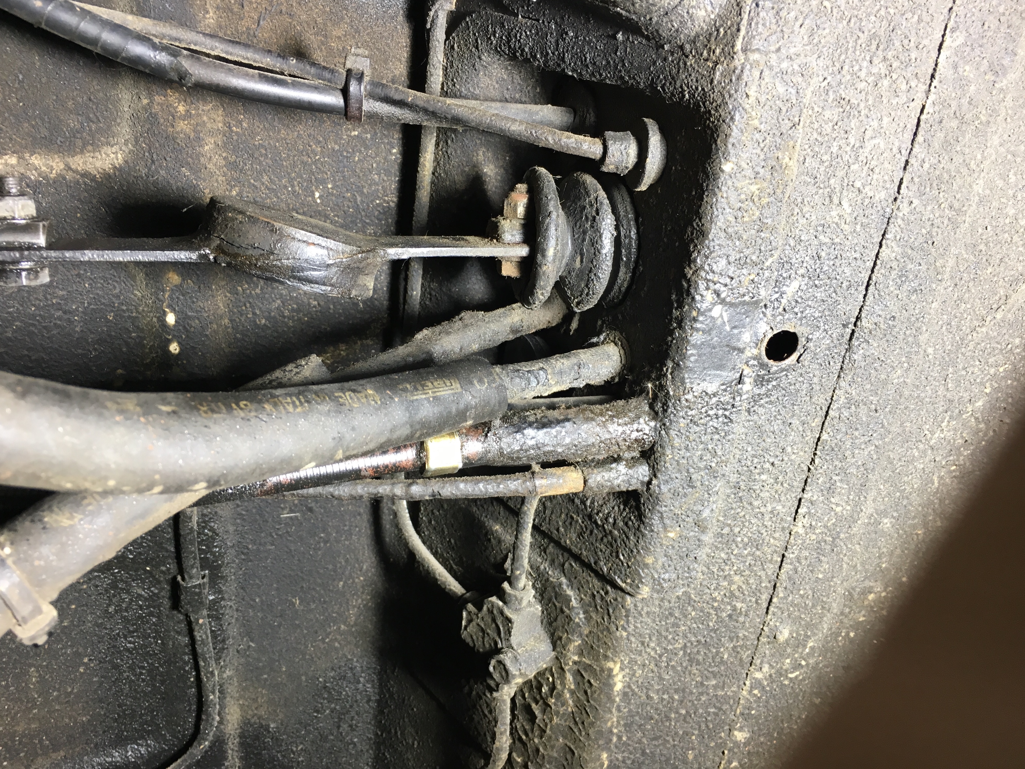

- transmission appears to be seeping from the gear elector. I can't seem to find a seal for this? Or maybe it's some more common I'm missing?
- also, in same pic below there's a missing electrical connector. Anyone know what it is?

The electrical connector is the reversing lights switch - as your car doesn't have reversing lights it's irrelevant

The connector looks like a reversing switch and it might be there just to blank a threaded hole. That part of the gearbox, at least, is therefore from a later car (126); probably the whole gearbox is.

The type you have has an "O" ring on the shaft inside the tube. You can obtain a later version which has a proper oil seal
