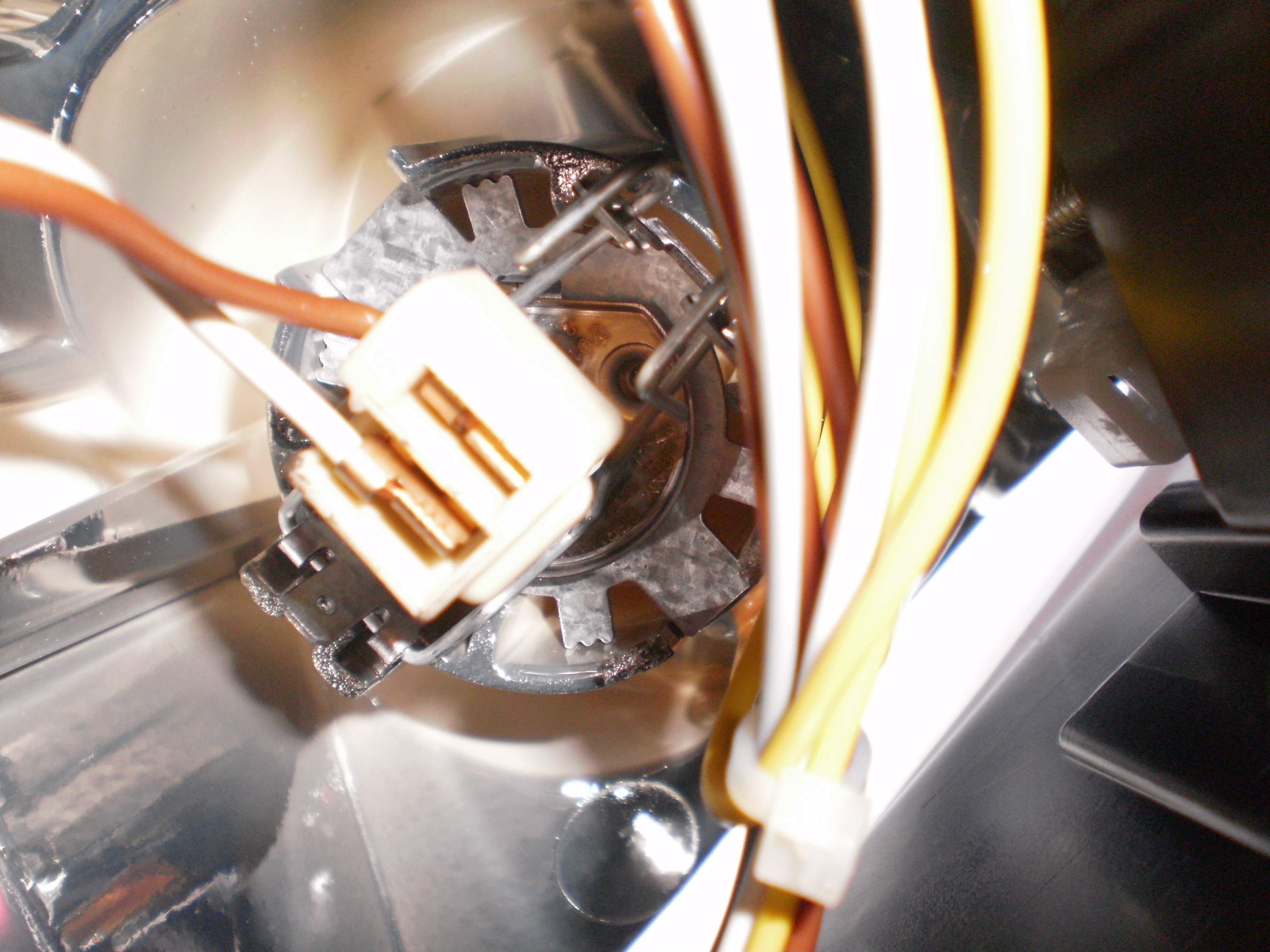

The following photographs show the driver's with the spot assembly and the passenger side without.
BikerDoc,
I have sent you a private message re the photo's as I can't seem to make them attcah properly.
Regarding the removal of the headlight assembly it looks difficult.
Photographs as above
The lamp holder which has the brown and white wires attached which is held in place with the spring. The metal support that holds the bulb in place seems to be have a push fit on the plastic of the reflector. I didn't try to remove it as it was raining and I wasn't sure I would be able to replace it easily. The bulb and the holder is what I think I need to source and then it should be possible to push fit the assembly and wire it up. This must be what happens when the units are manufactured.
