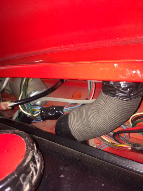

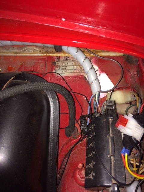

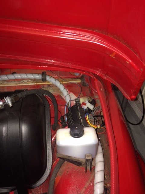

Hi all
Im a new member ( Coventry UK)- just started my rebuild of a 1970 fiat 500 L now its back from teh body shop... I took it apart 4 years ago and have lost my pics so cant work out which holes to use under the bonnet for routing pipes wires, cables etc. Would be very grateful if someone would post a picture of the under bonnet arrangement ( idealy without petrol tank) so I can proceed. I will also post some pics of my build shortly.
Thanks
Steve
Hi Steve
Here's some views, sorry the tank is in. It iOS on a RHD Fiat 500L, you might be able to work out some routing. I am in Stoney Stanton Leicestershire so when this lock down is over your more than welcome too come over and check out things on the car.
Cheers
Gary (aka Hugh Jarce) :cool:
