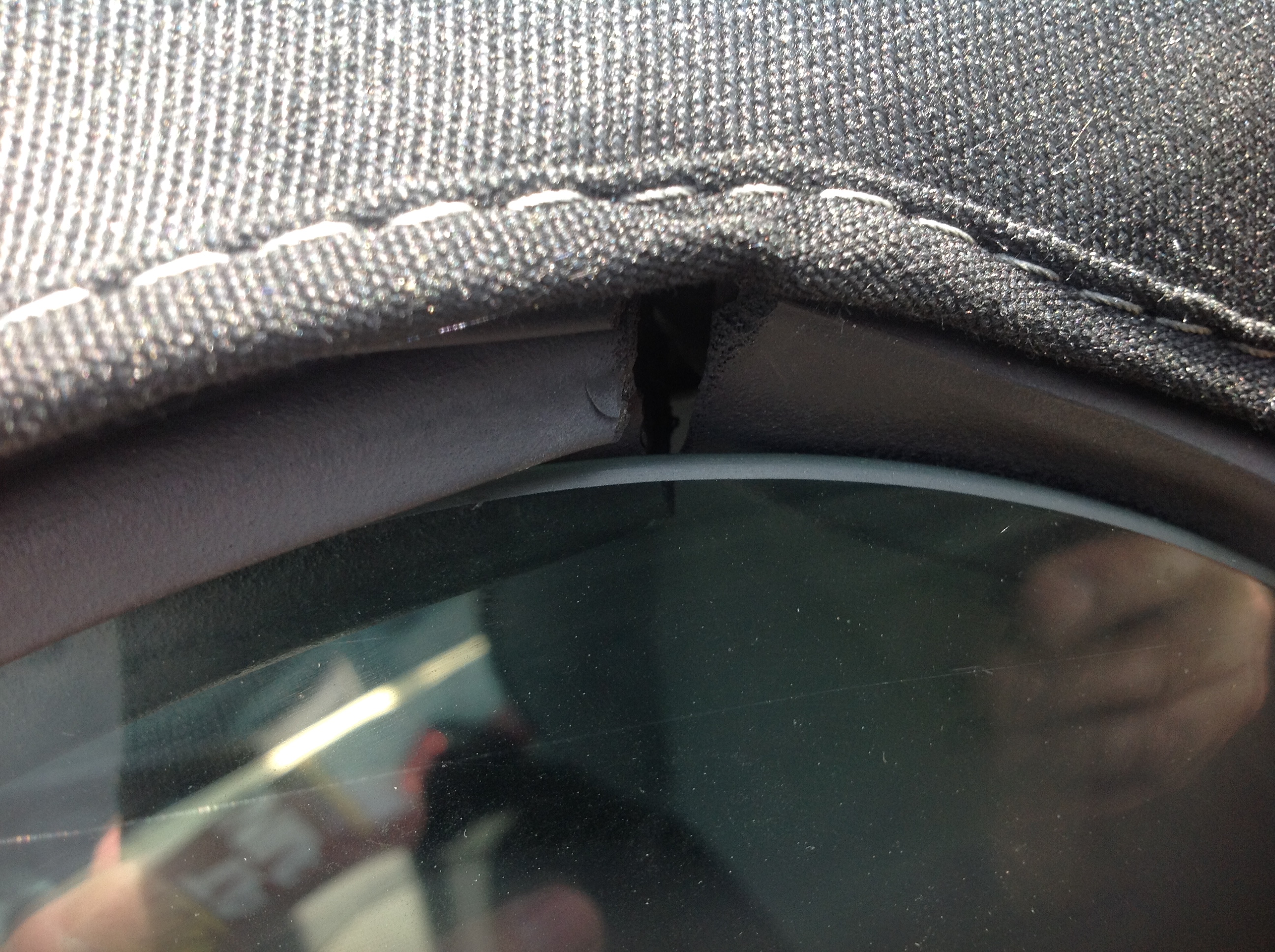

I also seem to have an approx gap of 6mm in one area between the hood and the door window (see pic) Is this normal ? Any suggestions to a 'cure' gladly accepted
