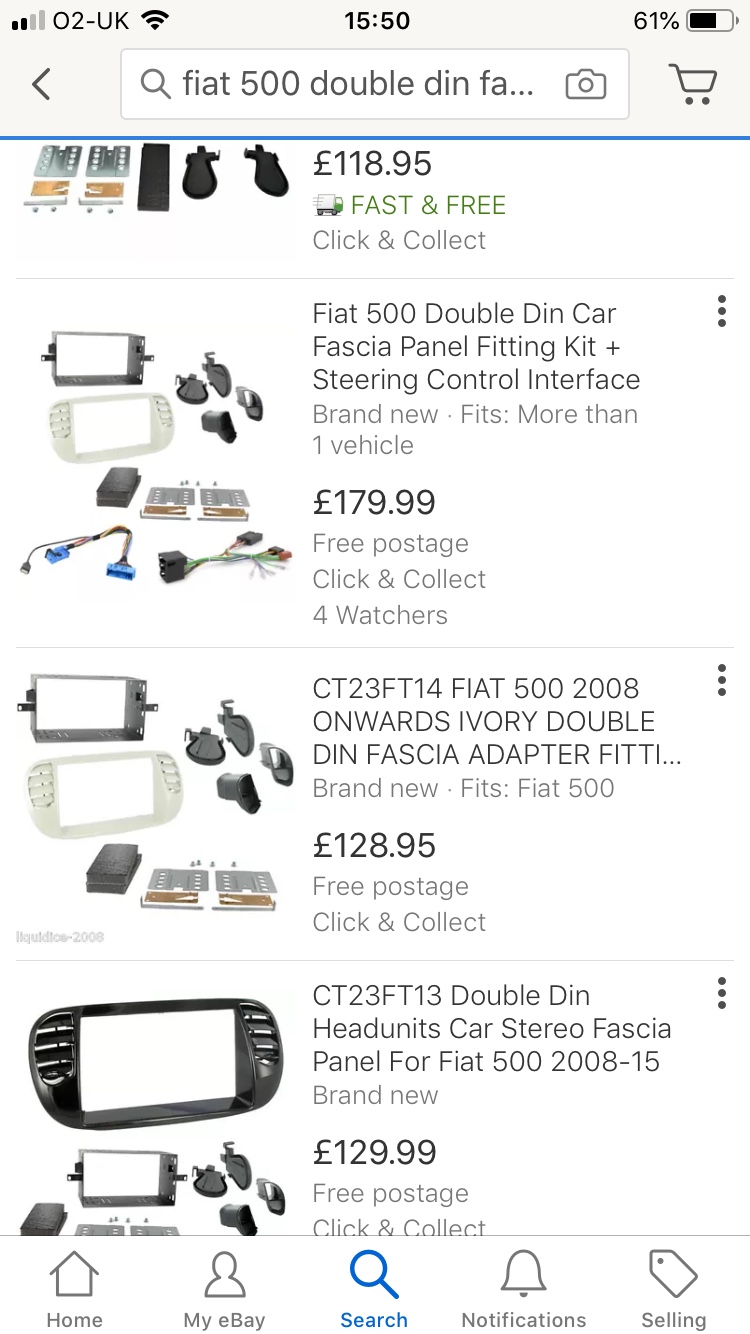

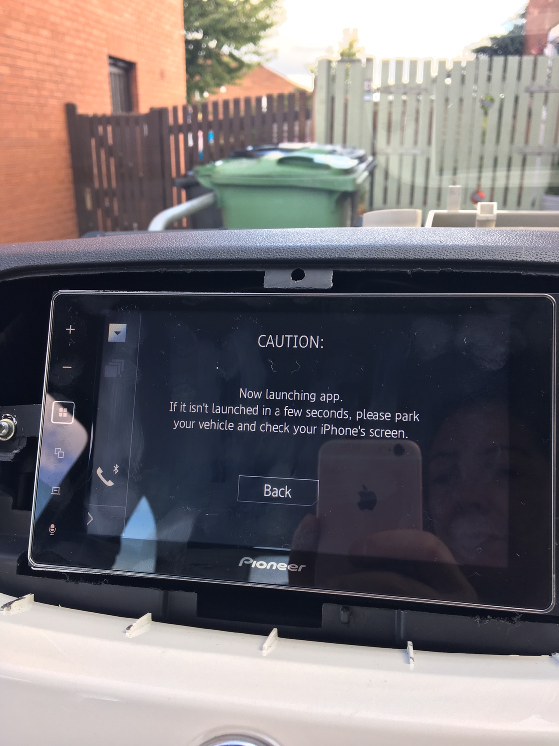

IMG_1541.JPG just a little piccy of what I have done “myself” I went for a pioneer dab/Bluetooth various places inc Halfords do kits for fiat most online only ... I got my kit on eBay .yes the vents above just pull out but there is some cutting to do to the actual vent behind to enable a double din installation it’s a bit tricky to do as not much space got plenty of bruises on my knuckles [emoji23] as for radio codes I used an online service cost me about £10 but the code worked fine
Also you can get the cables online but I’m not sure what ones as I bought a kit and they came with the facia as in pic ... if you were to go for a new double din unit it should come with a suitable cable that will plug [emoji366] into the cars existing connections for the stereo system as for the vents after I cut the plastic “tubings” behind the actual vent facia into an L shape my facia came with side caps and tubing that directs the air flow to the correct direction... hope this helps you .... I did have factory instructions that came with the kit but I did most of it following my own instinct [emoji23]

Well yeah I suppose mine is an 09 single din with air vents at the top the kit I bought enabled me to change the direction of the vents but there is some cutting to do to the vent ducts..... thus enabling double din installation!face lift models are no doubt modified for double din what I don’t like about face lift models is a lot of functionality has been moved from the speedo screen to the radio screen! So I’m not sure how it’s possible to swap out the stereo as most units won’t support the functions moved over!?! Not sure but don’t see how
