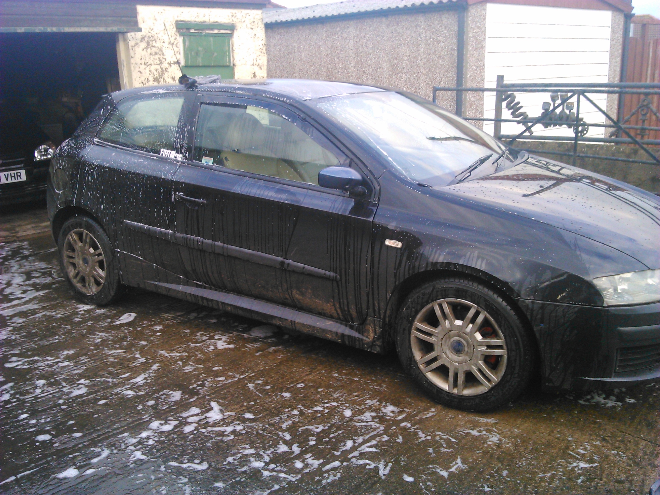

Stilo Nero the Jtd Stilo
Well since the 306 was missbehaveing , i think it ran out of cheese ...
so i got told about this Stilo for sale of a Good friend of mine and hes legend of a dad was selling it so had a test dive and said i want it if the insurance was cheep enough so a quick call and it was a massive £4 more .. so went for the car today the car will be used for my work horse (y)
pics
a little bit make me smile when im around town and people are stearing going thats nice , but then all the extra miles on her and how harsh it is on the coils and the noisy exh make it bad for going to homes ,,
BUT Nero is back alive (Y) will post pics of what was broken when i get home tonight

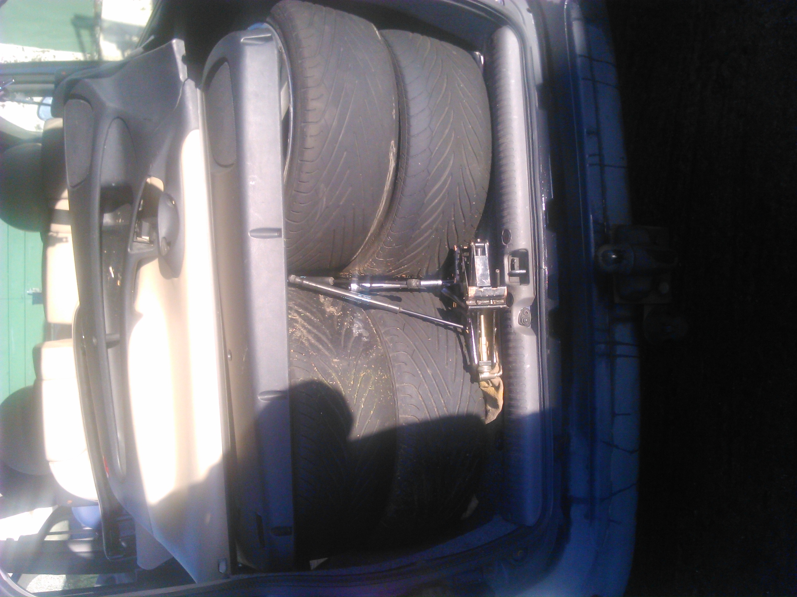

So yeah i bought

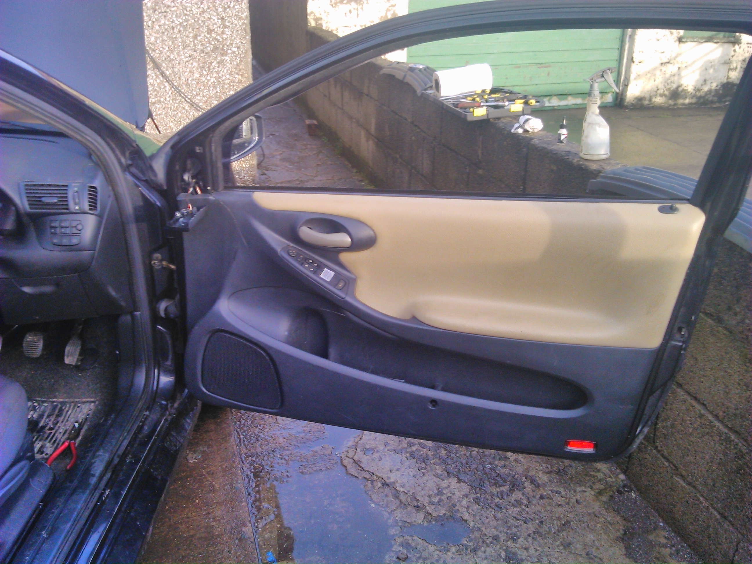

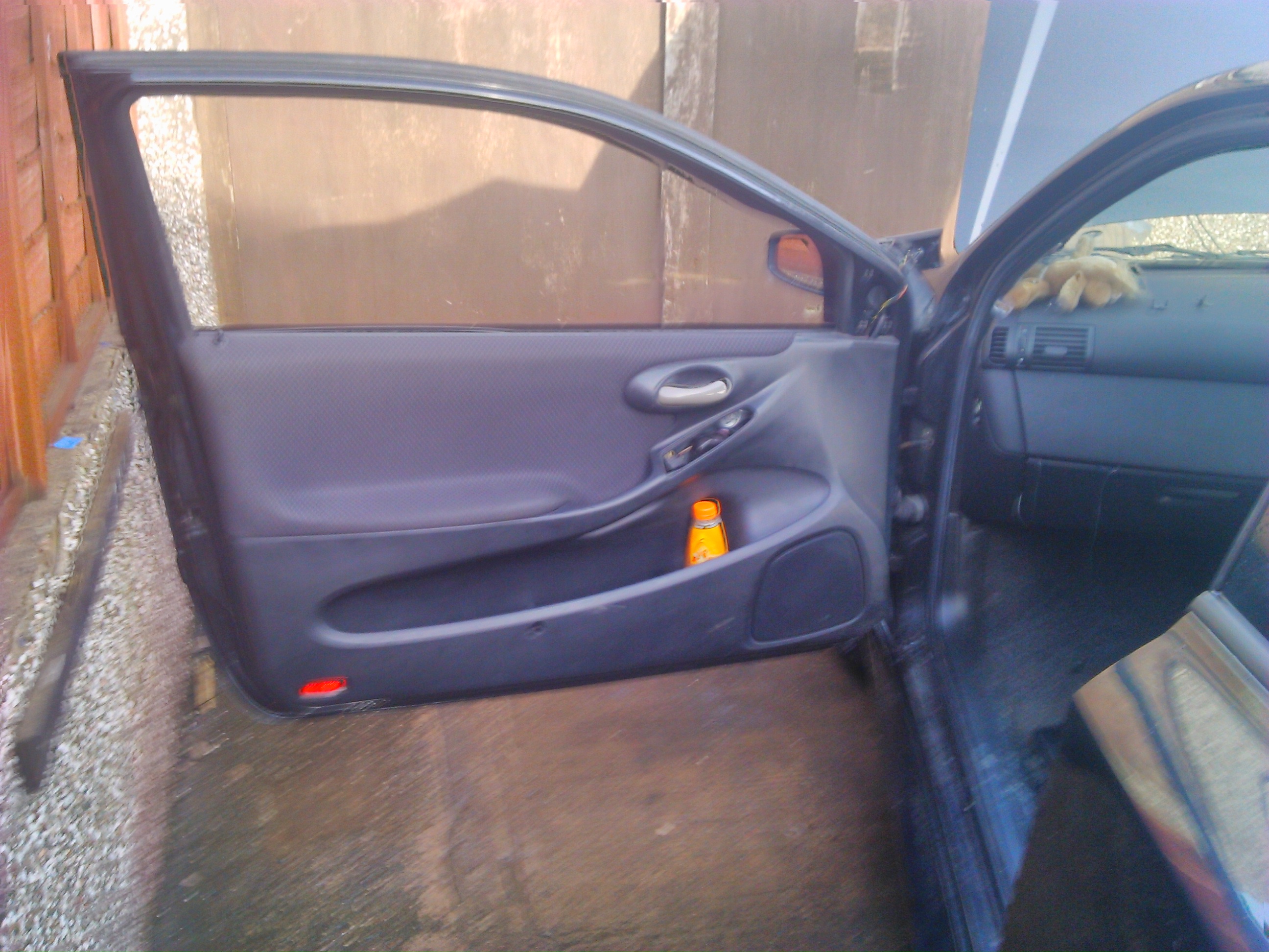

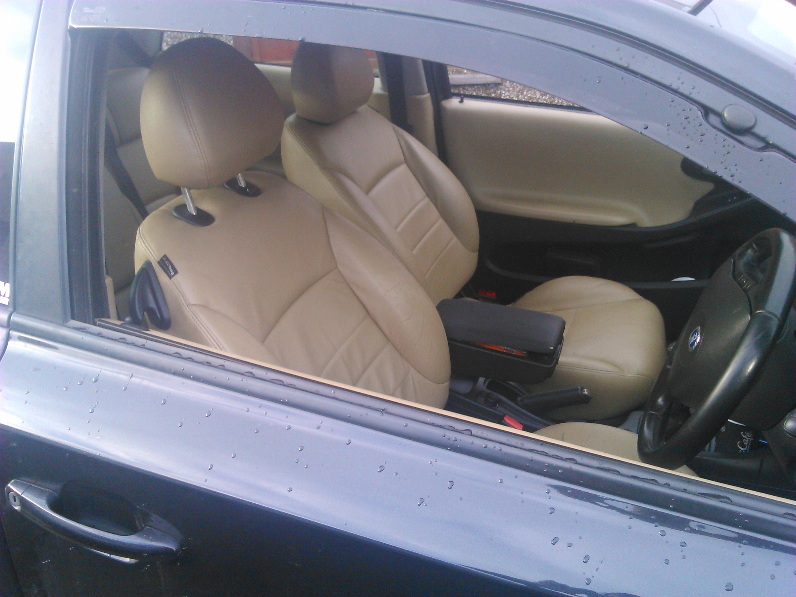

Pictures are , seats in the car
diffrance between the doorcards
And all my parts in the back of a Multipla ,,, It was a little Full :)
Leather seats + door cards
debadge grill
17" blades i need to put some rubber on two of them
So now im a happy james

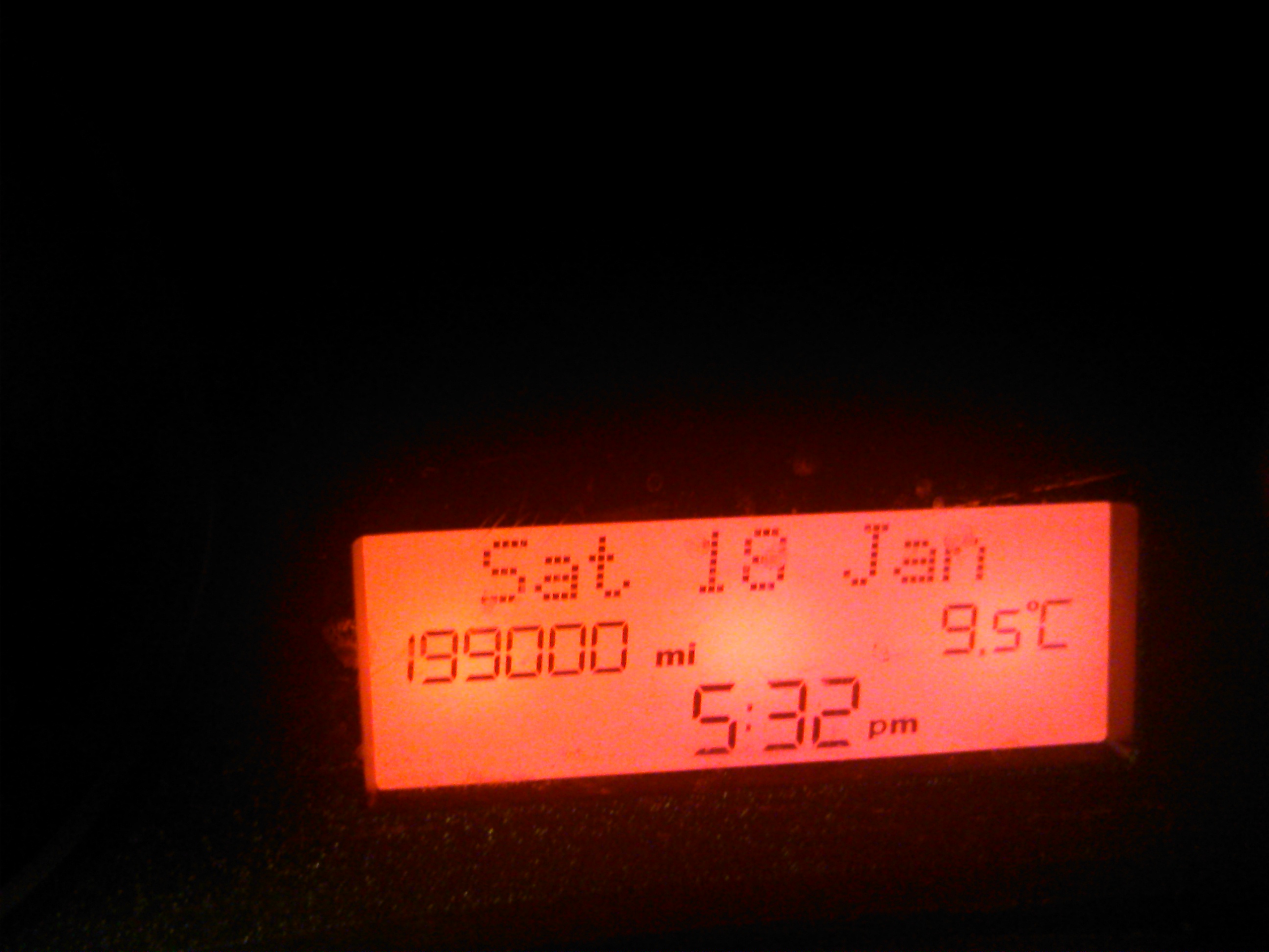

Edit .. Ps she is now on a 199k :)

hahaha James don't try hiding how close you sit to the steering wheel by adjusting the seat support right down! we can see where the seat belt plug is compaired to the other side :p
looks good though! but can I ask? you don't like the leather in your cinq because its cold or hot and sticky...and you've gone and got leather for the stilo?
Reuuk thats just after fitting the seats buddy :)
i know i complain about the leather but,,, they look good :p and now my two cars have full leather (y)

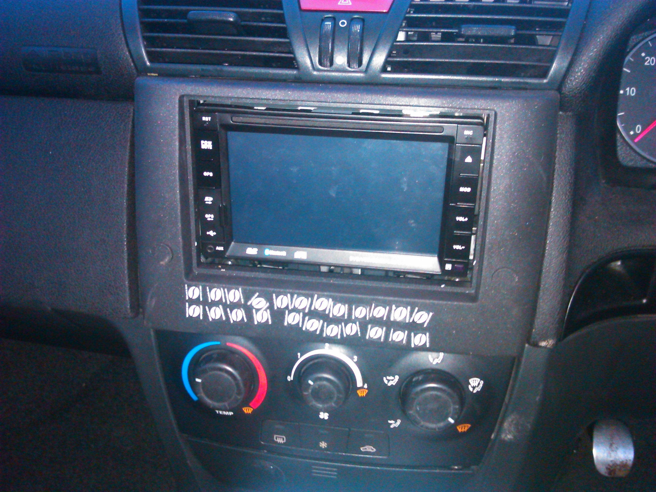

I fogot to update this , but the parts that have been fitted so far since the first pics are
Wind deflectors
Double din Sat nav thinggy ( bought it to help me at work )
Bebadge grill
cruise controll stalks
Cd changer ( and new glove box surrond)
Leather interior
gadge , im going to Refurb the Blades before putting them on , as i had just put 4 tyres on my 16"s so keep me legal , i cant wait to get them on
